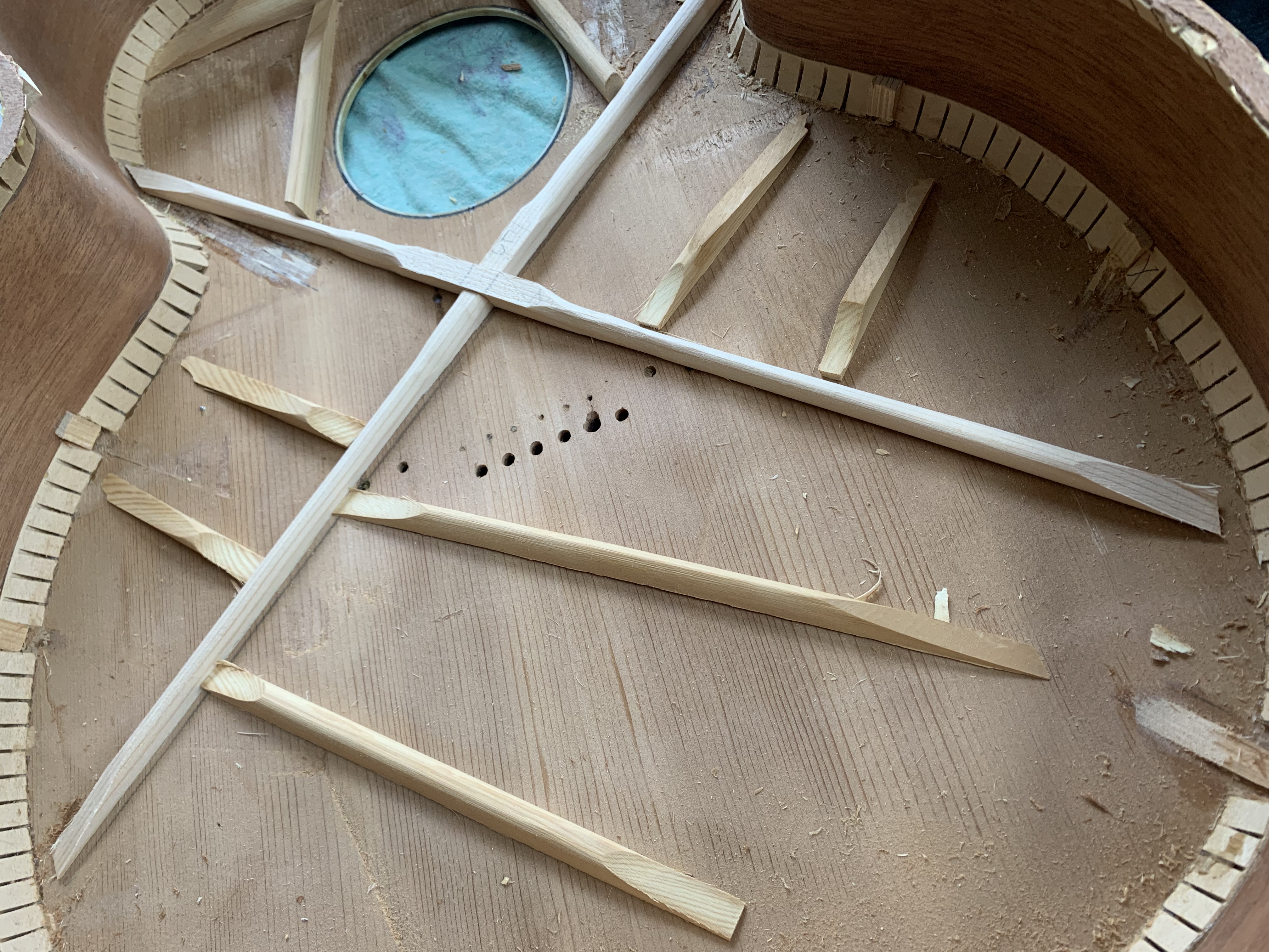

These haven’t been shaped yet, just wondering about height, width, and placement
Posts: 3251
Re: Replace old ply back with solid wood?
How tall are they? The placement of the braces looks pretty good but I recommend the following modifications: I would have the two tone bars extend a little further, but not all the way to the kerfing. Also I would taper the ends of the tone bars and the finger braces where they contact the X-braces. You don't normally want them full height there because that will make for a stiff top. Even the two braces near the sound hole should be tapered on the lower ends and they should also be a little further away from the sound hole (like no closer than 1/4 to 5/16"). The tone bars look a little tall

Ok, how’s this?
My x-braces are 7/16 wide and 7/16 tall, I shaped. The tone bars and fingers are 1/4x1/4, shaped.

Shaped a bit. 1/4” wide, except for the joint. There it is a bit wider and left flat on top

And these guys…
Posts: 3251
I would use a small finger plane and make some long tapers on just the lower legs of the X-braces and the tone bars. There is still a little excess meat there. And the finger braces are still a bit meaty too as well as the sound hole braces. Also don't forget to move the sound hole braces back away from the hole.
I assume your X-braces are 5/16" wide, not 7/16", which should be fine.

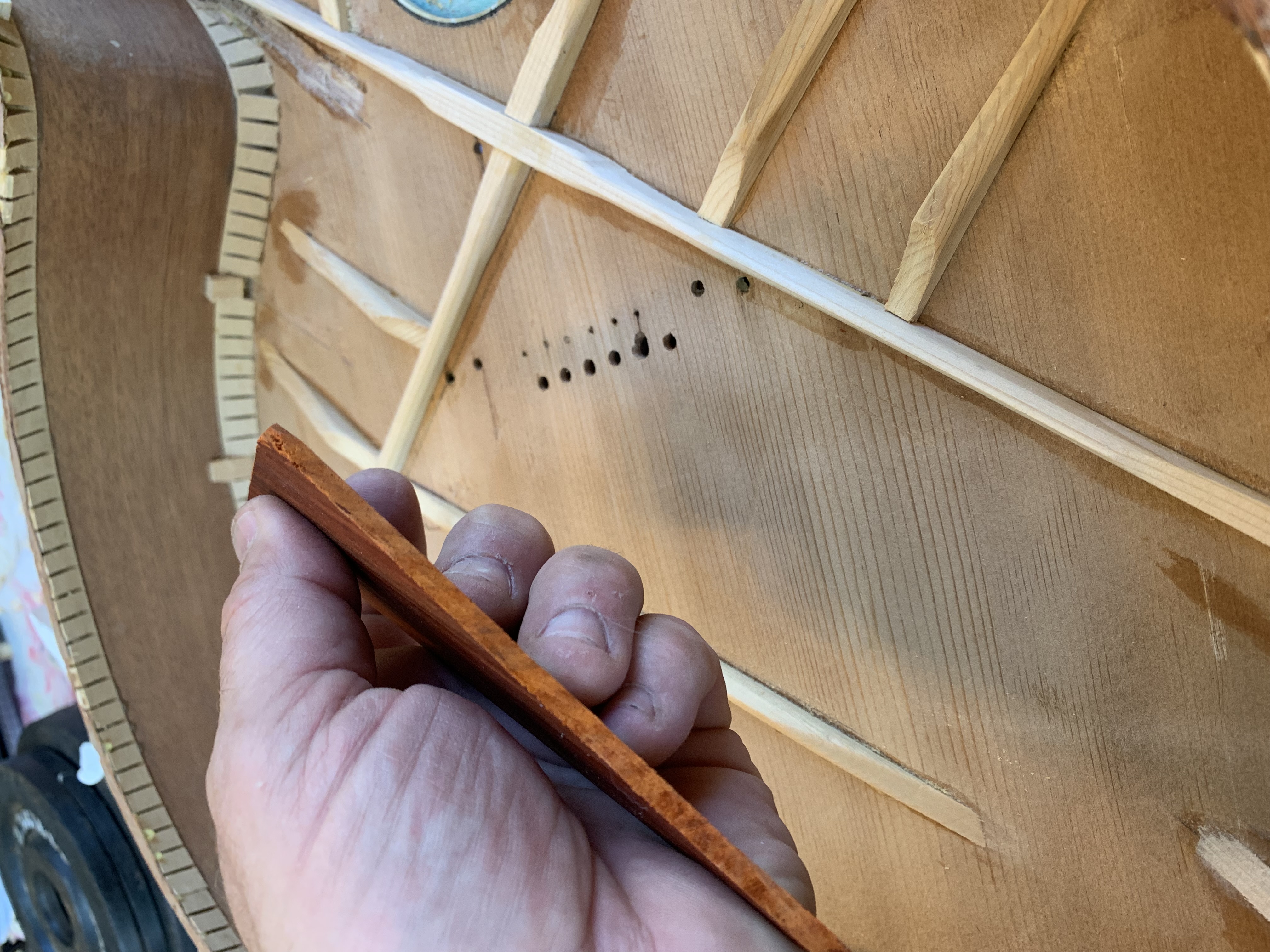

Latest. Glue down the bridge plate and then the back? Or is there more to do here?
Here’s a picture of the plate for thickness reference. It is 1/8” pauduk
Posts: 3251
Too thick. More like 0.090". Also cut off the tip that runs up to the X-brace intersection. I take it back to where it is about 1/4" above the top edge of the bridge.

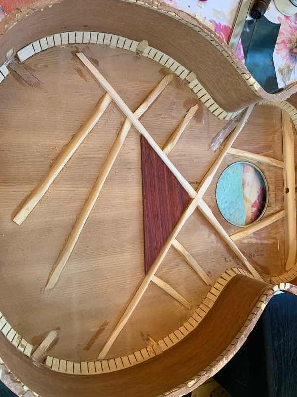

The pen is the line of the strings. Thickness is .090”. Removed tip to 1/4” past bridge. Bracing look ok?
Alan Carruth
Posts: 1309
Post by Alan Carruth »
You could taper the front and back edges down: the only part that has to be full thickness is where the ball ends of the strings are. I like to have both the front and back edges of the bridge plate out past the edges of the bridge, but tapered out as thin as I can get them to minimize stress risers. I normally glue the bridge plate down before the braces, which makes tapering the edges easy to do.
