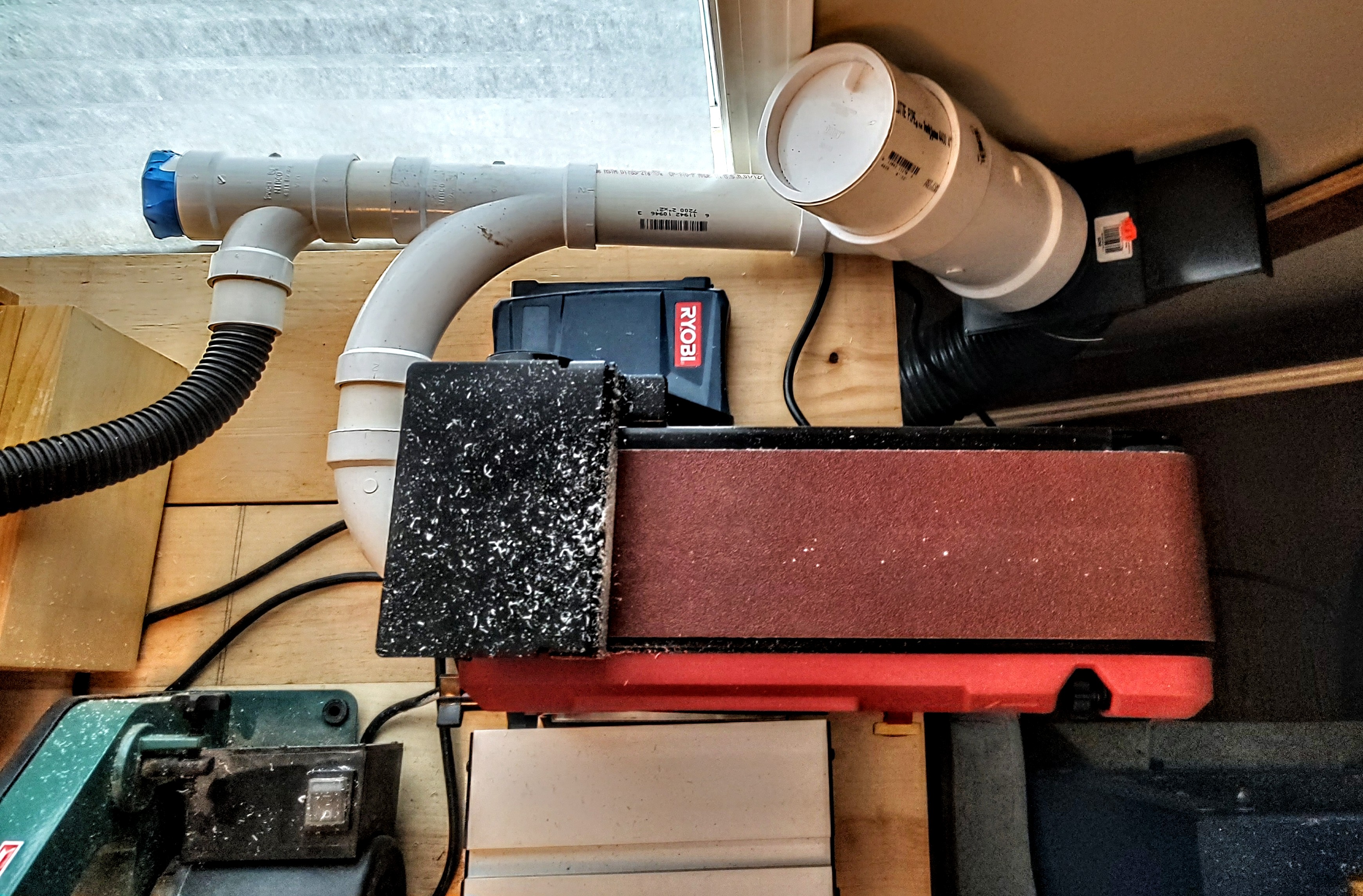

I have a micro-woodshop (11'x11') after vanquishing a bedroom in our apartment. I'm using shop vacs for collection, and a hot air furnace filter attached to a box fan for air circulation. The box fan seems surprisingly effective, at least by looking at the filter. The sop vacs are great, but they tend to clean up after the fact. So I started fooling with PVC plumbing fixtures. They can be persuaded to fit shop vac fittings by applying heat from a heat gun, and a little patience. The heavy plastic fixture ends will soften and stretch sufficiently to make a connection. Not pro grade, but way better than nothing. In these pics the sander ports connect with a 2" pipe that then connects with my [General Int'l] vacuum's 4" hose. Somewhat less expensive than buying dust fittings, but the real benefit for me is that, without a woodworker's store nearby, I can bop down to the local box store and pick up whatever I need.
