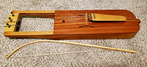

If this works, it will be a photo of my first effort.
The instrument is a bit short at 19.5". The bridge ends up low enough my bow brushes my left thigh when I play.
The bow is rather short, too, so long notes are a problem. My teacher suggests that a new bow be the first thing I make for upgrading!
And the hand hole allows access only to the E string, not the center string. Which is fine for now, but will hold me back from some potential with future playing.
I'll be trying to correct all of these things when I build my next.
-Patrick
