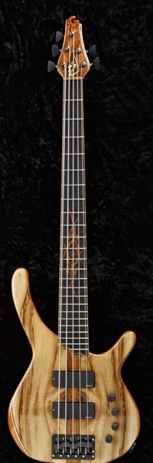

Hi all first time on the new forum hope this works. This is my seventh bass a 5 string with a myrtle front and back. I used ebony for the fret board and simplified the inlay.

Front view

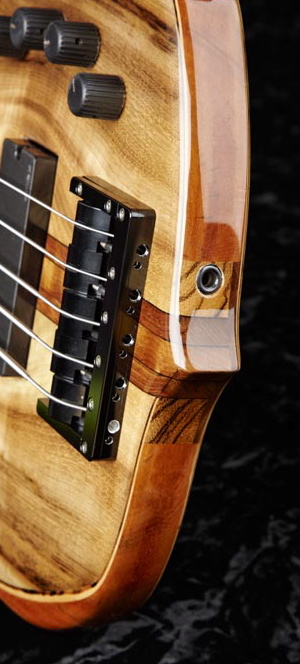

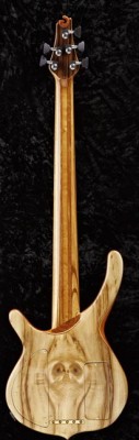

The back view both the front and the back are myrtle.

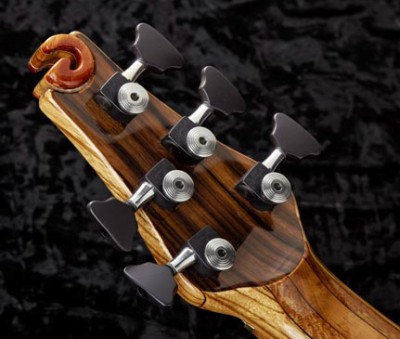

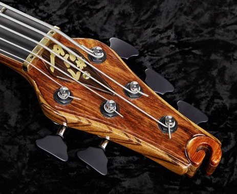

A close up of the head stock which is faced with chechen.

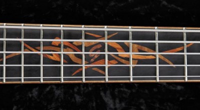

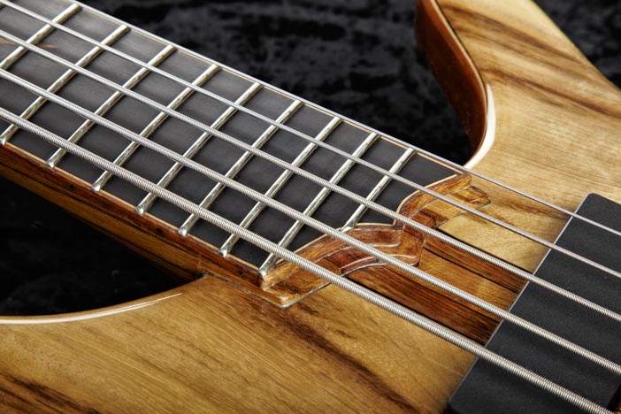

And a closer view of the inlay which was done in honduran rosewood, baked maple and balayoung.

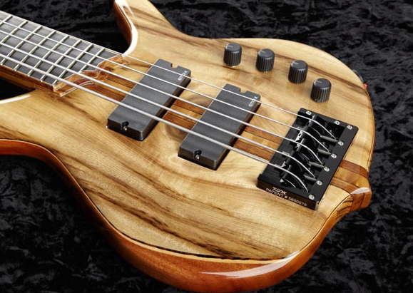

I also switched bridges to a KSM bridge the sound is a lot cleaner. After comparing this bass to an alembic the sounds of the two where almost identical tonally with my bass being a little more powerful (louder).

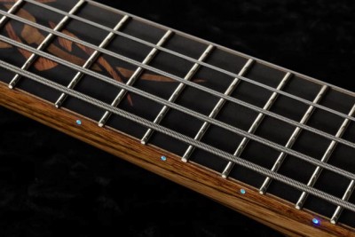

The fretboard is ebony lined with maple and chechen, this was my first time doing that. I really like the subtle effect it offers and proved to be fairly easy. I do have to change the point by the G string and round that off a bit as it catches your finger when slapping, whoops.

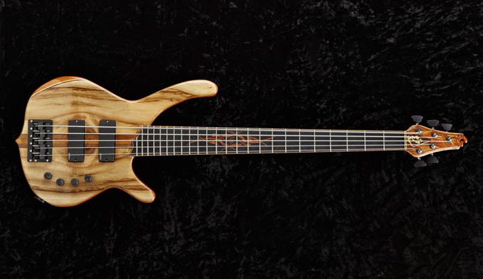

I rotated the front view and hopefully a little better view of the whole front. I also want to thank Jim for letting me know that the picture problem was not me (as I assumed LOL). A couple of other things the pickups are EMG's, tuners are sperzal and I inlaid the strap locks for a cleaner look. In the future I hope to get a sound clip of this bass as this thing sounds better than it looks. The first time I played it my band mates where amazed that a different bass could be so unique in its sound. I also had to adjust the volume and gain to about half of what my other bass is played at.
