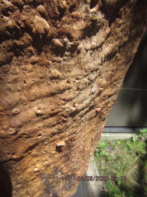

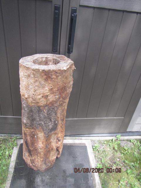

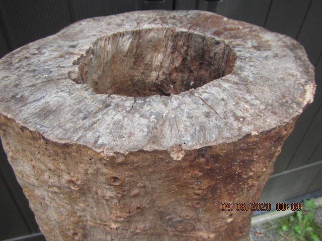

I received a query from someone I don’t know to ask if I could make a guitar from a chunk of maple. Turns out the “chunk” is actually a hollow log that was harvested from a tree on his parents farm roughly 20 years ago. He says the wood has amazing quilt and Birdseye figure. Also, he says, bugs have bored some tiny holes in the wood. He sent me the pics below. As for scale, the log is apparently about 4-5 ft long and 20(ish) inches across. I’m no expert on logs so not sure how he can tell what kind of figure the wood has. Told him I’m not equipped to mill a log but I may know someone who could mill it into usable lumber. So question to anyone with relevant experience...is the lumber from a 20 year old log usable or would it need to be left to dry first?

I know some folks who would love that wood; it's highly figured and spalted. It would make some nice turnings, or jewel boxes, and, of course, any number of sound hole rings. I would not even try to make a guitar out of it. It's really too bad that it was not processed right away when it was cut. That's one of those things you just can't put off, particularly with maple.

That is small enough to cut up on bandsaw. You would split with ax or chainsaw first and go for it.I don't think age is an issue.
Scale is difficult but I don't see a guitar in there. Lots of figure showing.
Drum is a natural.

My take is that the wood in that log is perfectly fine. You don't need quarter-sawn maple to built out of, you could rough it with a chain saw, if you could get pieces that are 8" - 10" wide you could make a traditional archtop back and sides set out of it. I've built with maple from trees that fell down, I've built from birds-eye maple that was harvested 50 years ago and simply rough slabbed and left in a barn. In fact, if you squint, it kind of looks like a hollow body Jazzmaster (no F-holes though)... :)

A log doesn't get hollow without undergoing extensive rotting. The remaining wood will be spalted, which may be nice. So this wood might be suitable for a slab-sawn drop top, but a hollow body archtop? No way.

The discoloration from the spalting is obvious in the end grain shot. Maple is only a little more resistant to this than birch, of which Frost said:
"Two good storms and a rainy day will rot the best birch fence a man can build".
Spalting is caused by fungus, of which there are a number of sorts. One that s hows up early often seems to feed on sugars in the wood, rather than actually breaking the wood structure down. It leaves behind a somewhat discolored wood with black 'ink lines' that is not too much weaker then properly dried wood, but I would not trust it structrually. The later colonizers are the ones that really do the damage.
If that log is around 20" in diameter then a quartered piece of wood from it would be around 5" wide. You might just get the back for a viola or maybe an arch back mando out of it, and could probably make a fiddle, or some ukes if it's sound enough, but I really doubt it. An archtop is not in the cards. You might get something larger using a flat cut piece, but, again, I really doubt it's in good enough shape.
Be aware that spores and possible toxins of the various fungi can be released when you work such wood.
