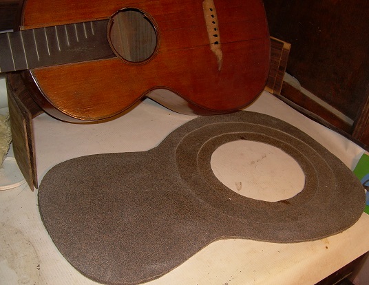

Daniel Friederich used a mold and solera combination I believe, and I have done something similar on occasion. Since I use the same "flat" workboard for a number of different designs (steel and nylon) I make removable pieces to give the required doming. I use some free rubberized gasket material my brother gave me, but cardboard might work as well. It allows me to add forward angle for classicals and for steel strings I can elevate the end of the neck to add back angle.

What Clay shows is quite similar to what Cumpliano has with cork tile but a bit more refined. "Built-up" workboards are a common enough method. The important thing about the dome and neck angle is just that you get a system that works. The more precision and understanding at the initial phases, the less work to adjust the geometry later by manipulating the fretboard. Making a mold that fits your existing work board would be an option too. The Hauser (1937) varies a bit from Torres style in having a somewhat thicker sound board in the centre but with lower fan braces and of course a bridge plate. I suppose the top is overall a bit stiffer but how much is a question I have no idea about. Both styles work.

Yes, the built up solera has been working for me. I still plane the arches for the top and back dome into the braces. I simply swap out the cork shims for the 2 steel strings and 2 nylon string guitars I build. I could use everything, including the Torres side bending form, as is and make adjustments. So far, it's all been in the fingerboard taper. I guess I'm building a Cumpiano classical guitar with Torres features. I'll make a drawing. That always helps.

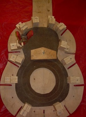

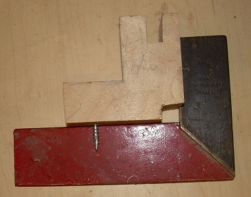

I use 'inserts' like Clay, but I have multiple adjustable L shaped brackets that I can change to the shape that I'm building (much like Mega-mold) for the sides. I made two of these with double thick 18mm birch-ply and they should last more than my lifetime (I hope, lol)
For the top doming, there is some debate. Arching the lower harmonic bar, arching the fan braces, using a carved-out workboard and clamping on flat fan braces and even building 'flat' and arching the bottom of the bridge to give the dome you want when the bridge is clamped to the top.

Although I developed my methods independently from Pablo, we use tools that are surprisingly similar (mine are a bit less refined in construction) In addition to the solid side molds I use movable " L brackets" for some instruments. They are made differently than Pablo's and I just screw them down rather than use bolts. I notch them to take spring clamps. The bracket design I adapted from working with Corian products, but it works well for guitar making. Sometimes you want to make alterations to a design and the brackets allow you to do that.
