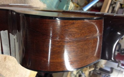

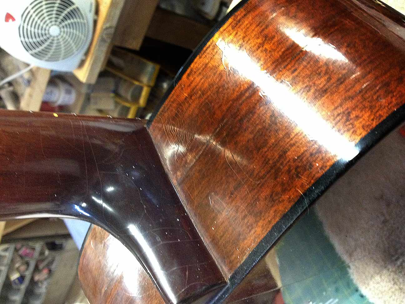

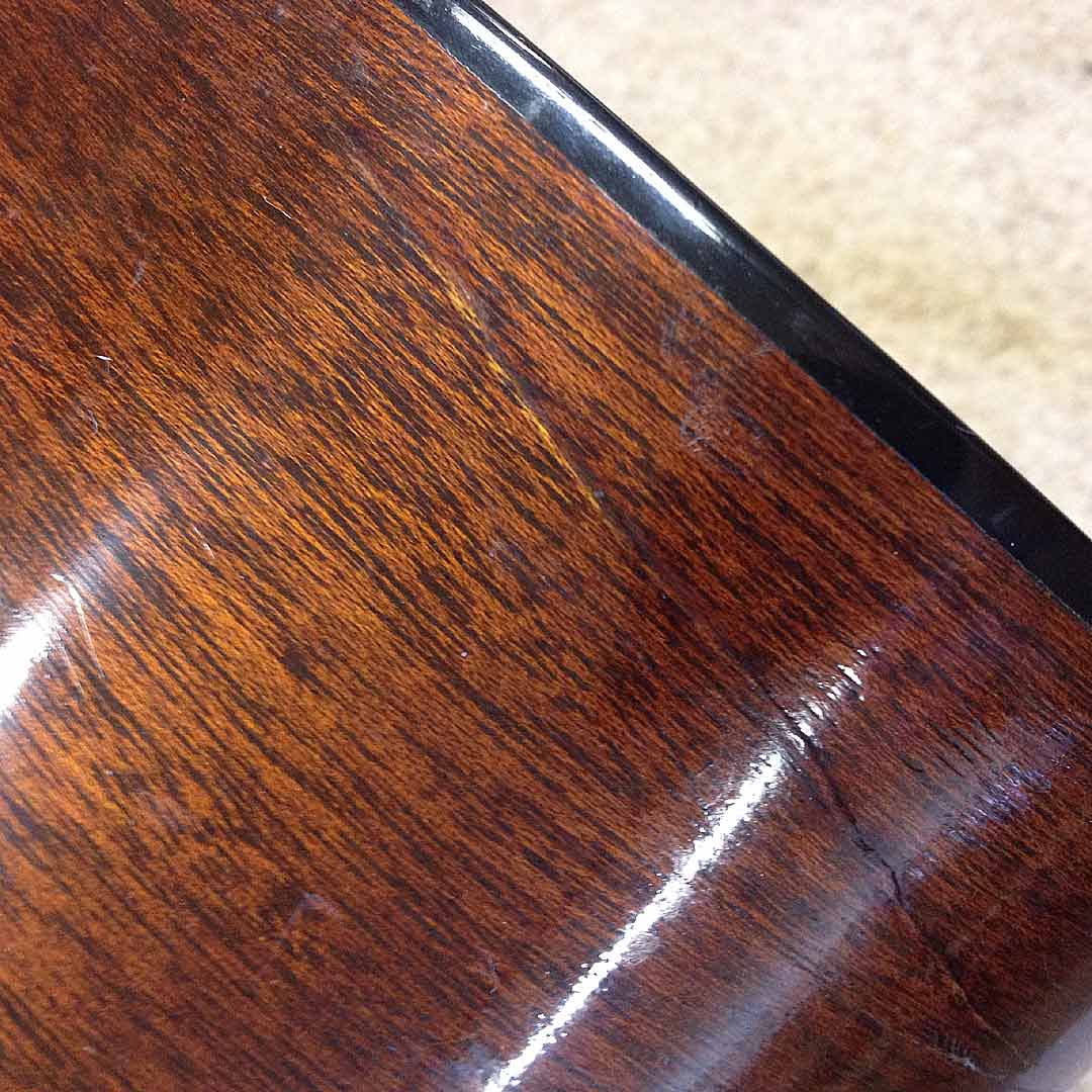

I've dealt with some top cracks, peeling pick guard, and missing binding. The major problem is that it is close to needing a neck reset, and has had a huge catastrophic upper bout side crack, with prior repair, from one side to the other and running underneath the heel's attachment to the body. It has been glued and cleated in the past, but I don't see any damage to the heel, the heel block (has the original with serial #), the fret board or the guitar back. I'm at a loss to explain how this happened. The bridge is only 1/4" thick (I'd guess it's been shaved) and the saddle only 1/16" tall, giving a string height of 5/16" over the top. A straightedge on top of the fret board hits the bridge 3/16" from the guitar top. No way to lower the action anymore here. It was strung with an extra ball end on each string, I presume because the bridge was shaved and the string windings come up too high out of the pin hole now. Without knowing the actual damage and how it was repaired, I'm not going to attempt a neck reset, since I've never done one before even on a straightforward undamaged guitar. If this were a cheap guitar I'd saw off the heel and make it a bolt on, but would hate to do that on this semi-vintage one. It's still playable with a high E action of about 2.5mm at the 12th fret.
Any suggestions on how the damage was done and how it was repaired?
