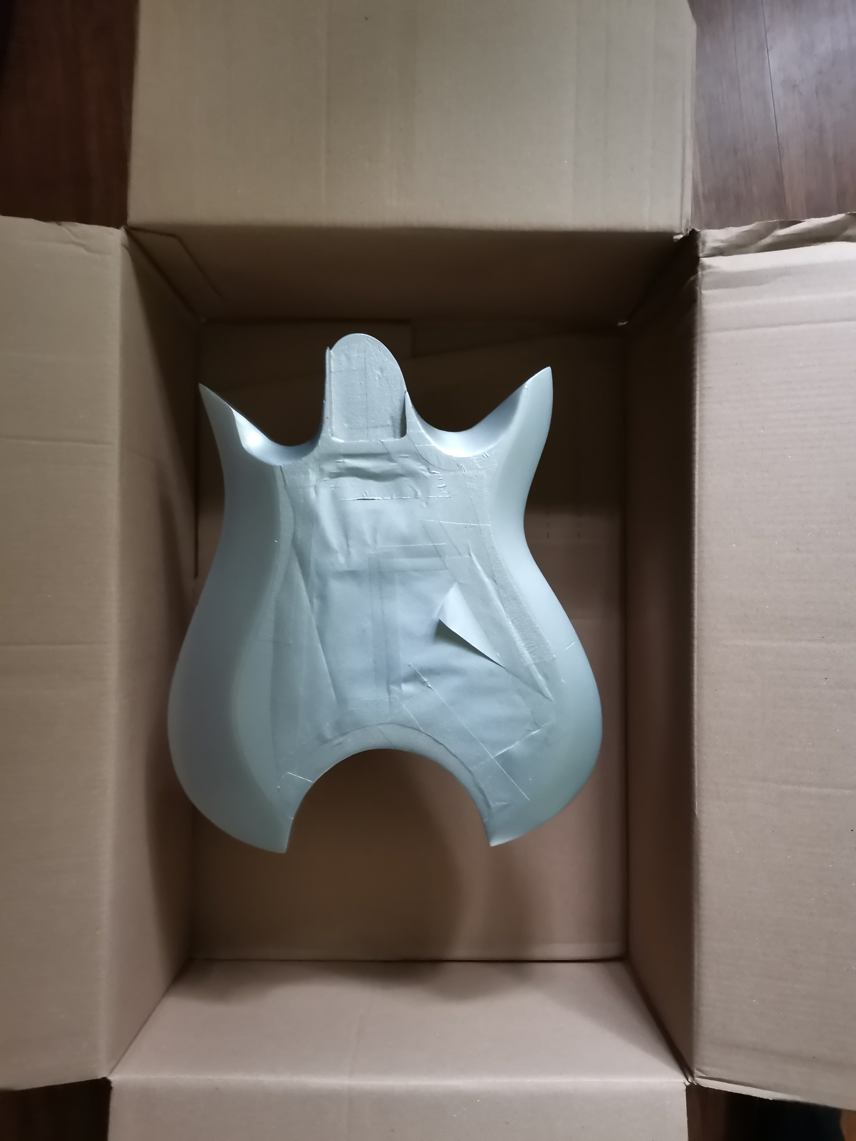

The reason i am posting here today to inquire your knowledge is because i am working on a second guitar, previously a Cort X2 (my first electric guitar) that i abandoned for years until it got rusty and the electronic stopped working.
I redesigned the shape to something more original, sanded the paint and applied a new one, varnished it and it's now ready to be wired.

You can find a picture of "Leaf" and some of the work i'm doing on my new guitar in the attachment :)

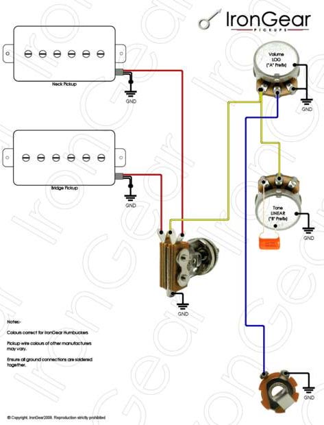

You could start with something like this. I don't have any experience with p90's (only single coil and humbuckers) - are yours 2 or 4 wire, and is your switch a Gibson toggle type? 300k pots and the 0.047uF cap should be fine.

Hello and thank you for the reply !
It's the original switch from my old guitar it has 3 positions but 8 wiring pads.
The p90s are double wired if i am not mistaking.
This scheme looks more understandable to me ! Thank you !
I have a question about the ground, is the jack output considered as the ground? Or is it the wire that was previously soldered on the bridge?
Or is it something else i am missing ?
Thank you, i really appreciate your help !
Posts: 1324
Re: Seeking wiring guidance
Does your switch look like this https://cdn11.bigcommerce.com/s-fxdzp2u ... 91.jpg?c=2
or like this https://media.musiciansfriend.com/is/im ... 00x500.jpg
The grounds are all connected to each other, and are connected to the amplifier ground through the sleeve of the jack (not the tip - that's the signal output). The ground wires of the pickups, the wire from the bridge, the 3rd lug of the volume pot and the capacitor are all connected to ground.
If your pickups are 2 wire, you can just use a standard telecaster diagram, depending on the type of switch you have.
https://i.pinimg.com/originals/27/19/bb ... 8698a8.jpg
Here's connections for the inline import switch :
This all may be confusing - feel free to ask questions.
Post by Johan Van Zalen »
Hello Peter,
Thank you for those very precious information !
My switch looks like the first link you've sent and the Inline import switch connection diagram.
Therefor i believe the last picture included in your answer is fitting my needs.
