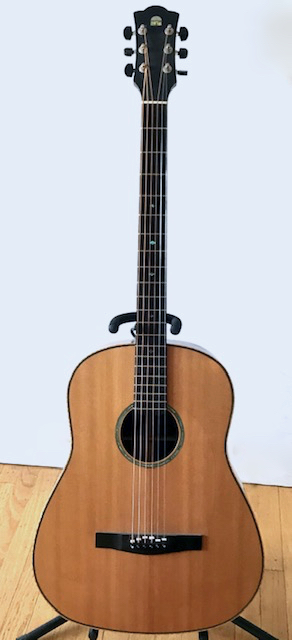

For a baritone you may well want to go with a smaller sound hole, to drop the 'air' pitch in line with the lower tuning. I've got a baritone that a customer gave back to me when he was no longer able to play it. He knew that it is one on my favorite guitars, so now I actually have one of my own to play! It's a 16" small Jumbo, 4-1/2" deep, with a 3-3/4" sound hole. The main air resonance is at about 84 Hz, between E and F, which, since this is normally tuned to D, is at the third fret on the low string. The loss in power from the small hole is not really a problem, and the timbre in the low range is full.
Re: Sound hole placement...
Darren, I have been following your and Alan's posts with interest. I built a D sized baritone with a 28 1/4" scale, and made the soundhole 3 7/8". I can't tell you if it would be better with a larger or smaller soundhole, however. After building this one, I guessed that if I built 8 or 10 more, varying the parameters a little bit, I might actually know something. If I had a team of elves poised to execute all my projects, I'd set them to it, but as a hobbyist builder, and a slow one at that, I'm not set up to develop numerous prototypes.
When I read "I know that when tuning a port on a speaker box. You pull the tube out until you're happy with the sound, and cut it there,'" I imagined Neville Thiele spinning in his grave.
Yet in instrument building there's nothing wrong with experimenting and using your ear to guide you. A guitar soundhole with a tube behind it is the equivalent of a ducted port in a loudspeaker. Since you seem to have a bit of a yen for experimenting, you might consider adding a duct to your guitar's soundhole. If you search the Internet for "tornavoz" you can find out how this has been done previously. For example, https://www.classicalguitardelcamp.com/ ... hp?t=67245. I have experimented with temporarily taping thin cardboard tubes behind soundholes and confirmed it affects the sound of the bass. Further investigations were precluded by the elf shortage.
One other thing about baritone design--with a scale as long as 30" you probably are not going to be able to compensate the strings by carving a slanted 1/8" saddle, so you may want to consider alternatives, and do some checks with a mock-up, before you construct your bridge.

Wow, thanks guys! I didn't expect so much info/tips, but am happy to get them. The elf shortage is due, I'm sure, to covid. The ported sound hole sounds intriguing. At the end of this one I may look into it. It sounds REALLY intriguing!
This baritone is a little over 16" at the lower bout, and a bit thicker than Alan's, so there is my starting point. I know compensation is going to be tricky. I see what you did and I like it. Looks like something I may try!
