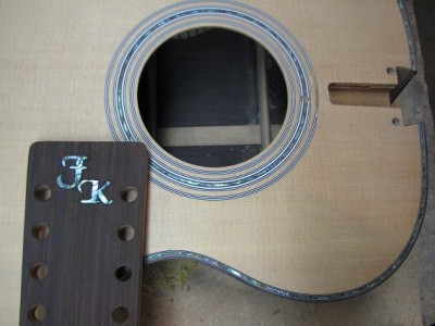

Here is an old guitar with a bit of shellac on the top before and after binding
