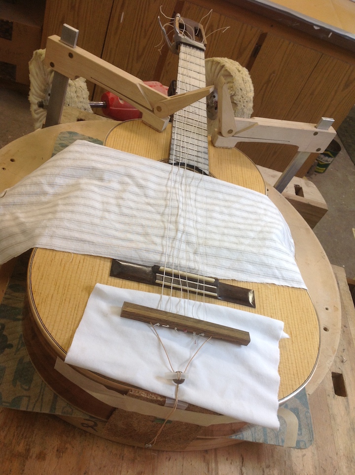

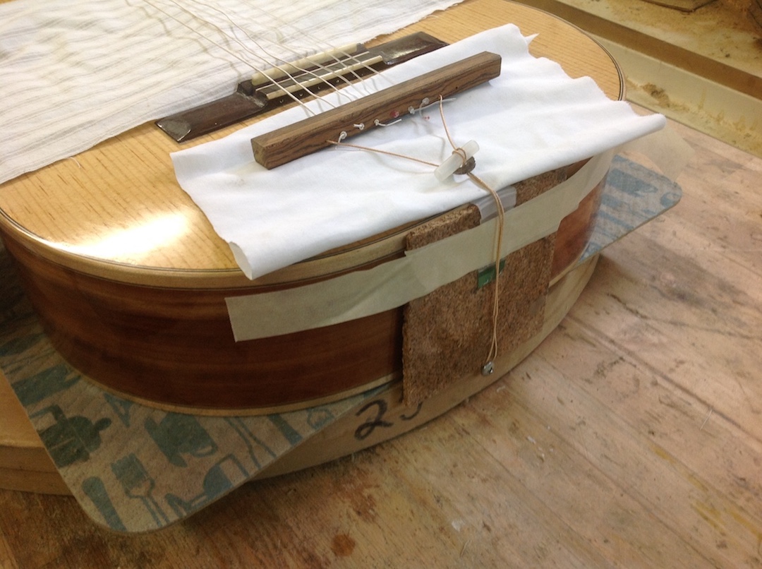

I radius the back of my guitars and carefully clamp the finished guitar onto the radiused form on either side on the linings where they meet the neck. At the tail end of the form I put a screw to hold a makeshift tailpiece with the desired string spread and attach it with an old g string. Protect the linings with a piece of leather where the contact point is for the tailpiece. And of course protect the top of the instrument too, as the tailpiece will sit close to or touch the top.
I string up with an old set of similar strings with the bridge movable and find the point where the open string and the fretted octave are good. I tune to the flat side because I figure the string tension will negate that in the first few days of use. You will need to consider the amount of additional saddle compensation (to the flat side) for the several strings that will need it.
I can expect an additional 3 cents of compensation from a 3/16" thick saddle with the medium tension nylon strings I use and a 650 mm scale.
This gives the saddle position without the pull of the strings involved. To figure that I measured another guitar (of similar design) with strings under tension and with strings relaxed then factor that in.
So I bring the guitar up to pitch.
Set the bridge for good intonation and measure to the front saddle edge of the outer strings.
Relax the tension and measure again. To this measurement I add an additional 1/32" as this is the amount the bridge gets pulled forward on my guitars.

Could you send a picture?Marshall Dixon wrote: ↑Tue Sep 01, 2020 10:56 amI radius the back of my guitars and carefully clamp the finished guitar onto the radiused form on either side on the linings where they meet the neck. At the tail end of the form I put a screw to hold a makeshift tailpiece with the desired string spread and attach it with an old g string. Protect the linings with a piece of leather where the contact point is for the tailpiece. And of course protect the top of the instrument too, as the tailpiece will sit close to or touch the top.

Here are pictures of the one I most recently threw together for a 7 stringer I'm working on. I mocked it up on a 6 string in the finishing process and didn't put the tuners in or the nut in place. And the strings need to be long enough to make this work.
Anyway, this will give you the idea.
