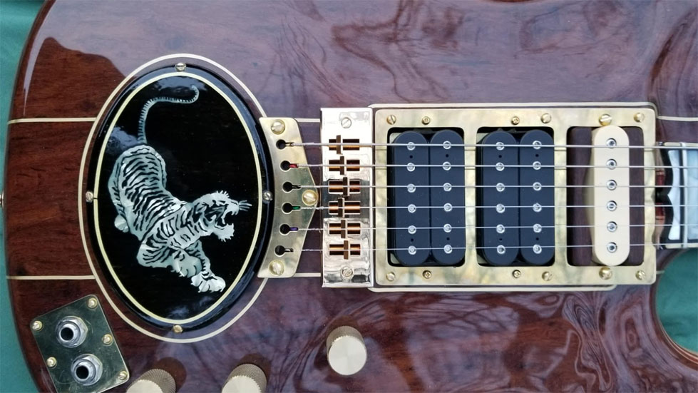

I am taking a stab at building a Tiger/Rosebud inspired guitar. Trying to figure out the best way to do the brass binding around the perimeter of the body. Do I do it as I glue the layers of laminates up or use a wing cutter once its assembled and shaped. Just not sure the best way to approach this. Anyone been down this road and could share some insight?

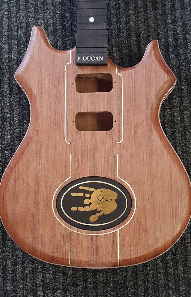

Thanks to all. After having done some research, I ordered some brass 14 gauge square brass stock. I am going to glue it in with epoxy. It seems that an awful lot of builders do this without issue so I guess I'm going to give it a go. Now, I just need to figure out the best way to cut the channel around the perimeter of the guitar. I'm thinking a wing cutter but not sure I can get one that thin. Might just be chisel work.

Sorry. Its 16 gauge square brass wire. It measures .058. I'll use a 1.5mm chisel. Gauges aren't universal to all materials. Its not technically binding. Maybe trim or accent. It does run the perimeter of the body on the side top and bottom although I don't think I'll be doing that. I'm just going to do the top.

Well, here it is on a mandolin that I built and am now gearing up to build a guitar. This one is headed to finishing booth soon. I spoke with some other builders that make Irwin tributes and they all confirmed the key was a tight slot and CA adhesive. I've done three mandolins so far and each one is a little better than the last. Joints are much tougher than celluloid or wood binding to get matched up..
