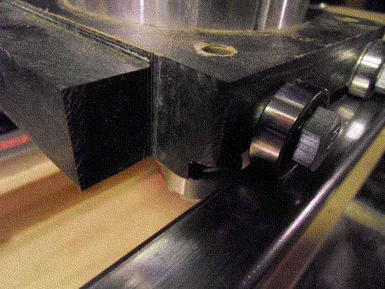

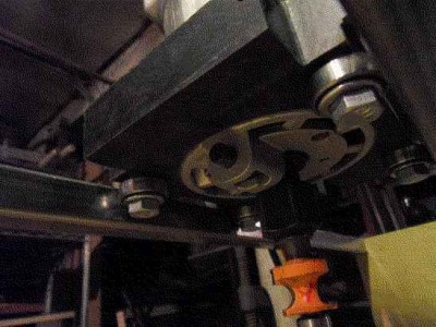

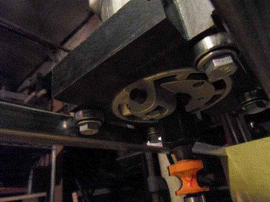

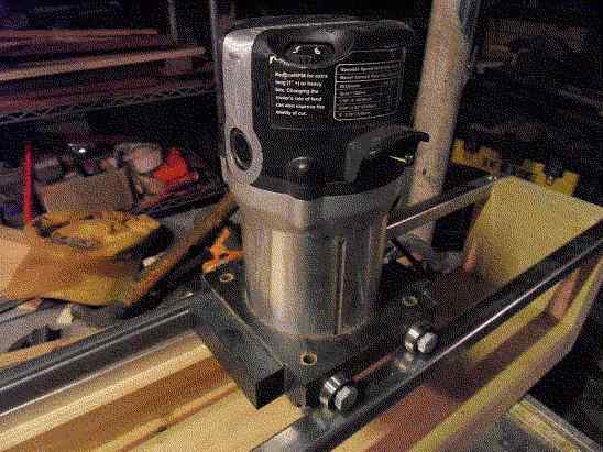

Samuel,
I had made a sled using ball bearings and 1" steel tube, and used it with the workpiece moved instead of the router position. The wood I needed surfaced was attached to a platen that fit exactly between the uprights. I would then move teh unit, clamp it to the platen, route, unclamp and repeat. My intention was to havev this carriage run on bearings as well, but I decided to go the CNC route.
Even then, I still finish up with a plane, and scraper plane.
