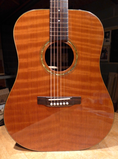

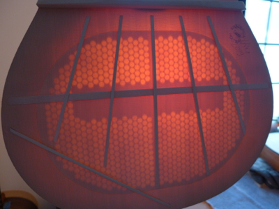

Hello everyone.
After making DT classical guitars (Nomex or all-wood) for more than 18 years I decided 3 years ago to build a few acoustic guitars using the same method.
Basically is a 2mm thick top on which i CNC machined about 900 1/4” holes 1,5mm deep and then laminated a thin 0,5mm venier to close the holes.
Here are a few photos of the guitar in working process.
The first photo is a classical all-wood top. It shows better the way is done.
The same process is applied to the acoustic guitar top.

Ok. The 0.25” holes and the 1.5 mm depth gives me the best ratio of weight and stiffness of the machined area. Bigger holes will weaken the top, smaller holes will not remove enough wood to make a difference.
I started experimentig with this design in 2001 and for 2 years i tried all kind of versions untill I decided to this one. The wod DT has only one glued surface, the Nomex has two. As i mentioned, I build this design also with Nomex, but I think the sound of all-wood tops is more natural. Besides more power, the main gain is in the outstanding clarity, responsivness and the balance between trebles and basses. The inside lamonation acts like a large very low brace, reducing very much the need of heavy bracing.

I see you use double-x bracing in your guitar that are thickened where they span the area of holes, to give extra strength there I presume.

The outside top (2mm thick) is the one machined. The inside is just a thin, 0.5-0.6mm, piece of spruce laminated over the holes.
I built the first DT in 2001 and since then many dozens of Nomex and all-wood tops. I never had any problem with delamination.
The way I designed my tops, there's not stress on laminted areas. The bridge is always glued on a solid part of the top, no machining under the bridge
in both models, Nomex and all-wood.

No, i didn't see delaminated tops. I had in my hands only the David Russell’s guitars and they were fine.
Clay. A top without the inside layer won’t work. It’s to week, it doesn’t work like a lattice. What is left after machining has all the fibers interrupted.
Only after lamination, the top will regain the strenght, the walls of the holes are only spacers between the bottom of the holes and the glued lid of the holes.
