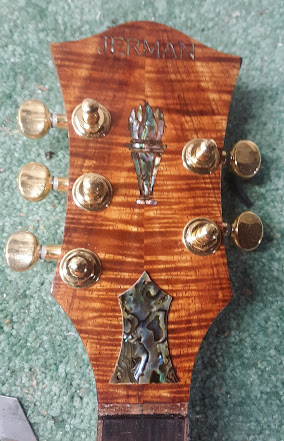

For my headstocks, I use a .006 abalone laminate sheet with a backing. Easy to cut with a laser and cnc. I cut the pocket in the headstock about 3x as deep, install the inlay then flood it with CA. This prevents me from getting in to the inlay when I sand the headstock. So, I just got a quote for $600 to have a fretboard inlaid. Not arguing value of work or price but that's outside my budget. I'm wondering if I could use the same process that I use on the fretboard that I use on my headstock? I'm also wondering if an epoxy would be a better material to flood it with then CA. Do you think one would hold up better than the other? Thoughts on this approach. If I can pull this off, then cost plummets to less than $100.
