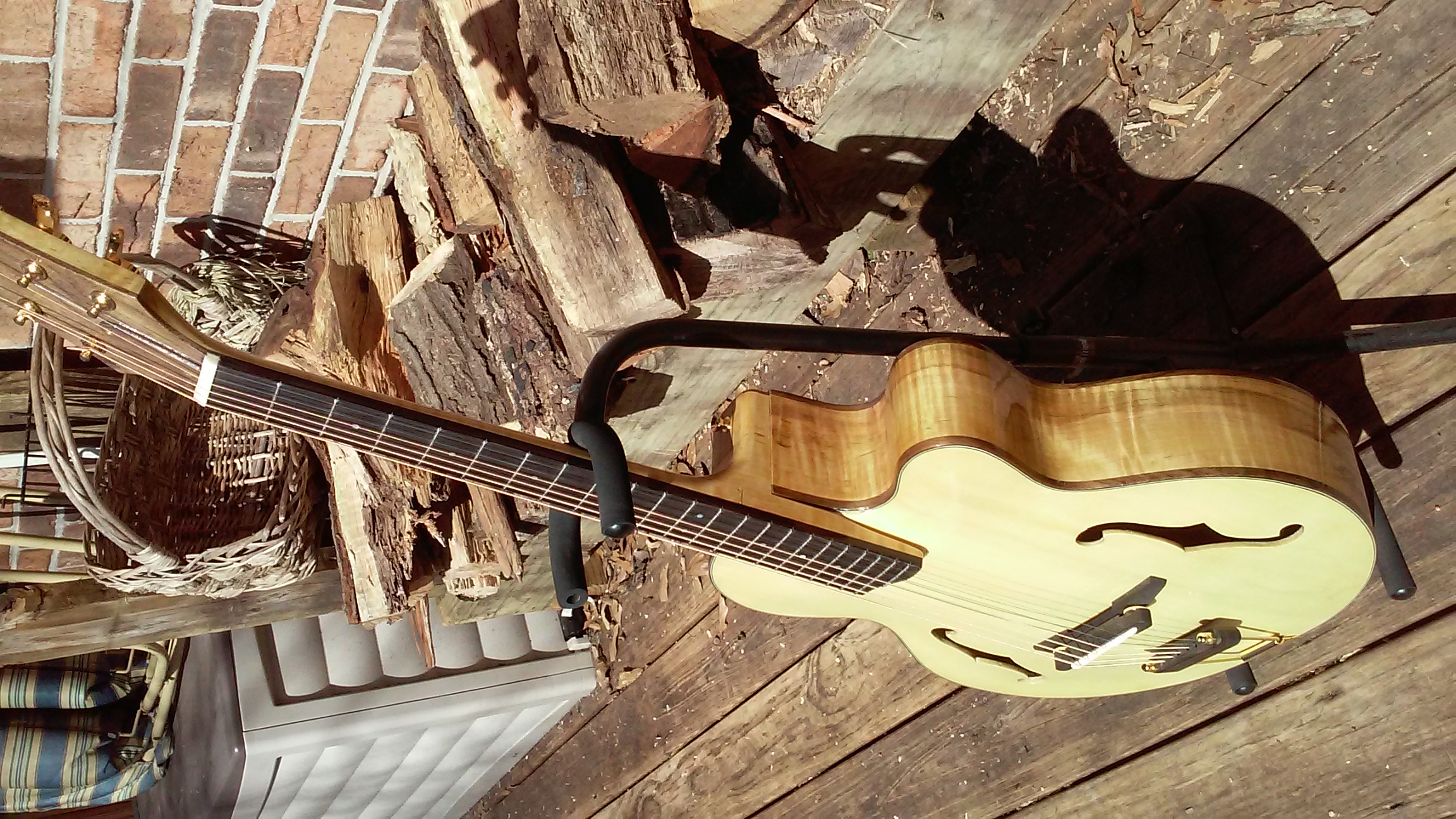

My GOM plan is essentially a 14.5" wide and 2.5" side depth archtop guitar. I built to a 23.5" scale length. So far I have completed two octave mandolins (8 strings, 4 courses) and one guitar. The guitar uses the 23.5" scale length and a standard 1.680" nut width. Has a great sound and plenty of volume even with the smaller size.
The plan is available on MIMF with the proceeds benefiting the site, so no financial interest for me. Hope this gives you some ideas.

Post by Mike Conner »
james inkster wrote:
Mike Conner wrote:My GOM plan is essentially a 14.5" wide and 2.5" side depth archtop guitar. I built to a 23.5" scale length. So far I have completed two octave mandolins (8 strings, 4 courses) and one guitar. The guitar uses the 23.5" scale length and a standard 1.680" nut width. Has a great sound and plenty of volume even with the smaller size.
Hi Mike, where on the site do I find your plans?
James: The link is available at a couple of places from the Board Index. The plans are here:
https://www.mimf.com//phpbb/viewtopic.php?f=15&t=1465
I also have posted a Archtop Build Journal on MIMF, found under the Detailed Builds/Tutorials section, here:
https://www.mimf.com//phpbb/viewtopic.php?f=59&t=4668
