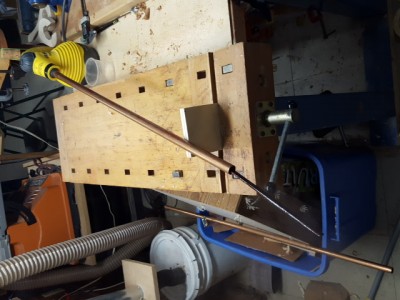

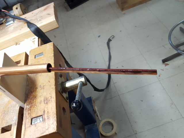

Hello, I was having trouble dry bending some granedillo into tight curves, and so I came up with this. It's a hotshot steam cleaner, and some copper pipe. It works.

Do you plug the end of the copper pipe when steaming? How big a hole for the steam to escape?
About how long does it take?

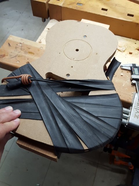

A pipe coupler is pushed on to the spout of the steamer, and the pipe is just put in the coupler. Because the coupler is not firmly attached, there is some water leakage and you can see a cup to catch that. The pipe can be any convenient length, and there's sufficient steam to heat the entire length of the pipe, and the amount of steam was 'adjusted' by the cork & rubber band on the trigger. I don't think it's necessary to plug the pipe. In this instance, because the short strip of granadillo was so brittle, I cut an MDF form that matches the guitar's profile, and gradually bent the repair strip as I clamped/supported it with strips cut from a bicycle innertube until dry.
