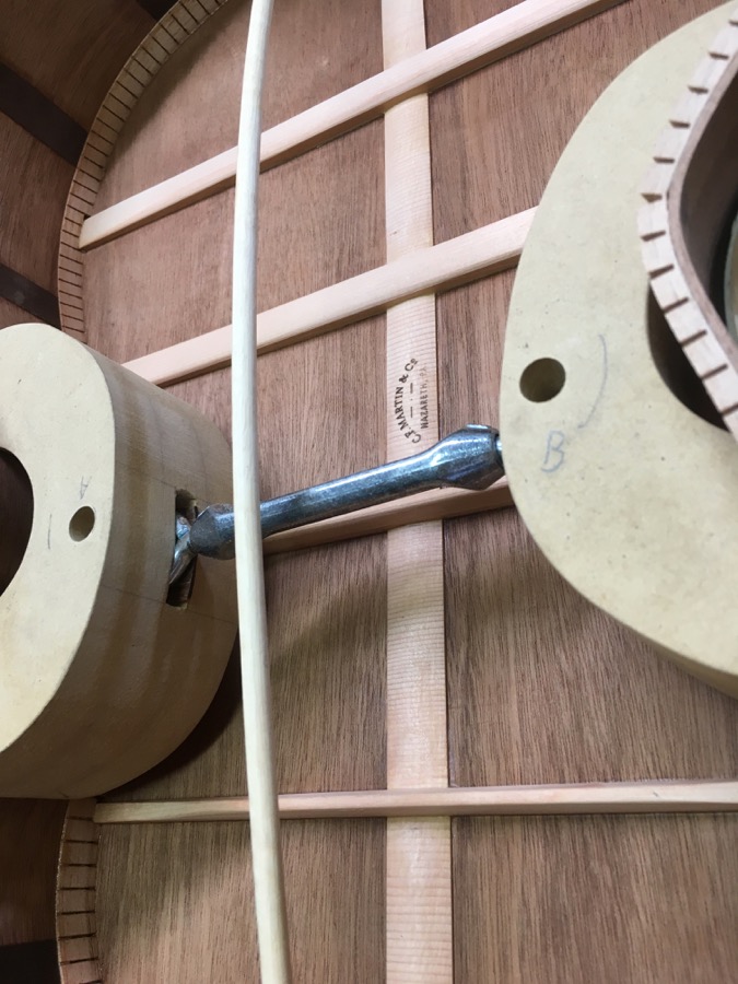

Yesterday, I was mixing some TransTint dyes to make the new bracing in my Martin resto/mod project look not so new. I added two drops of brown and one drop of red/brown to some alcohol and sprayed the inside of the box. The red/brown was probably not a good idea. It turned the spruce bracing sort of pink. So I started trying to remember color theory to see what color will "kill" red. I could not find a good reference online other than somewhat vague descriptions of Additive and Subtractive Color Theory, the best one being on Wikipedia. But what I need is a color wheel to post in my shop to refresh my memory whenever I break out the dyes. I created the attached chart and wanted to see if anyone sees any errors in my understanding of this.

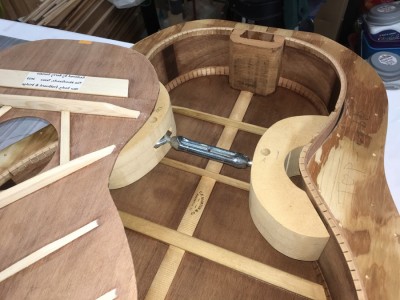

I ended up mixing yellow and blue to get green and then sprayed that on to kill the red. I also added a some tobacco brown which is kind of a greenish brown. It worked out pretty well. It gave me the dirty, aged wood effect that I was looking for. Thanks for the explanation Brian. That helps.
The first photo is the pink bracing and the second is the final result. The un-dyed top bracing is included for comparison.
