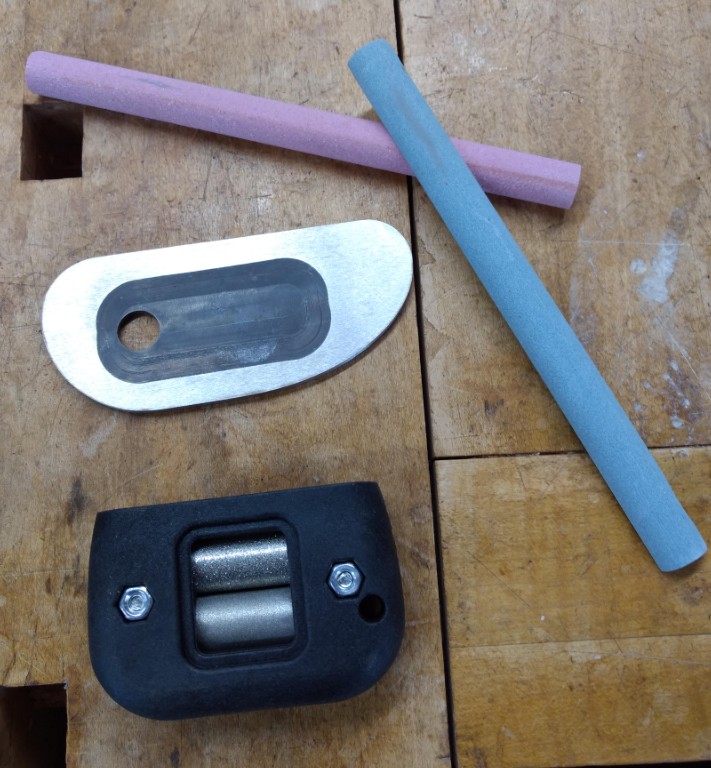

After reading this thread I bought a skate sharpener and a few cheap sharpening stones. The sharpener (with 2 grit sizes) and the round stones have the same diameter, about 1/2" and the right size for the scraper. Although it took a while to get the original deep scratches out of the hollow edge, this seems to do the trick and leaves a nice surface. I look forward to using this scraper a lot more now. Many Thanks !

Chuck, I am not sure that that will work. The small radius will create too sharp of an angle on the cutting edges which might ruin the scraping action. I sharpen my scrapers on an 8" diameter wheel which keeps the cutting edges very near 90 degrees, which is optimal.

There's no reason why the skate sharpeners can't work, but the edges may not hold up as long. I usually touch them up at least once after the initial edge is lost. Lap the face as per usual, then stand the scraper up on it's edge on a fine diamond stone and hone small flats on either edge. This helps keep the edge straight, and gives a fine burr that's well backed up for final cuts.

Oddly enough it didn't take long at all to get the original sharpening gouges out with the skate sharpener and it went right to the edges quickly, so It doesn't seem that far off of the original curve in spite of the small diameter. Maybe some slop in my technique is a better explanation. I like the idea of ending with a diamond stone as you describe. That should take care of any issues from too small an edge and make a smoother cut as well.
