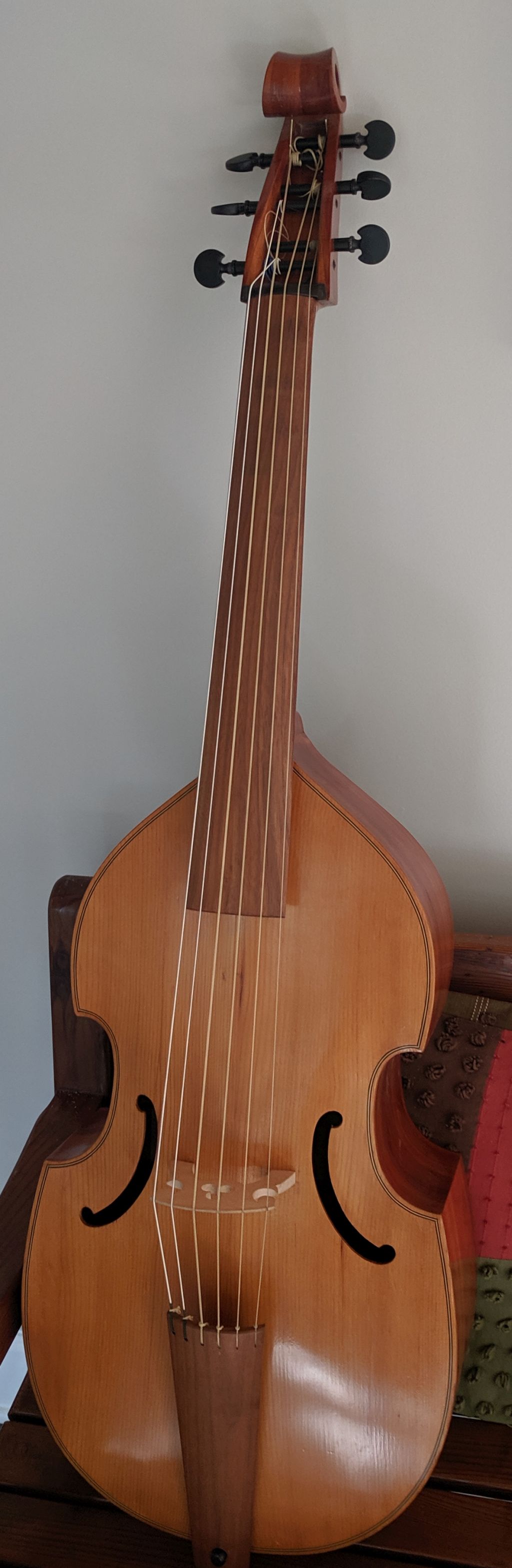

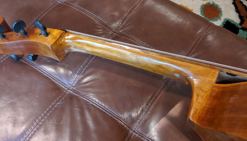

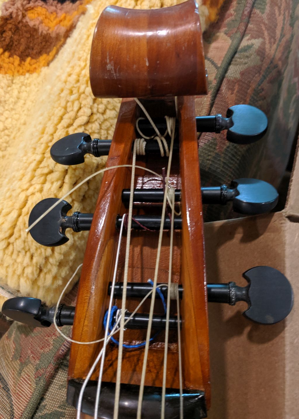

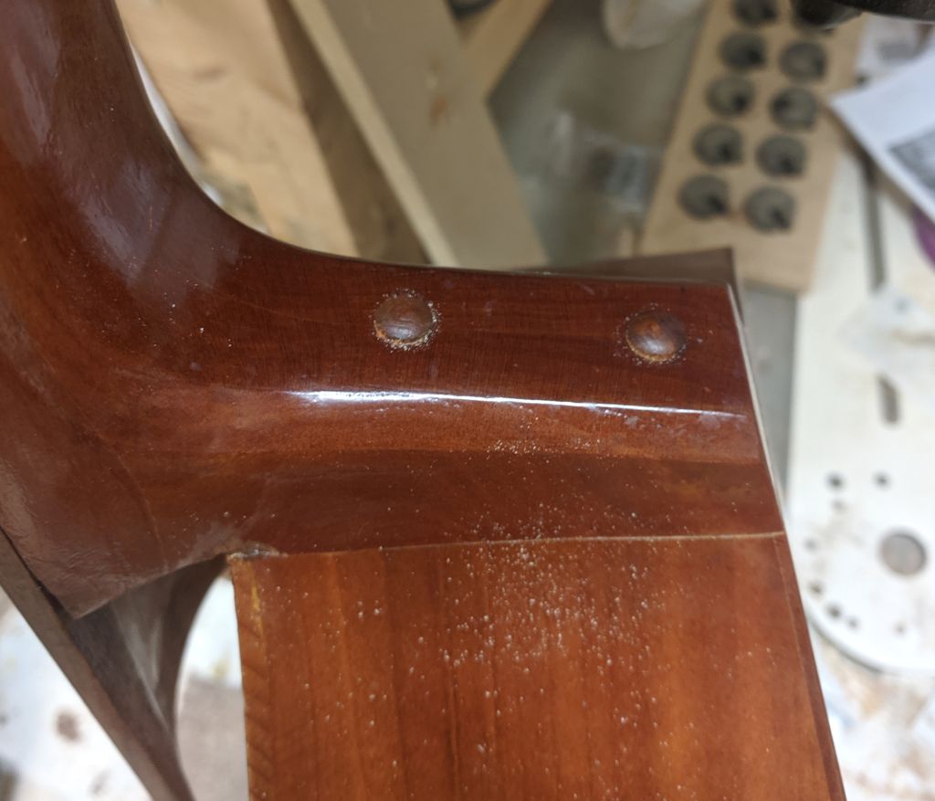

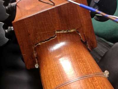

Hi all, I recently acquired a viola da gamba that had a broken neck with kind of an ugly repair. I believe it to be mechanically strong, but it bugs me and I'm looking for suggestions. I did not spend much for this instrument so not a big deal if I totally wreck it. Pictures below. I'm pretty sure it was repaired with Titebond and I think it was back around 2000 that it broke (dropped). The instrument was made in 1984. In the second photo you can see where dowels were added for strength.

My first choice would be to clean up and reglue the pegbox without any added contrivances (that dowel probably did more harm than good. If there isn't enough wood (gluing surface) left on the neck, you might consider grafting a new neck shaft on the old pegbox.

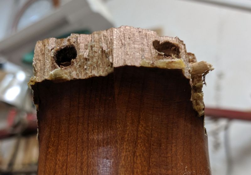

I got the nut off and noticed that I could wiggle the pegbox (not very much, but freely). So the glue was a non-issue. I did drill out the dowels and was able to pull it apart without much effort at all.

Wow, not much real estate there in that joint. It needs serious reinforcement but I don't see where anything could be added.

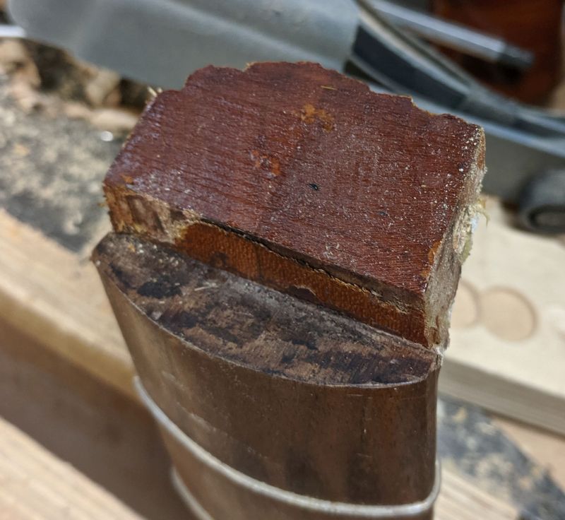

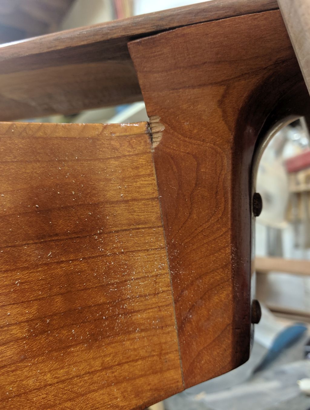

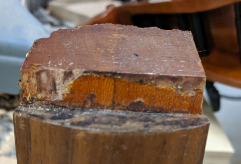

It was not a clean break and I cannot get a good mechanical fit, so I will try a neck graft (i.e., make a new neck and splice the old pegbox on to it) as Clay and others have suggested.

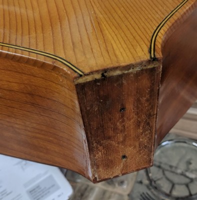

I got the fingerboard off pretty cleanly so I hope to reuse that. The next question was the body/neck joint. Yes, the two buttons in the pic below are hiding wood screws...
Turns out to be just a butt joint.
Perhaps I should have left the neck attached and tried to just splice on an extension, but maybe next time.
I plan to mortise a new neck on at this time (I would like to avoid using screws).

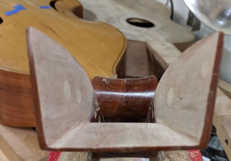

Thanks Fred, if I totally screw it up, I'll contact you. At this point, I have the pegbox attached to the new (mostly carved) neck and am carving out the part of the graft in the pegbox.

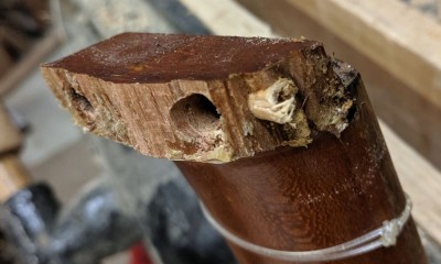

I don't have a photo of the neck by itself, but here are a few of the rough in shots.

Wow! Thank you for the pictures. I think I learned something here.
