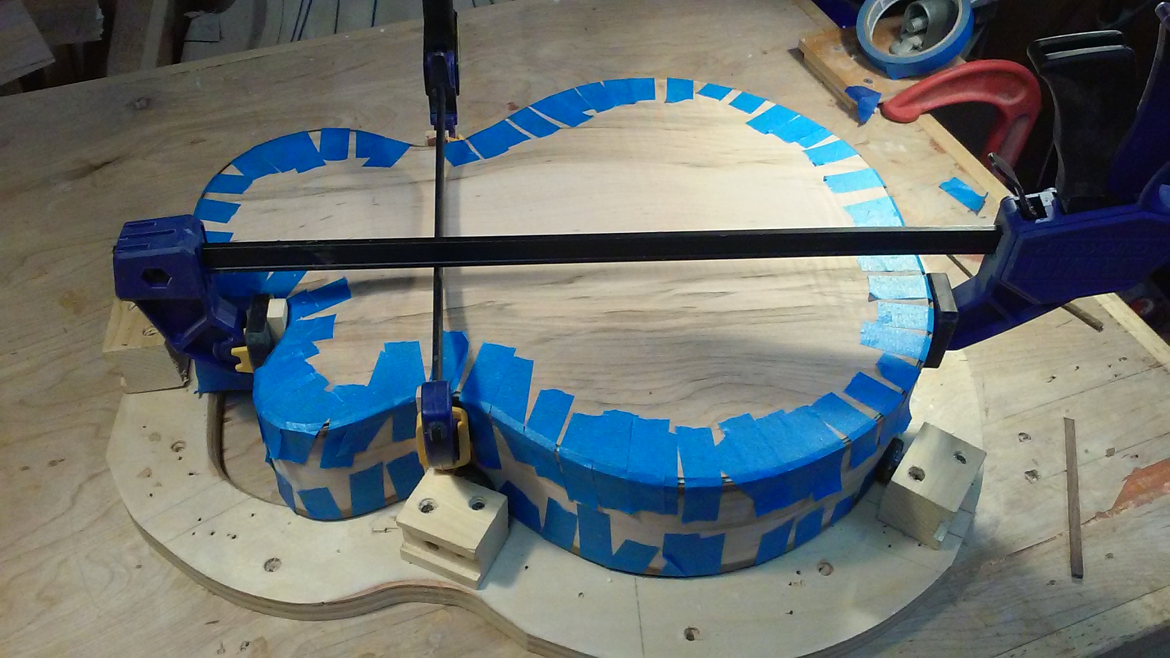

I my case I am quite happy with my homemade hot pipe for bending sides, etc. My goal is to warm and bend small pieces of binding for inlays, for which I am presently using a cup of boiling water. I am also specing out an F style mandolin build, and there are some pretty tight bends at the scroll where the hot air gun would be appropriate. I wouldn't risk using it on the body.
I know what you mean about the waist bends, and it can be a challenge to keep them tight in the rabbet. I have found using small wood cauls rounded off to match the waist curve, held tight with a Irwin clamp across the waist, can keep the waist binding and purfling in tight while fitting and gluing the upper and lower bouts. Here's a picture:
Hope this helps!
