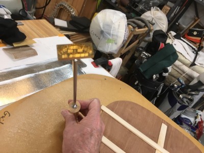

I have the Carruth scraper as well - mine needs sharpening :-(
its great when it is sharp (and it stays sharp a LONG time)
Posts: 585
Re: Restoration of a 1931 Martin 00-17
Chuck Tweedy wrote:looking good!
Thanks! I had seen these and didn't realize Mr.
C was the creator.

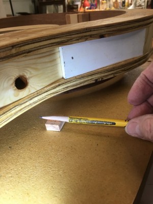

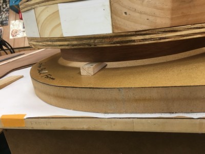

Marking the sides to establish the contours on my radius dish. First I placed a block under the bottom block to get it level with the head block and then put a wedge under one side to level the rims side to side. Then I glued a small block to a pencil and traced a line following the radius dish.

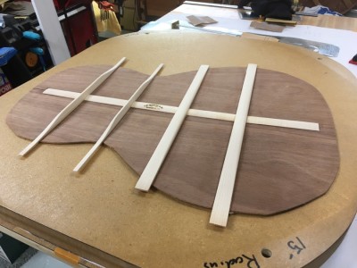

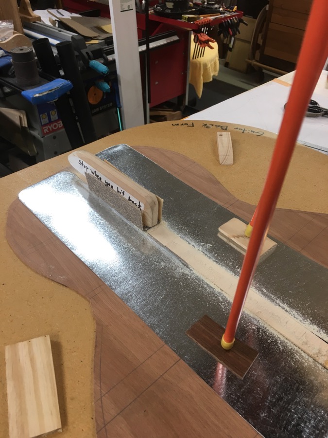

On to bracing the back. First up is the back graft made from cross grain strips off a spruce top that are 3/4" wide. The joints of the strips are located at intersections of the braces which will be cut away. I made a 3-1/2" diameter sanding caul out of a piece of plastic duct to meet the Martin spec for the back graft.
Posts: 3249

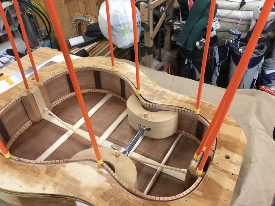

Now the braces get attached with HHG and a forest of go-bars.

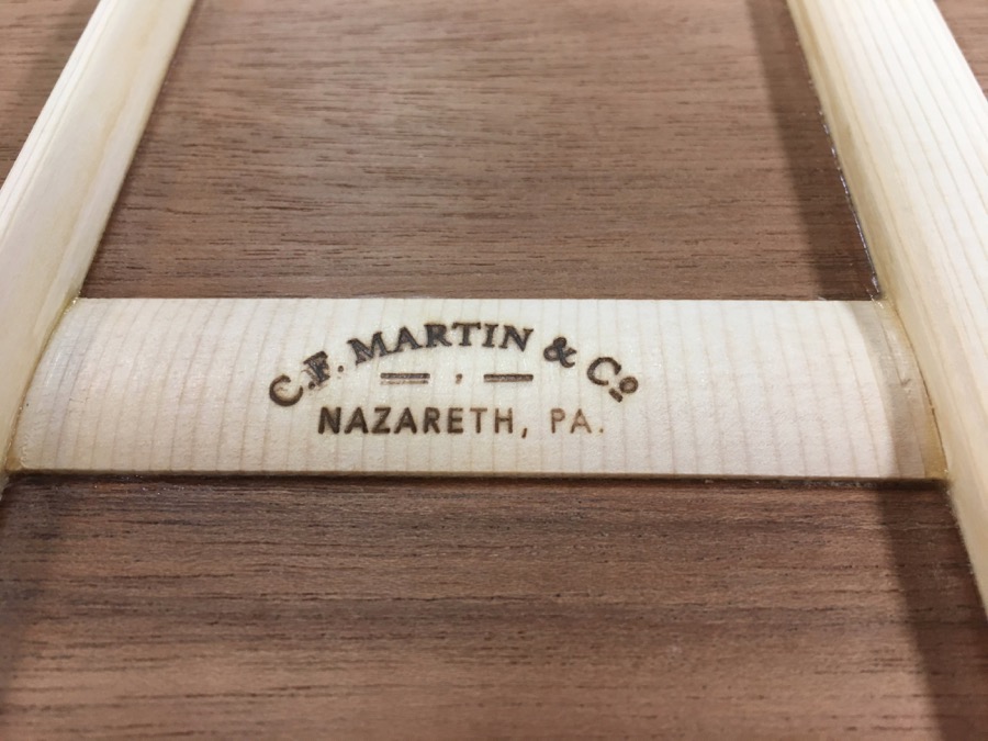

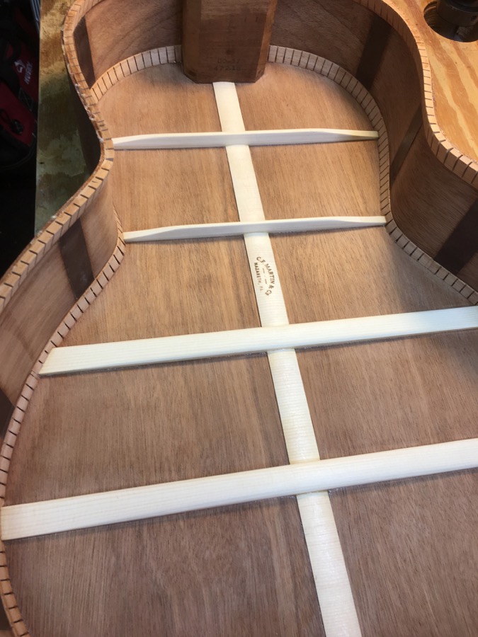

Carved and sanded the braces. And then applied The Brand.
Posts: 1188
Post by Gordon Bellerose »
Wow Barry! Where did you get that brand?

Posts: 3249
There are folks on Etsy that make custom brands really cheap. This one cost me $20 plus shipping. I got a photo off Google Images of the brand, sized and cropped it and sent it to them. Took about 3 weeks. Quality was impressive. I doubt that I will ever use it again but this unusual project was deserving of the slight cost and extra trouble. If anyone ever has a similar legitimate need for this brand, I would be happy to pass it on.

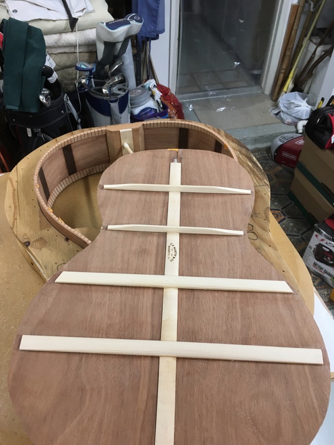

My process of attaching the back starts with "Driving the Bus" with my motorized dish. Then I locate the back onto the rims and mark the locations of the back braces for notching the kerfing. This time I did something different and used small pieces of masking tape stuck onto the kerfing with the edges of the tape just touching the sides of the braces. When I lifted the back off, the tape gave me a very accurate guide for making razor saw cuts. This seemed to work well, but it won't work when attaching the top because the box will be closed.

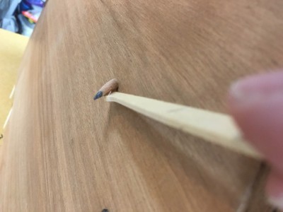

To mark the back braces where they are to be cut I have a little piece of a pencil glued to a popsicle stick to trace the face of the sides. Then I make a calculation of how far to cut inside this line.

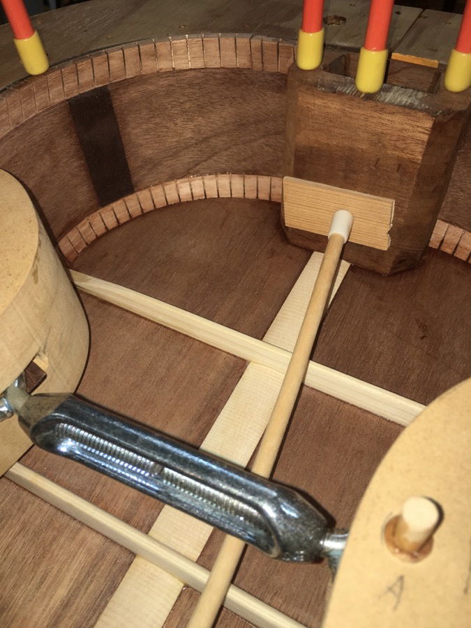

I cut the end of the braces off and carefully cleaned up the glue residue. (Since there will be no binding on this guitar I am attempting to get a perfect joint on the plate to rim joints.) Glued the back on with the assembly sitting in the radius dish and with some 5/16" diameter, shortened, fiberglass go-bars. I have used this method quite a few times in the past but I did not get the perfect joint this time. A very slight gap in a few places. Not bad enough to attempt a re-do, but it did appear to be enough for me to reevaluate my tools. I am going to build a bunch (50) of special sized cam clamps to do future plate attachments.

Barry Daniels wrote:... (Since there will be no binding on this guitar I am attempting to get a perfect joint on the plate to rim joints.) Glued the back on with the assembly sitting in the radius dish and with some 5/16" diameter, shortened, fiberglass go-bars. I have used this method quite a few times in the past but I did not get the perfect joint this time. A very slight gap in a few places. Not bad enough to attempt a re-do, but it did appear to be enough for me to reevaluate my tools. I am going to build a bunch (50) of special sized cam clamps to do future plate attachments.
If you use HHG you can deal with each imperfection in the joint separately - I just brush in a little hot water and a touch more glue, clamp that spot, and then heat with a heat gun until the back is hand-hot. Then tighten the clamp until I get squeeze out.
To be honest, I use this method because I can't get decent back or top joints any other way :oops: But it does take the pressure off when glueing up, knowing that final adjustments are possible later.
Posts: 3249
Chris, I used fish glue on the back so I don't think that approach would work. Gluing backs and tops on is the one step I have not yet done with HHG. I know Mario P. and others (now including you) that do this and that has me thinking about attempting it one day. To be honest, the slight glue line that I have is very tiny and should disappear under the stain and finish. But thank you for your explanation. That was very useful.
