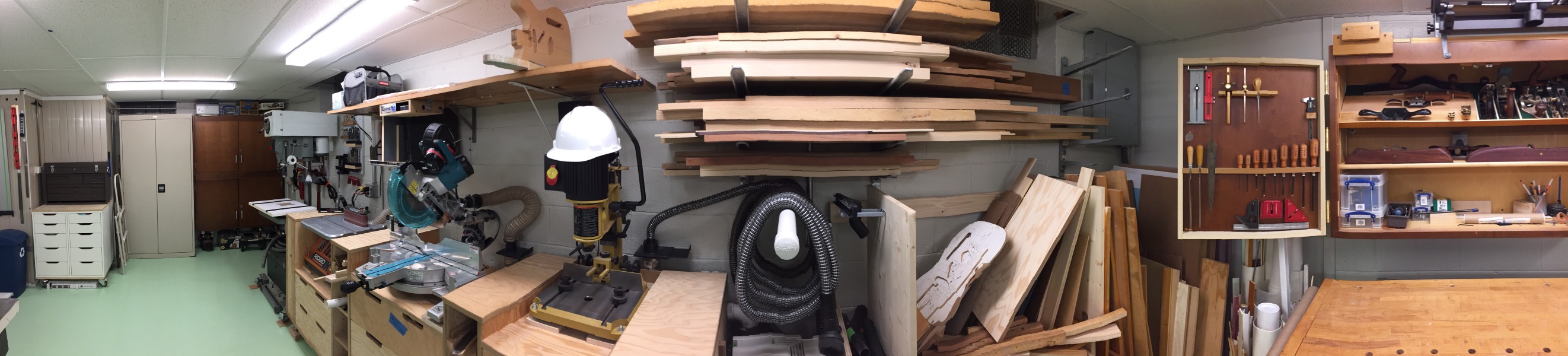

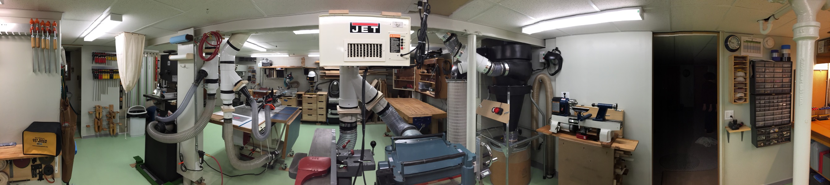

Matthew - can't offer much "layout" advice. My shop has been expanded and completely re-configured three times in the 25 years we've been in this house. The current layout is a joy to work in, but was highly constrained by:
Despite all that, I have a 3hp cyclone, 15" planer, 8" jointer, 14" band saw, cabinet saw, floor-standing VS drill press, oscillating belt/spindle sander, sliding compound miter saw, mortiser and mini lathe, plus two work benches, two machinists tool boxes, tool cabinets, a small wood stash and *TONS* of storage space. Completed it about two years ago, and still have a couple of half-empty drawers. Everything is on mobile bases, but nothing ever has to be moved to use.
I'm attaching for panoramic photos below. I hope they show up ok.
The only way I was able to get this all into such a small space, with every machine in a fixed spot, hooked to dust collection and power AND still had room to move around was by modeling the entire thing in Sketchup. I was able to download from their 3D warehouse many machines that were close in size to my own, and was able to move things around, route DC ducting, plan lighting etc. so that it would all work together.
There are also a gazillion (and thats a *metric* gazillion) little features that I would not live without. From the dispenser for 3-oz plastic cups for mixing epoxy and the like to the multiple tool racks made of 3/4" ply that allow drilling holes for screws and hooks anywhere so I can cram a huge number of tools hung neatly in a small space, one over the general-purpose work bench, one behind the woodworking bench, and two next to the drill press. I have things hung all over with magnets, including the adjusting hex keys for every machine, my hot-glue gun next to my woodworking bench for "tack-welding" jigs together, and as you can see, drawers, drawers and more drawers. The four cabinets you see all measure about 12" deep 48" wide and about 30" tall. Along the wall above the SCMS you'll see a very deep shelf. This, like Brian's cabinet is my "work in progress" shelf, just tall enough for guitar bodies to be stored on-edge, but invaluable so it keeps parts from taking up all the flat surfaces when I'm mid-project, or like Brian, have to drop one project to do something else that gets put on the front burner.
Because of the I-beam, I routed my DC ducting right down that beam. This kinda splits the shop right down the middle with most of the actual wood working done on one side, and the other side dedicated to finishing and assembly. The four shots below show the two "halves" of the shop, with two panoramas for each - one toward the center (with the air cleaner, jointer planer and band saw) and the other looking at the outer walls.
PS - in looking at these, I'm amazed at how much additional stuff I've crammed in here since these pics were taken!!
