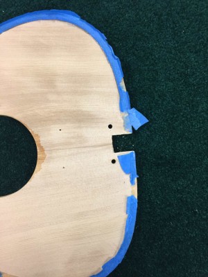

ok - yea
i did the tape-one-surface-glue-to-the-other thing. that was a week ago for the top to the rims. been fussing with other stuff since then
prior to that i did a test fit with 2-sided masking/mount tape, and it is pretty obvious that i'm stupid and the eventual glue-up would not work, but i tried the glue-up anyway - to prove i'm an idiot.
with 2-sided tape, the top loosened from the rims in spots because there is some stress in spots (some more than others) and masking tape is designed to let go - duh!
so what is going to be different with tape and its adhesive on one side and glue on the other - NOTHING! the tape side is going to let go. whichofcourseitdid - proving i'm an idiot.
ah! but I'm not that dumb! instead of using Titebond which would foul one surface with a non reversible glue ... yes, instead i used fish glue. so now i have one side sized in a protein glue - ha HA!, and now i'm going to go back and use thinned hide glue which - if i were not an idiot - i would have done in the first place.
I DID LEARN SOMETHING and will pass that along here. IF you want to glue something to the outer surface of masking tape - Wipe it down with ethanol just prior to gluing. the ethanol activates the shiny glue backing, and the glue sticks like a mo-fo.
See my pic - you can see that the fish glue totally destroyed the top surface of the tape
