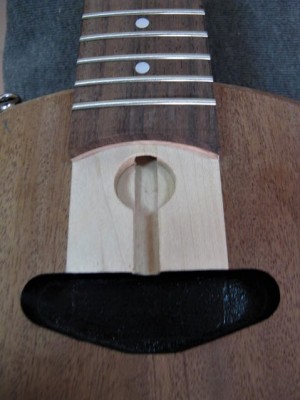

This is a photo of the general layout of the body.

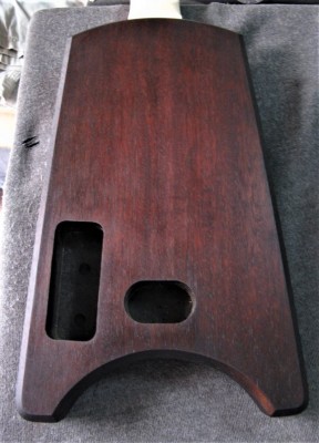

On the back of the body the wood is amargo, which is also called bitter ash. The larger rout is for the electronics. The smaller rout is for me to tighten the nut on the barrel jack. The ground wire will also run from the tailpiece into this rout and then into the electronics cavitiy.

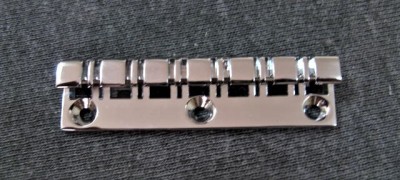

These are photos of the bridge and tailpiece I am using. The bridge is my second attempt at making one. I still think it's rather bulky, so I might take more off of it.
The first photo shows the tailpiece as it is now. The second photo shows what it would look like with the two outer pairs of string slots removed. I think the tailpiece would look better with the slots removed, but I am concerned about removing the material, which I believe is brass. Of course, one problem with removing the outer slots is that I would lose the two holes for screws. In addition to the one screw in the middle, I am thinking of using epoxy to glue the ends of the tailpiece once it is positioned correctly. The outer string spacing on the tailpiece the way I plan to use it is about 34mm, and the outer string spacing at the bridge will be around 44mm.

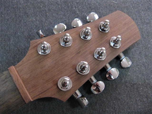

I've taken a few more photos. This is the headstock.

If you reshape the tailpiece, you could drill and countersink two new screw holes closer to the center one. Remember that if you start cutting into the tailpiece, you will have to deal with the plating. You will have two different surface appearances but the plating may also start flaking off.

Bryan, thank you for your comment. I've decided not to cut the 12 string anchor tailpiece, mostly because I'm unfamiliar with how to cut and drill brass. I think for my first octave mandolin build, using the tailpiece the way it is should be OK.

Working with brass is not that hard. Get a scrap piece and drill and counter sink a few holes.

And the back.

I think I like the finish you've achieved, I would just gloss that up and polish. I like the tall bridge, but I might move the tailpiece farther towards the tail, to get a longer string extension behind the bridge. Reduce the break angle and longer strings will reduce compensation issues, make the strings feel a bit looser. I might need to experiment with string compensation a bit, finding the right string tension might need some experimentation, so finalizing the bridge saddle might be a last step.

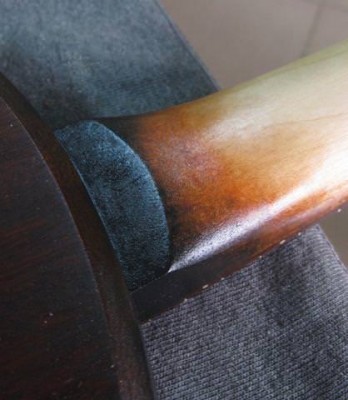

Since my last post, I have been working on applying finish to the neck/body join and the back of the headstock. This has proven to be more difficult than applying finish to the body. Today is the first time I have felt close to achieving what I want.
The body/neck join.

And the headstock.
