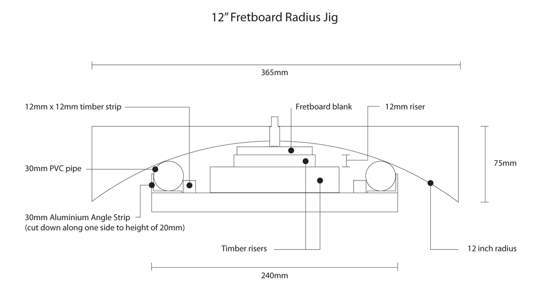

Re: Exasperatedly sanding cocobolo
Hey Peter.
I used this plan, which has been posted a few times on this forum, to make my radiusing jig.
I used 2 inch pvc pipe for each side. I drilled holes in the top of them big enough for the screw head and screw driver to go through. That way, the screws that hold it down wouldn't deform it, and they would be out of the way when using the jig.
It's pretty simple, and works well.
You do have to be careful when making the router "cradle", to get an accurate radius.
One of the advantages is that you can make other cradles for different radii.

Thanks Gordon, that looks like the kind of jig I can Mickey Mouse together out of junk lying around without going over my daily allotment of sloth.

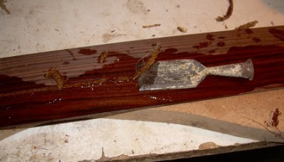

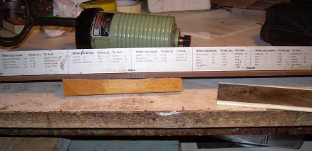

I tried out the bit I bought off of ebay (Yonico 16 inch radius). I didn't do a lit of jigging, just used what I had on hand. I had reasonably good luck with it and got a surface that with a little bit 0f scraping (to remove a small ridge I intentionally left) and sanding I think will be quite usable.
My setup was just the simple jig I use for routing neck blanks and as a fence for the "router table" that is just a router base mounted to the auxiliary table of the table saw. The untapered blank was hot melt glued to a scrap of particle board.
I made several passes moving the fence back a little bit each time to avoid having the bit grab the work. After routing the first side I "unglued" the hot melt from the particle board using alcohol. and then removed it from the blank with alcohol and an old dull chisel
I reglued the blank to the particle board scrap and ran the other side. I instead of moving the fence back each time I left it in the "final - finished" position and just did light passes not allowing the bit to dig too deep. Climb cutting may have been a good method for doing this, but I did O.K. routing in the normal fashion. I have a fair amount of experience using routers and am comfortable (but try not to be _too_comfortable) using them. The cutter is slightly proud of the bearing so I set the bit so it would leave a little bit (1/16th in.) in the center of the blank for the bearing to ride on.
With a little bit of scraping with a card scraper to remove the ridge I intentionally left and some light sanding I got a surface I think will be suitable for tapering and final finishing similar to what is commercially available. So overall I am happy with the performance of this bit. There are some things I need to fine tune, but that is more about my setup, and less about the tool.
