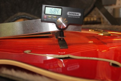

Alan and others, I don't want to hijack this thread but I would like to learn more about why you think certain break angles are good or bad. First, when you say a 6 degree break angle, exactly how are you measuring that? Here are three different tailpiece guitars (completely different internal construction)
The first is a ladder braced 12 string, top has a 20 or so inch dome, neck angle is a degree or so to make the fret plane hit the top of the bridge, total height of the bridge and saddle over the top is about 1/2 inch. The tailpiece is at the end of the guitar and is fairly close to the top. The angle between the string segments is about 174 degrees, is this a 6 degree break angle?
The red guitar is a flat top but its sort of built like an archtop. Top is domed about 20 inches, floating bridge, neck is angled slightly so the fret plane hits the top of the bridge at its lowest position. The strings are 7/8 over the top at the bridge. I measure the included angle at 169 degrees, does that mean the break is 11?
The yellow guitar is a Gibson ES style - laminated top with a considerable arch. Neck angle is 3 or 4 degrees and it overstands the body. Floating ToM bridge adjusted so that the fret plane hits the top at the lowest adjustment. I measure 167 between the string segments - would that be 13 degrees?
All three guitars have notches in their saddles to space the strings. If I make a bunch of simplifying assumptions I can calculate the downforce on the top of the guitar - with 250 pounds of string tension the 12 string has maybe 25 pounds vertically into the top, with 170 on the yellow guitar I calculate close to 40 (I'm simply reducing everything to right triangles and applying a little high school trig). If I change that 12 string to a sixer with 165 pounds of tension the vertical component is in the 17 pound range.
The only other thing I can add is that all three guitars play beautifully and seem to be holding up well. Since I didn't have a clue what I was doing when I built them I'll put that down to blind stupid luck.

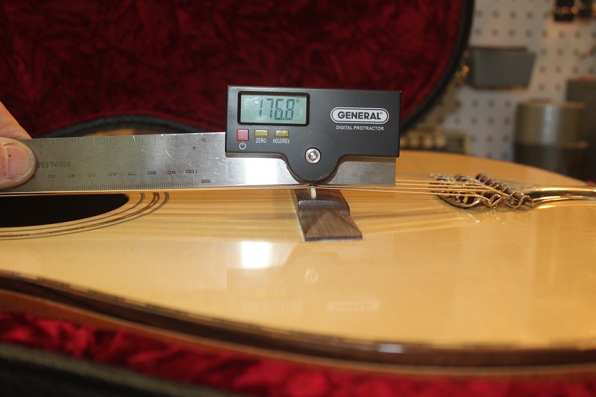

Freeman, I don't have such a fancy digital protractor, but your method is the same as mine. If you were to zero your protractor when it was straight, it would read 12 degrees directly rather than 180 - 168 = 12. I agree with the magnitude of your downforce calculations. In my simple "loudspeaker cone" analogy, the top of a guitar is the loudspeaker cone. Ideally it floats with zero preload and the string vibration acts directly on it in a magical way, like the voice coil of the speaker cone. In reality we need to transfer the vibration somehow, so we press the strings down on the saddle with the break angle. In my view some downforce is needed, but it can be minimized. I have a spider cone resonator guitar with around 4 degrees, same as your parlor guitar, and it plays solidly and loudly with no string bounce issues, so that is a lower limit that I can live with. Traditional archtop geometry, doing it the way it's always been done, results in around 12 degrees, like your two archtops. If you want to wonder why, I think you could put it down to "driving the top" theories, which abound to this day (even though I disagree with them), and simply playing very hard to generate volume - hit the strings really hard and you need both a decent break angle and high action to keep them on the bridge and give them room to vibrate over the frets. At the end of the day, my experiments have shown me that there is a wide range of acceptable that I define as between 4 and 14 degrees, and in that window you get good results. I also, FWIW, tune down to D-D and find it really opens up the bass response, evens out the trebles and is generally a better result - and it reduces the tension of a typical set of .012 - .052 strings to around 135 lbs, reducing downforce yet again. None of this matters for electric guitars, of course - down force magnitude is irrelevant as a construction element, and tailpiece height can contribute to sustain, I am told...

I'm a 'structural-functionalist'; if it works it's good. A 'bad' break angle is one that either is too low to keep the strings in contact, or so high that it causes unnecessary loads on the bridge and top that might lead to failures down the road.
In my mind the break angle is the angle that the string breaks downward behind the saddle. In your digital gauge picture a reading of 180 degrees would be zero break angle. By my lights your 12 string is showing 3.2* of break, the red archtop has 11.6*, and the other 13.3*. Resos usually keep the strings in place by notching the saddle.
Brian Evans pretty much nailed it; for some reason people think that more down bearing will transmit more force to the top and make more sound. In fact, it's easy to show that the vibration forces of the strings at the saddle are well defined, and depend on the initial displacement angle when the string is plucked. You'd have to work pretty hard to get that transverse force above 15% of the string tension, which implies that a break angle on the order of ten degrees would do it. Since the signal is limited, and will all be transmitted so long as the strings and saddle stay in contact, anything beyond that is simply trying to break the bridge or top.
