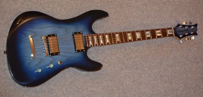

Finished this one last fall, and just got around to taking pics.
Here's the run down:
Swamp Ash body
Maple/Padauk neck
White MOP inlay with Paua inserts
Locking tuners
Golden Age humbuckers with coil split using push/push controls
Roller TOM bridge
Blue burst finish.
Plays and sounds really really nice.

Very nice, Gordon. I've used the Golden Age humbuckers on a couple of guitars and was very impressed with them.

Very nice, love the colour, for some reason it looks a bit Mosrite'ish?

Chris: I suppose it could resemble any number of guitars. It's difficult to draw and build a double cut, or any other shape for that matter, that doesn't resemble something. People have been doing this for a while now. :D

Nice job, Gordon. Beautiful sunburst, and I love the FB inlay!!
Who's the manufacturer on that bridge?

That is the locking roller bridge from our friends at stewmac.

Also, which Golden Age pickups do you (and Freeman) use (alnico 2/5, overwound)? I'm considering using them for my current build...

I have used these for two builds so far. A really nice pickup for most music styles. Great clarity and separation.
"Very articulate" is how one of my customers described them.
I also like the fact that they have 4 wire leads.
http://www.stewmac.com/Pickups_and_Elec ... ckers.html
I have a build underway that is going to get some of the overwound. A bit hotter.

Gordon, I've used the SM locking roller bridge on a guitar with a Bigsby but why would you use one with a stop bar?
Steve, I've used the Golden Age Parson Street pups on three guitars - my personal LP clone, the chambered LP clone and a 335 clone. I play bluesy stuff and trying to learn more jazz chords, the other two are used for more classic rock. I'll admit I don't know squat about pickups but I figured these were a good place to start and you (or my customers) could always change. So far no one has, everyone raves about the tone. I use Alnico 2 in the neck, 5 at the bridge and mostly play on the bridge or blended. I haven't bothered to split them.
My archtop and another 335 got SD Bennedetos in the neck and some generic SD PAF (maybe a Seth Lovers) at the bridge. Again, I mostly play the neck, the owner of the 335 is a jazz master.
Posts: 1188
Re: New Guitar
Post by Gordon Bellerose »
This guitar was originally going to get a Bigsby. Thus the roller bridge.
I had the post holes drilled for the bridge, and decided to put a stop bar on it instead.
If in the future someone wants to put a Bigsby on it, it will be easy.
