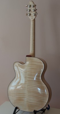

Post by John Clifford »

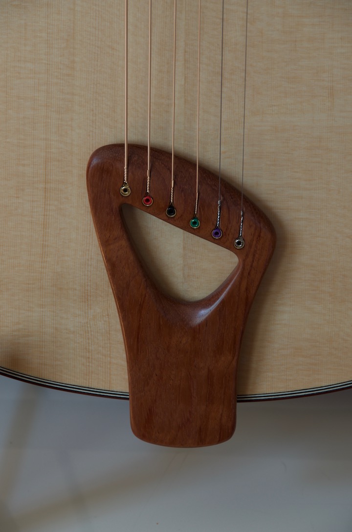

I just finished another archtop. I got the idea for the string retention system on the tailpiece from Alan Carruth. Thanks Al! I think he got it from someone else - so it goes. I'm kind of into celluloid, and I used quite a bit of it on this guitar. What do you think?

Stunning work, I long for the day when I get good enough at building to do a totally natural finish without the need for paint somewhere to cover up the odd blemish! I love the celluloid it looks really classy...

Beautiful work! Lots of nice details. About your tailpiece, do you find that providing more afterlength for the high strings makes them feel looser? Normally the low side of the tailpiece is shorter, to give more afterlength to those strings. In my mind, if the whole afterlength principal works, you need the high strings to feel looser, because those are the ones that players use more for bends.

Thank you! A longer string length definitely makes them easier to bend, so I agree with you that longer treble strings make sense if you are aiming for that. Although to be honest, I design my tailpieces based more on how they look than on any sound scientific principles.

That's the string retention system that Geoff Elliot devised for the harp guitar that he helped John Sullivan make for John Doan, or, at least, that's what I've been told.

Fantastic work John, it's beautiful.

Wow! Beautiful guitar.

Wow, really beautiful.
BTW: what kind of bracing? parallel, cross or something custom?

Beate, it's X braced. Just the two cross pieces on the top.
