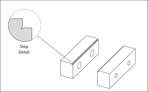

Consider a few stepped vise jaws as well.
Steps can be sized as needed.
A step will prevent the object from being pushed down into the jaws while applying working pressures.

Re: Nut vise - another tool gets built
Glenn - I like that. Just bought another drill press vise at a flea market yesterday and might make some inserts like this.
