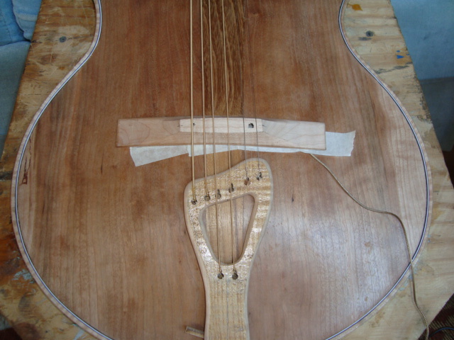

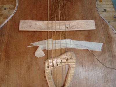

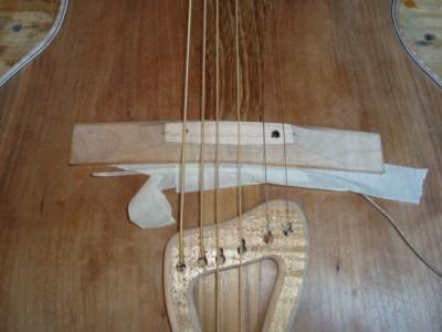

Here is a dumb test I made today.
I put about I” of the piezo cable under the back side of my hollow bridge with volume nearly off and it produced a fair amount of sound. With nearly 6” of piezo under the bridge it was notably louder.
This pickup is LR Baggs SL Anthem with pre-amp
The first shows the very rough carved hollow bridge.
The next two show piezo lengths
Does anyone see a problem with using this larger amount of piezo?
