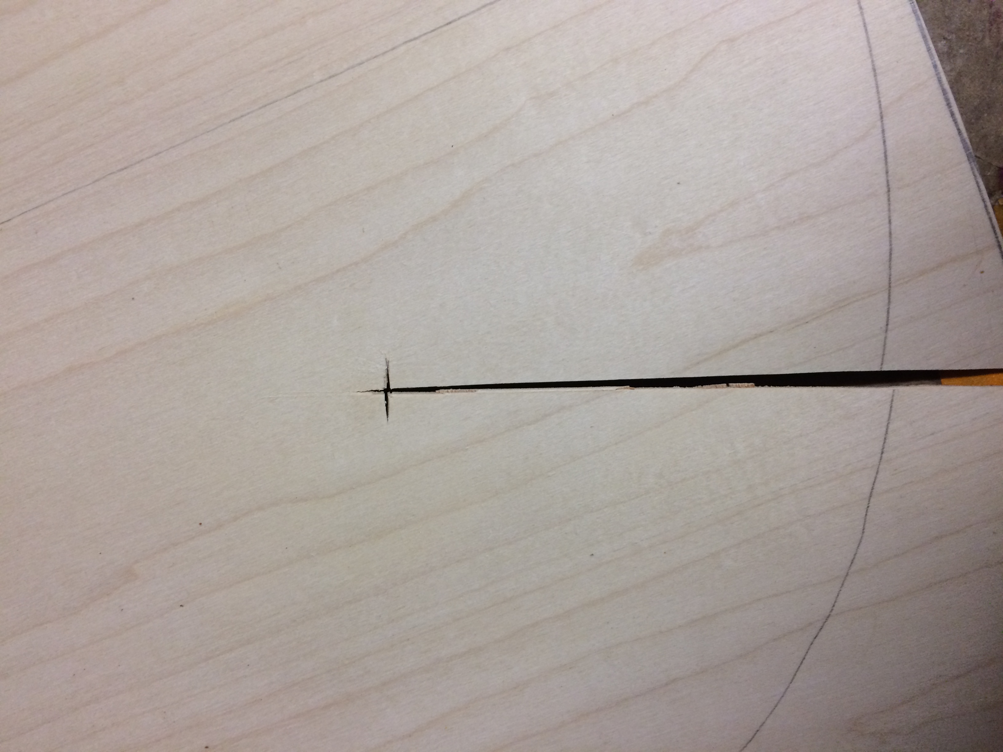

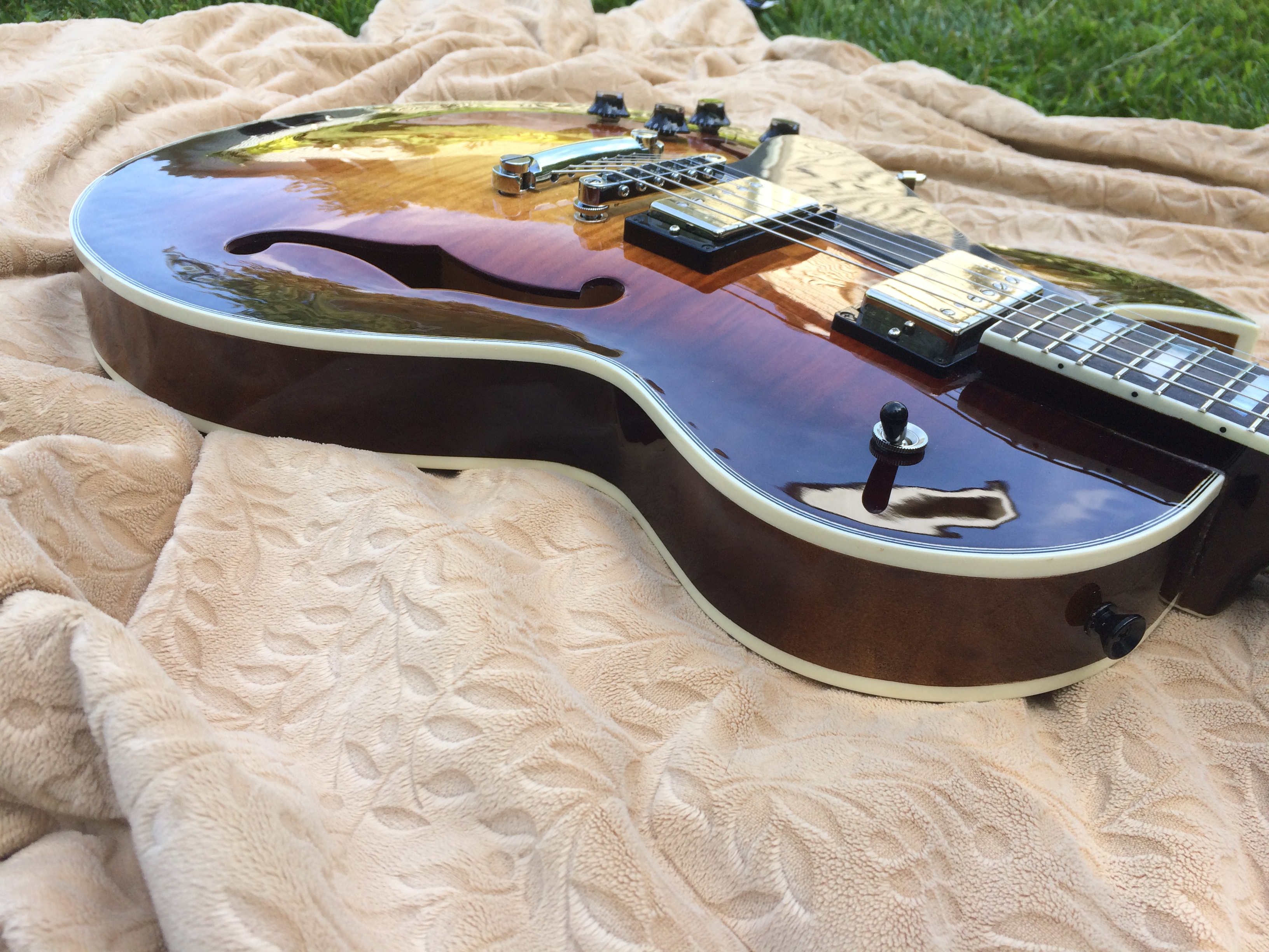

My experience..while limited to probably a dozen guitars...so 24 plates..give or take a few rejects..has been quite a learning experience and despite the miscues which was anticipated..pretty enjoyable. Most all of my products come from Joe woodworker. I start with the plain maple 4X8' sheet. Now, those come with like a luan or cheaper mahogany backer..so there's actually two layers of wood. You can get either cross grain backer or parallel grain...which is noticeably more flex and like to mix them up ..but for the laminate sides..I use the parallel. A plate consists of three layers of the maple backed and an outer face layer of figured maple...he recently picked up some quartered spruce which I'm using on current guitar. I use the Ultra Cat glue. In this latest guitar I'm using some epoxy and rather than three layers using a layer of nomex...think it's Steve Anderson using this product..wow..light strong plate. Anyway..
The biggest issue was the buckling of the plates and finally the seam of the face veneer...I'm sure there's a mathematical equation that claims you can't do this ..then do that ...and expect it to work out!! ...But, I'm not going there! :) My remedy has been ..on a rotating basis on the maple/backed plates is to slice from a wedge/an angle that begins app 6" inches from the lower bout edge..that produces app 1/8" "gap"at the edge of the plate...so slice of pie..if you will..silly ..I know. At the other end of the slice..I make three smaller cuts..I call them crow's feet..so at that point..it doesn't buckle...I also scrape that area back to make it a bit more flexible. Now these slices (one per) are on either side of the center line.. and angled ...one sheet the "slice will be left of center...next sheet right of center then again left of center. For the face veneer...join the sheet in the center with the blue tape on the face side.....fold the veneers over and with an 6" 100 grit block ...slowly and gently take about 45 swipes on the jointed edge to create that "angle" beginning app 6" from the lower bout edge. After a few plates..you get a feel for the process...and I've found that those "slices" close right up ..and no buckling. I clamp them onto another carved form to cure...
I'm sure I'm forgetting plenty...but ..seems to work out ok.
Posts: 3253
Re: Tips, Tricks, Suggestion, Experience making laminated plates?
Beautiful guitar, Chris.

So the crow's feet is at the upper point of the pie slice?
Chris Walsh
Posts: 33
Joined: Fri Jan 20, 2012 9:44 pm
Post by Chris Walsh »
exactly Barry... In my experience, I've found that area of the cut wants to "buckle" as opposed to "pivot"...if that makes any sense....and it telegraphs through to the face veneer...I do it to all three sheets of maple...crows feet barely 1/2" I also scrape a bit of the maple away at the crow's feet to make more compliant. Again, alternating to either side of the center line on each sheet..and offset the cut on the third sheet so as not to double up in one area. You can get pretty good at it..and these "slices" close right up... And in taking this pic for the thread..I noticed the slice is about 4 1/2" long..fwiw..
And, when I put the entire sandwich in the vacuum bag...I leave the lower bout seam of the face veneer...with no tape of any kind...the last 5-6 inches...it will close right up...the tape just creates an obstruction...
