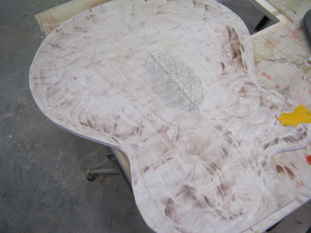

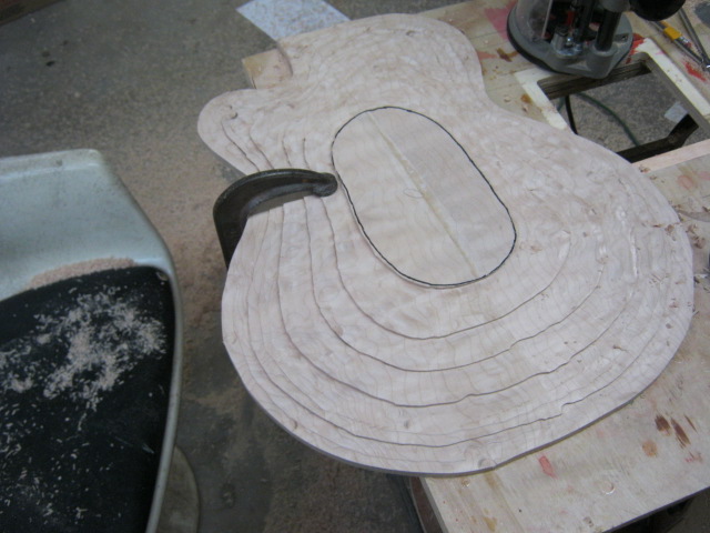

So my decision was to draw out my stair-steps in 1/8th inch increments and use my router free-hand up to each line. Scary but worked fine in the end. My rough carve of an outside back in hardwood would normally take me around 10 - 12 hours with drill press, chisels and routers to get to where I am now. This method took around an hour of routing and 10 minutes with a flap-wheel sanding disc in my angle grinder, so around a 600% reduction in time and a better result. The wood is quilted maple. I still hate routers, though.
