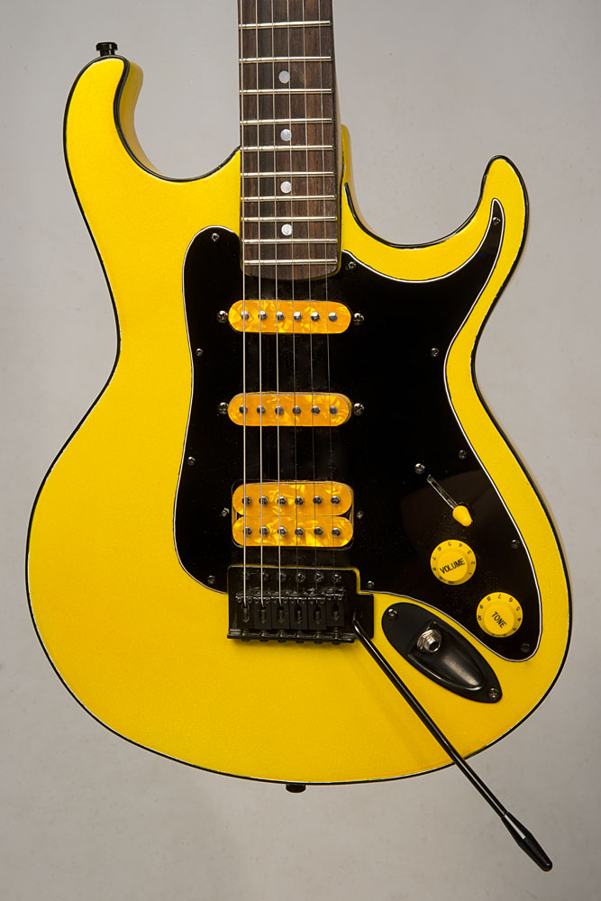

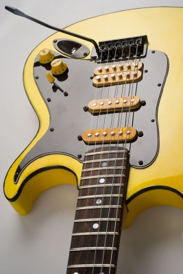

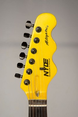

After my long break I have activated myself and started working on several unfinished builds. A few weeks ago I finished a bolt-on neck solid body six-stringer. The model Alligatrix is of my own design, if not necessarily totally unique. Its structure is rather strattish and the "25.6 scale is close to the scale used by Fender. I have not tried to re-invent the wheel but rather create a concept with good playability that can be easily varied with different bridges and pickup constellations. With the prototype included this one is the 5th Alligatrix I have built- I decided to dub the yellow guitar laced with black "Stinger", such as a wasp or a bee. ;)
The 3-pickup guitar has a humbucker at the bridge and two single coils as neck and middle pickups. The pickups, powered by neodymium button magnets, are also of my own design and manufacture. The twin-coil is call Slumbucker and the single coils Single Mothers, a Fat Strat combination. They are quite hot, the Slumbucker wound up to 14 kΩ and the Single Mothers to 10 kΩ (middle) and 7 kΩ (neck). Through the clean channel of my 50W hybrid head they sound quite civilized, darker than traditional Strat pickups but clear and nicely articulate. The overdrive channel turns them into aggressive hard rock pickups. The Slumbucker can be split to a single coil with a push-pull switch in the volume pot. Unlike the Strat the Alligatrix has just one tone pot with a 47nF cap instead of two and all pickups are connected to it, so I can roll down the extra highs when I need to. I shielded the pickup and control cavities carefully and to my delight there is very little hum.
This guitar was not a commissioned build, I built it just for fun, just because I wanted to. If I can find a buyer for it, of course I will sell it, but Iäll be happy to keep it if I don't.
These are the specs:
Body alder, colour candy yellow, acrylic lacquer finish, pickguard & binding black
Bolt-on neck maple, 650 mm/25.6" scale, rosewood fretboard, 22 medium jumbo frets, 6 mm MOP button fret markers, bone nut, acrylic lacquer finish, 6 in line Schaller type black tuners with 15:1 turn ratio
Neck & middle piickups NYDE Single Mothers with neodymium magnets; yellow pearl tops, neck 7.8 kΩ, middle 10.8 kΩ, bridge pickup NYDE Slumbucker with neodymium magnets; yellow pearl top 14.5 kΩ; middle pickup is reverse wound & reverse polarity. Slumbucker pickup can be split to single coil with push-pull switch.
1 volume pot 500 kΩ with push-pull switch, 1 tone pot 500 kΩ with 47nF cap, 5-way switch, yellow knobs & pickup selector switch tip
Black vintage type Strat trem with yellow arm tip, black hardware
I took a series of studio portraits of her. Here they come:

Thanks, Christ. The pickups are not the same tone of yellow as the body and the knobs, but they're close enough. I could have wound the pickups with standard size coils and used matching yellow covers, but then the pickups wouldn't have sounded the same. I'm quite happy with the way they are.

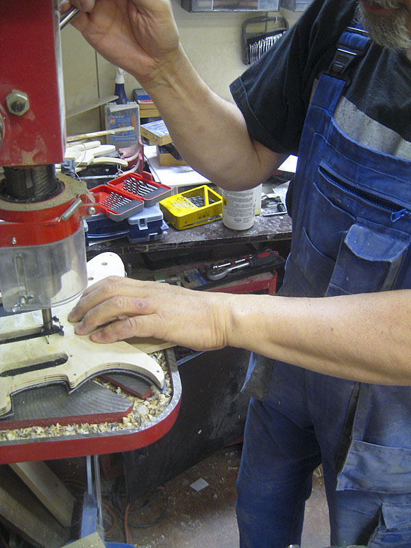

I cut the pickguard from the blank sheet with a band saw and fastened it to the template with double-sided tape. Making pickup holes in the pickguard I drilled with a forstner bit holes big enough for a flush trim router bit.

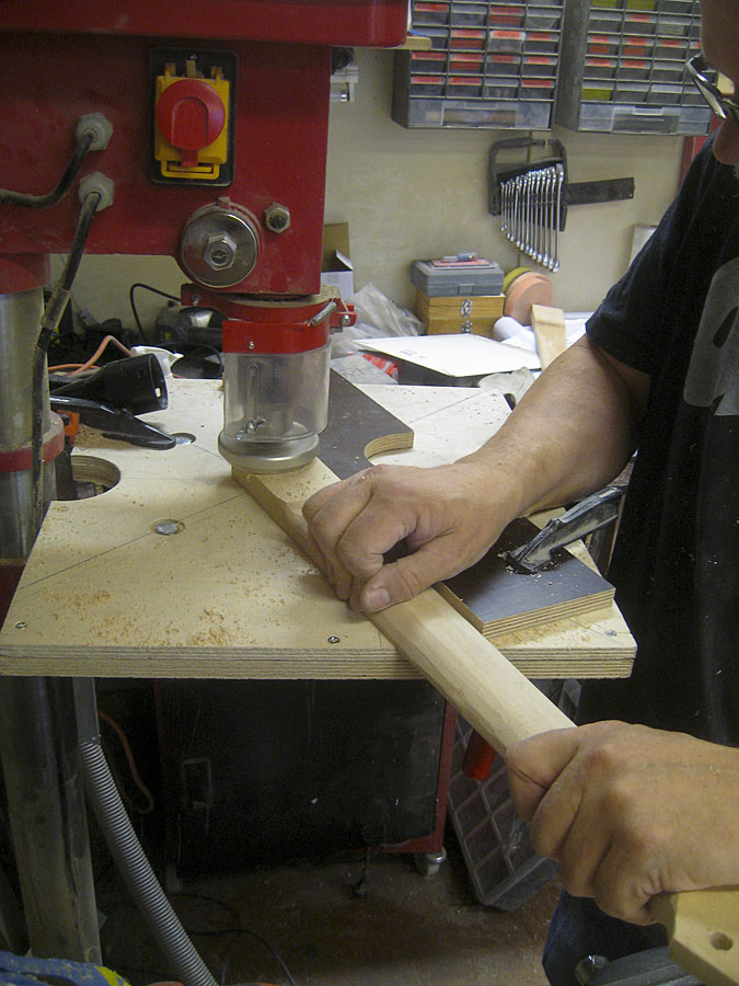

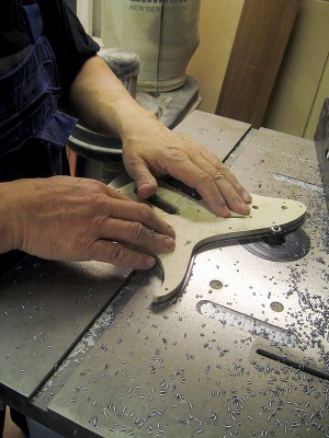

Routing the pickup holes flush with the template on a table router.

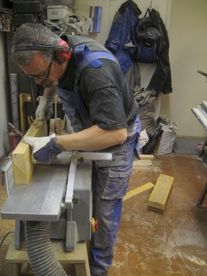

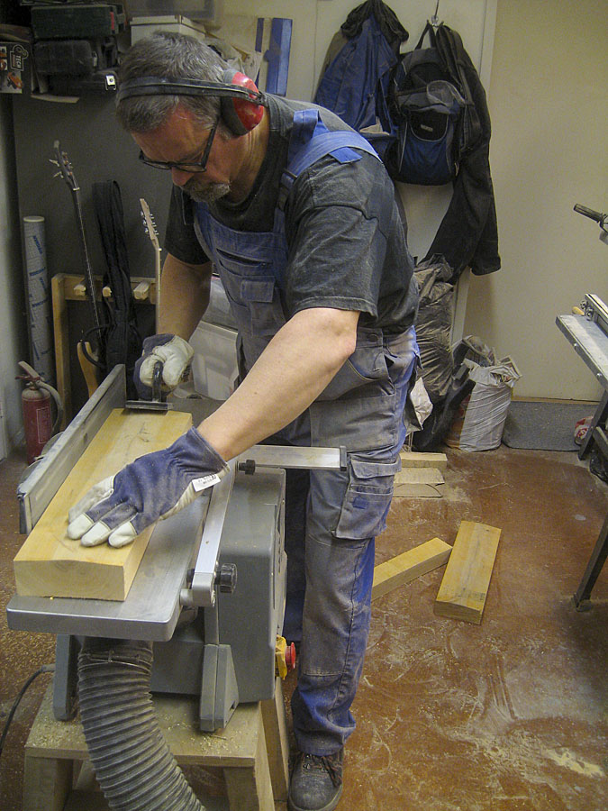

I often plane enough alder to make several body blanks at a time, sometimes not. My planer/jointer is a good tool for that, powerful and accurate. I has only "8 working width, but it's small enough for my workshop and gives good results.
Planing the board sides in a 90° angle with the top and bottom here. There will be no gaps or curving when the pieces are glued together.

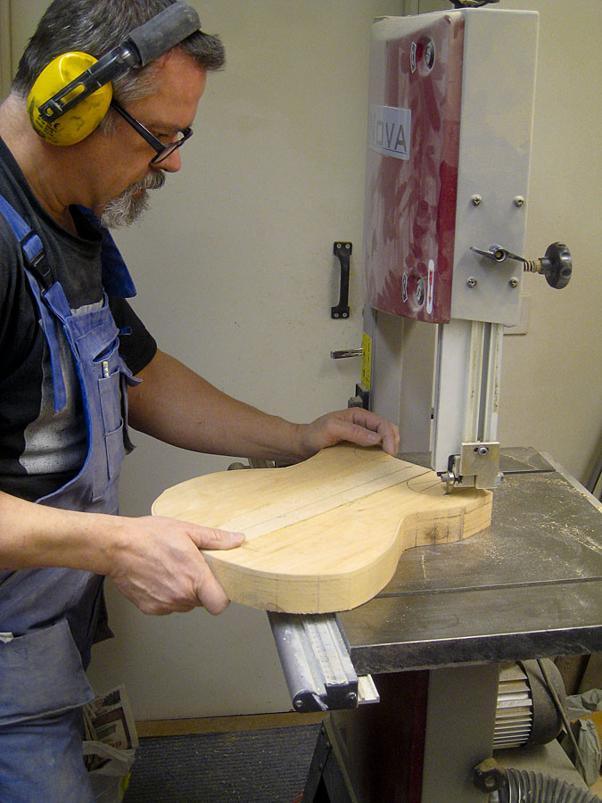

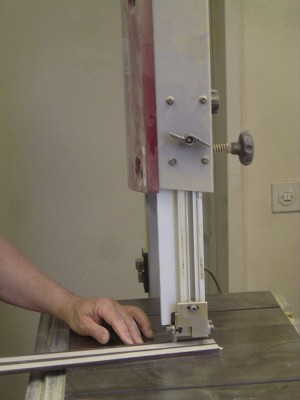

My band saw also has a working height of "8. That's just enough for splitting figured wood for bookmatched tops and surely enough for cutting out bodies from "2 thick blanks. I have found inexpensive Swedish replacement blades for it, so I don't have to risk ruining a fine piece of flamed wood with a dull blade.

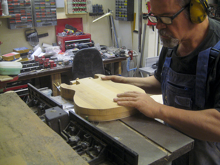

The alder pieces had moved a little during gluing, so I levelled the top and the bottom with a belt sander.
Routing body edges flush with a table router.

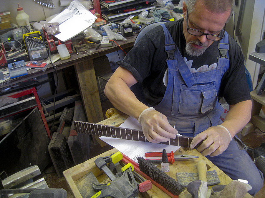

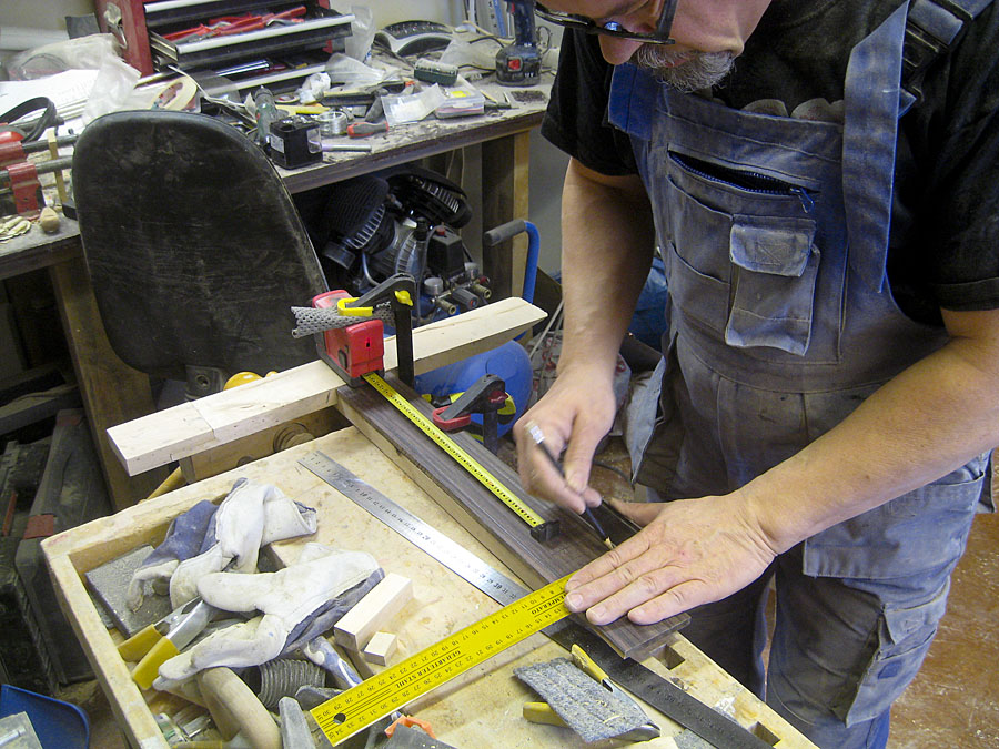

On to the neck then. I had a nice rosewood blank for the fretboard. I started by measuring and marking out the fret positions with a digital measuring tape.
Markku Nyytäjä
Posts: 301
Location: Helsinki, Finland
Re: New build: The Alligatrix Stinger solid body electric
Post by Markku Nyytäjä »

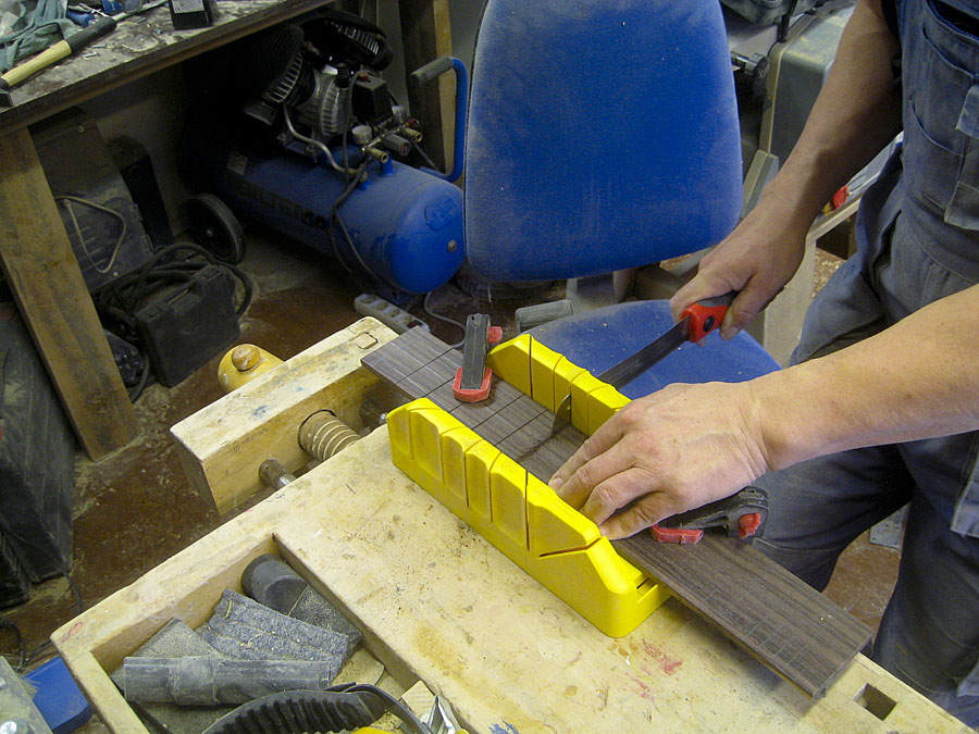

I cut the fret slots using a miter box and a rip saw.

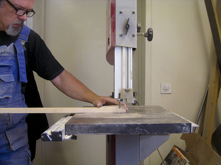

I marked the fretboard outlines with masking tape and cut it out with a band saw.

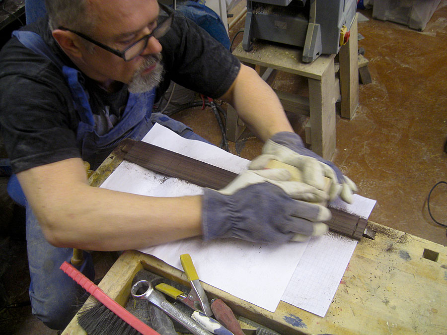

I planed the fretboard edges carefully to level them.

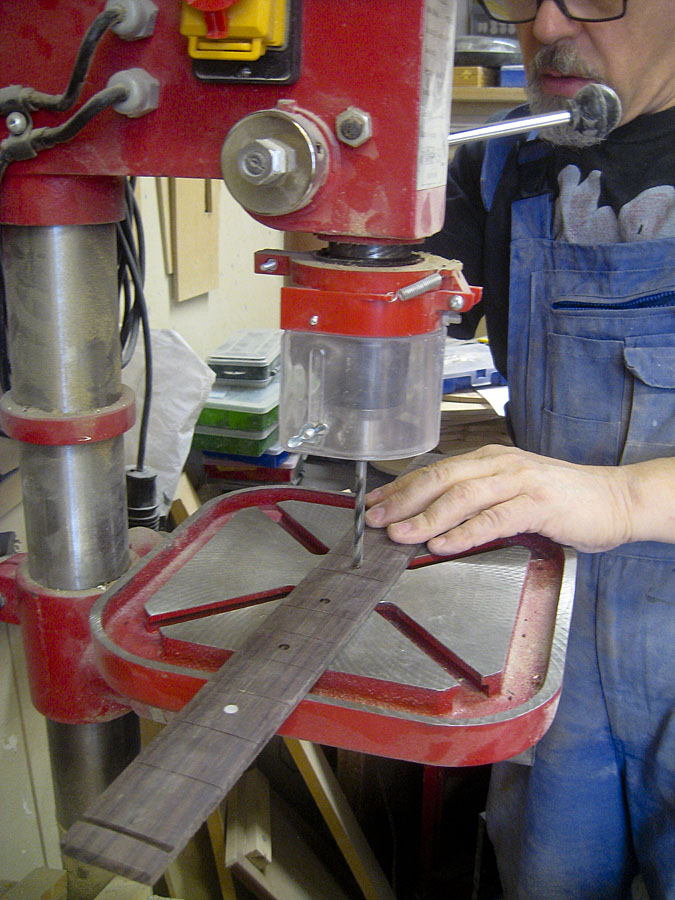

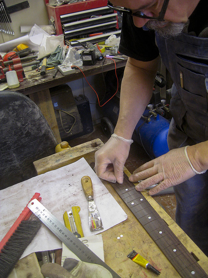

Drilling fret marker pits with a 6 mm brad point drill bit.
Applying CA glue to fret marker pits.
Gluing fret markers into place.

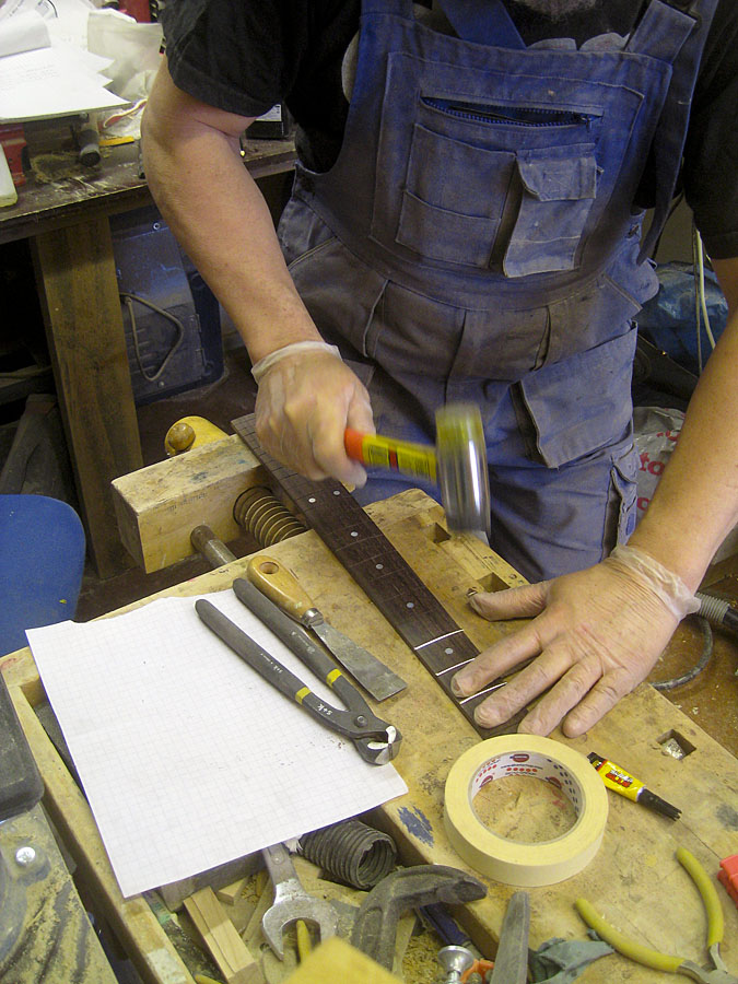

I cut all the frets a little longer than the fretboard width. Then I installed them using CA glue and a plastic hammer. Applying glue here...
...and hammering in frets here.

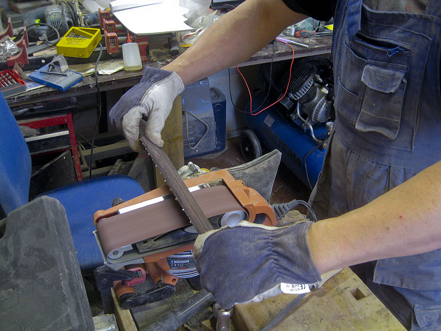

I often use a belt sander with a 150 grit belt to crude dress the frets and a file to finish the work.

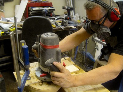

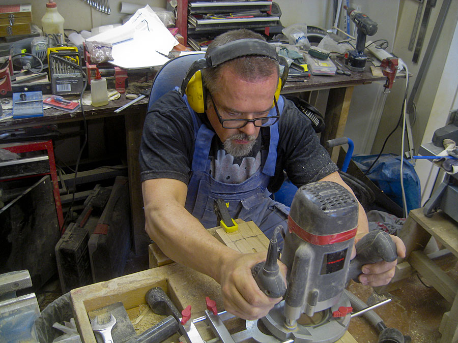

Routing the swimming pool type pickup cavity with a copy router bit and a plywood template. A big cavity may pick up a bit more hum than a snug one, but shielding it carefully helps a lot and I can install any combination of pickups there.

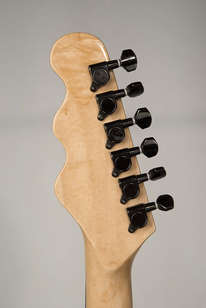

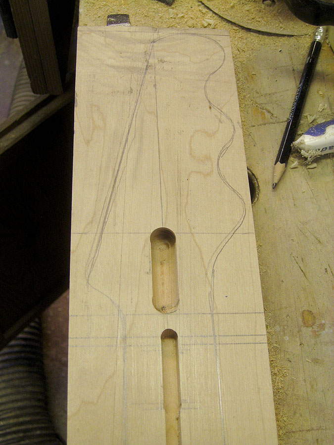

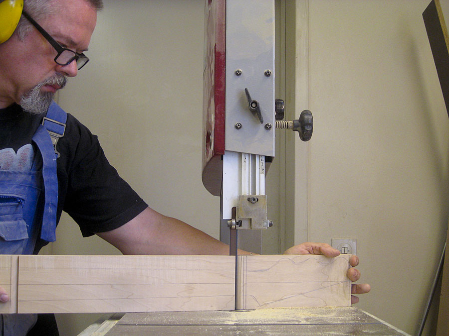

The neck takes a turn. I usually start with preparing a neat flatsawn maple blank for a Fender type neck and routing a truss rod channel in the middle of it. If I have several blanks I rout a truss rod channel in each one of them to save time.
The Alligatrix has a pit for the Allen key.  It facilitates accessing the bullet type nut of the truss rod. I rout the pit with a round tip bit after routing the truss rod channel.

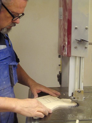

Cutting out the neck from the blank with a band saw. I try to cut as close to the outlines as possible, yet leaving enough extra wood for shaping.

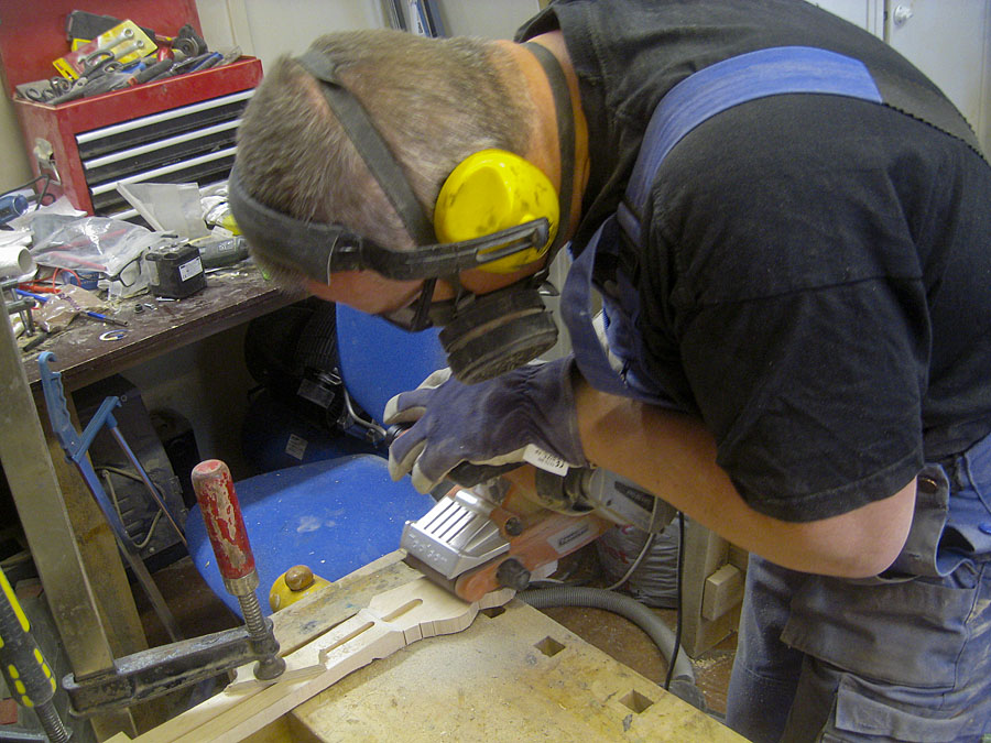

I shape the neck with a belt sander first. Yes, there will be dust, but I have found that this works for me, as I get the shape close to what I want quite quickly. Using a belt sander calls for caution, though. It's very easy to ruin a good neck by sanding too deep.

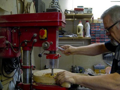

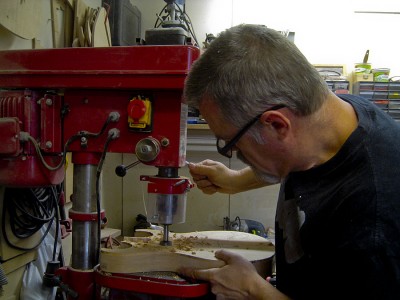

Drilling tuner holes in the headstock with a 10 mm brad point drill bit.

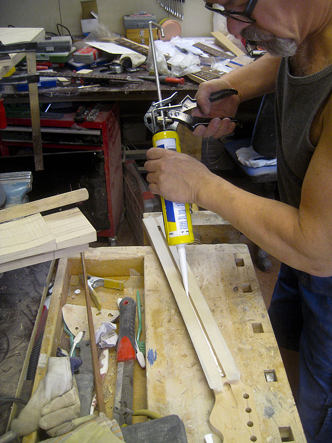

Time to install the one-way truss rod. Squeezing silicone caulk into the rod channel prior to installation to fix the rod and to prevent rattling later. There is masking tape on both sides of the channel to keep the caulk off all surfaces that will be glued later.
