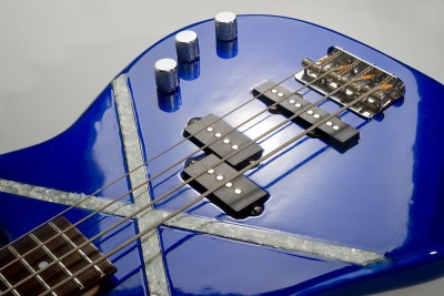

Here are the specs:
Body alder, colour candy blue with white pearloid celluloid cross, acrylic lacquer finish
Bolt-on neck maple 864 mm/34", rosewood fretboard 22 frets, white pearloid fret markers, bone nut, dual-action truss rod, sealed tuners,
Neck pickup Samick PB with ceramic magnet 7.5 kΩ, bridge pickup Samick Jazz bass pickup with ceramic magnet 7.0 kΩ
2 volume pots 250 kΩ, 1 master tone 250 kΩ with 47nF cap, electronics grounded through LifeSaver filter
Vintage style Fender chrome bridge, chrome hardware

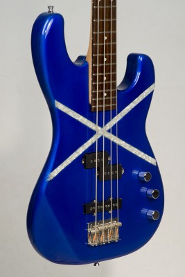

Body from the front...

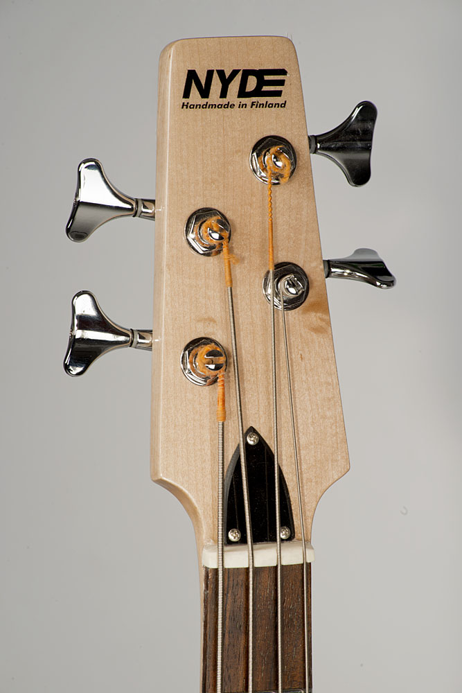

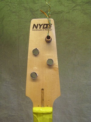

The headstock with 2L2R sealed tuners and my logo

Close-up of the body...

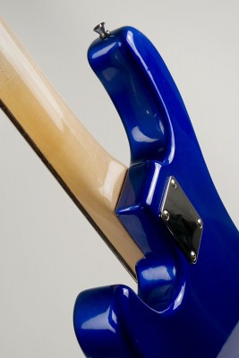

...and the neck joint.

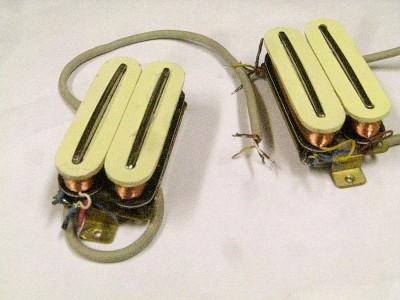

On Tuesday I assembled a pair of humbuckers with coils wound around rail type polepieces. The magnets are 3x5x50 mm neoydymium bar magnets and the coils wound up to 4-4.8 kΩ each. The neck pickup resistance is 8.38 kΩ and the bridge pickup is 9.35 kΩ - traditionally moderate windings. I've used neodymium magnets in my pickups before and grown to like them, as I get high output without overwinding the coils and sacrificing the high end of the sound.
Not being able to fix the coils to the baseplate with screws I glued them in place with silicone paste. The silicone has set by monday, then I can wax the pickups and wind some tape around then coils. I can't wait to install these babes into a new guitar and hear them sing. :D
Newly assembled Bladebuckers, yet to be waxed.

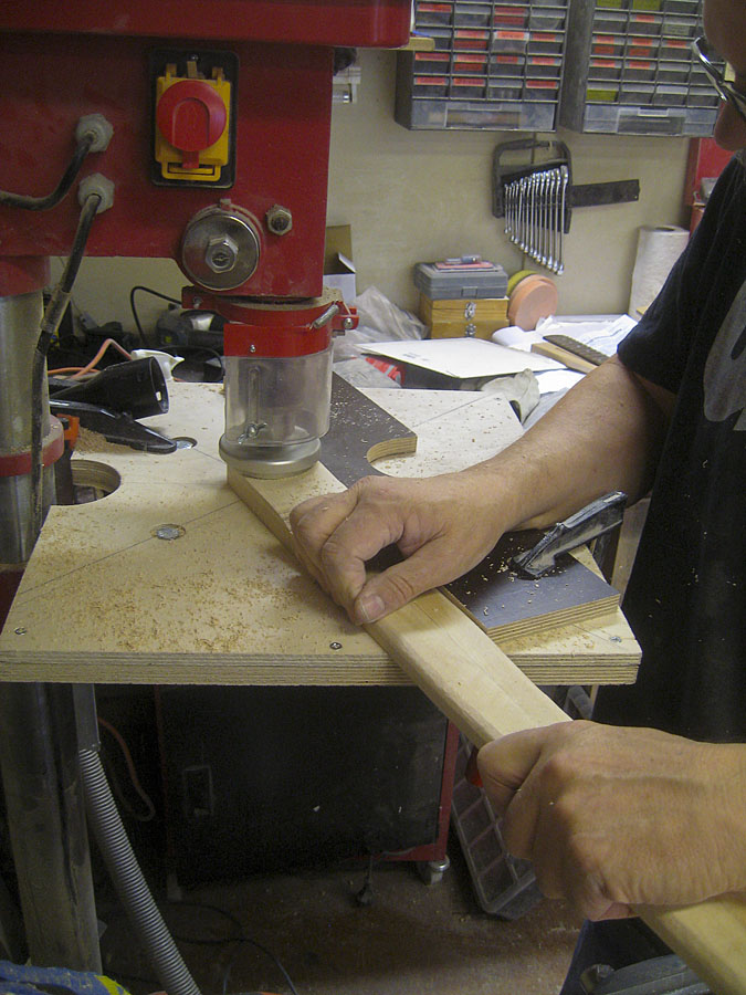

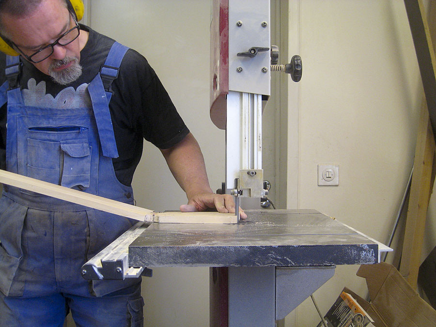

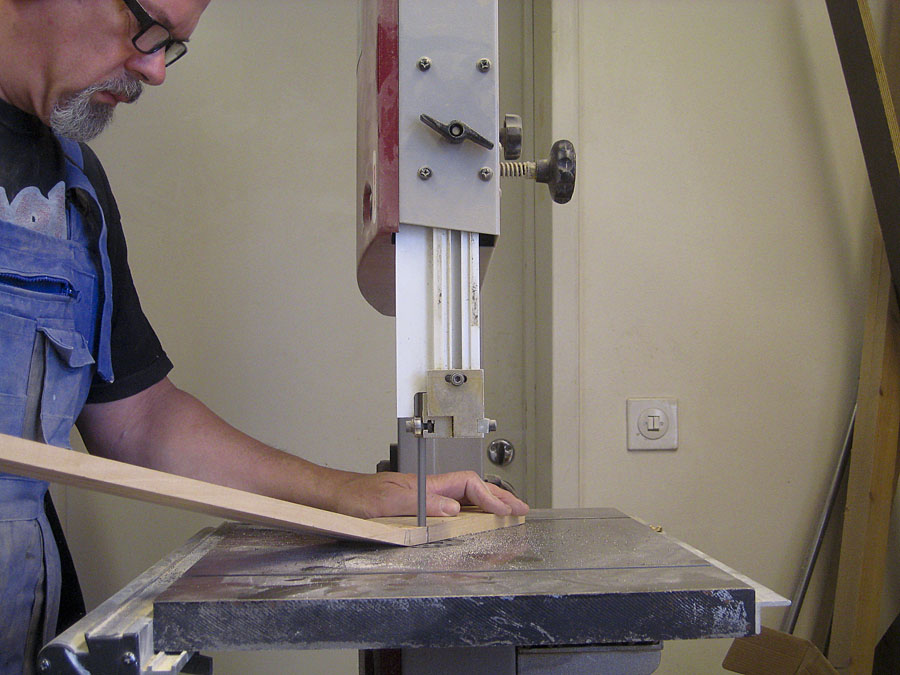

I usually start a build with the neck. This time was no exception. I had a laminated bass neck blank with an angled headstock that I chose to use.
I have never liked using rasps for shaping necks. I prefer sanders and scrapers, like the belt sander here...
...or the sanding drum for more accurate work.

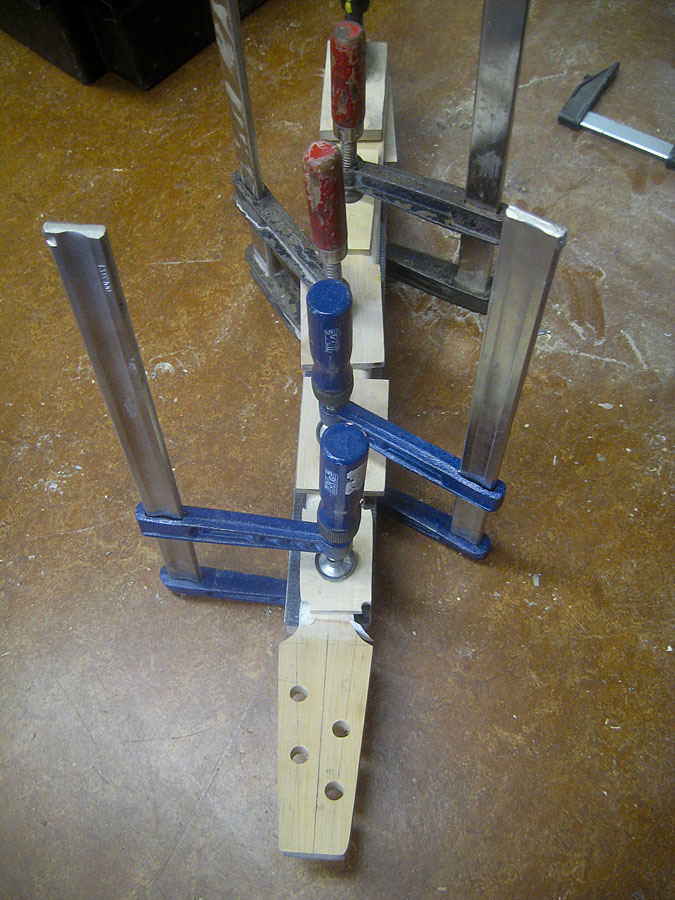

I used my curved caul and several clamps to glue the fretboard into place. The two-way truss rod was secured with silicone paste to prevent rattling.

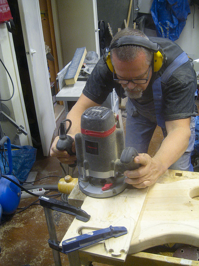

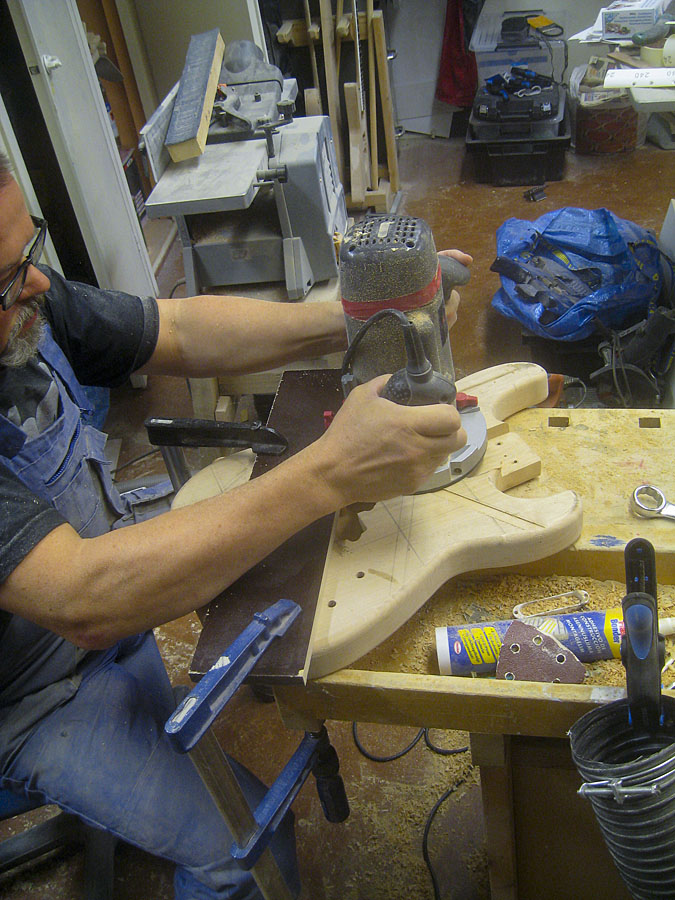

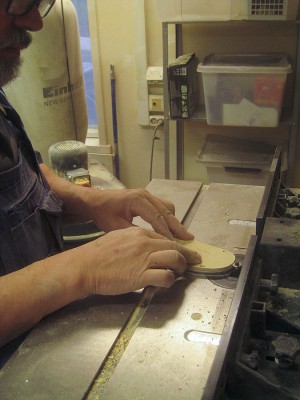

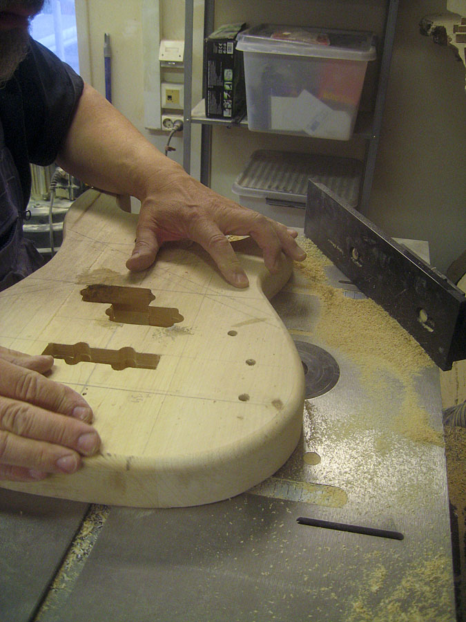

I made a P-Bass body template using a plan I purchased years ago. The body blank was alder, 3 pieces glued together. I cut the body out of the blank with my band saw.

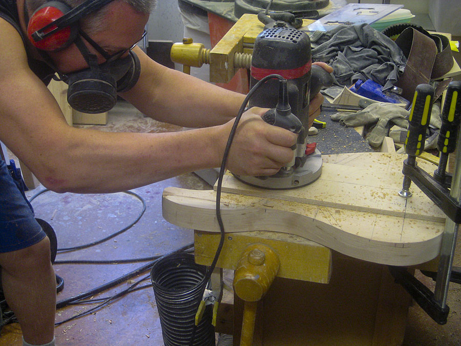

With the template screwed to the body I routed the edges flush using a table router.

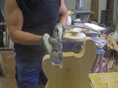

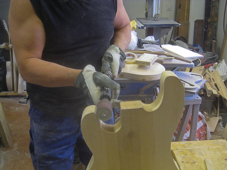

The body edges needed some levelling after the router, so I grabbed my good ole belt sander...
... and the sanding drum for the less accessible parts.

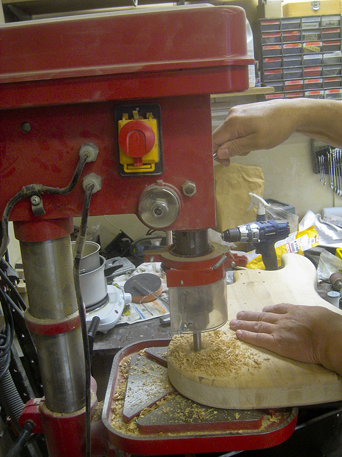

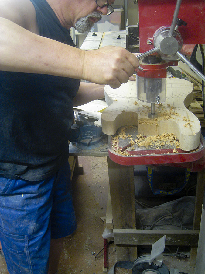

Prior to routing body cavities I remove most of the wood with a forstner bit on a drill press. Neck pocket being drilled.
I have made templates for quite an array of neck heels and tenons. Routing the 17 mm deep neck pocket using a template here.
Here a pickup cavity gets forstnered...
...just to get routed right thereafter.

I used the table router to round off the body edges. First the frontside...
... then the back.
... then the back.
Since I didn't use a pickguard the electronics had to be accessed from the back. First I forstnered the cavity...
... then I routed the rest using a template.

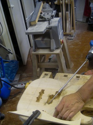

The pickup wire channels between the pickup cavities and the electronics cavity had to be drilled.

The procedure was needed for both pickup wire channels.

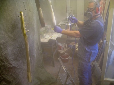

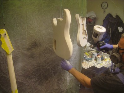

Having found the bass just short of the paint job finished, that's where I proceeded next. I disassembled the instrument and started painting. The first step was a coat of primer, followed by acrylic putty to fill all dents and uneven spots - and then another coat of primer. At the same time another build, the Alligatrix is getting sprayed with primer. The paint job usually takes longer than any other stage of the building process, but it's worth it.
Coat 1.
Coat 1.
Coat 2.
Coat 2.

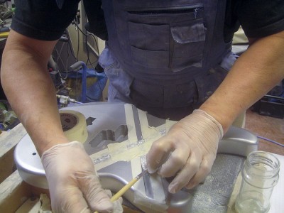

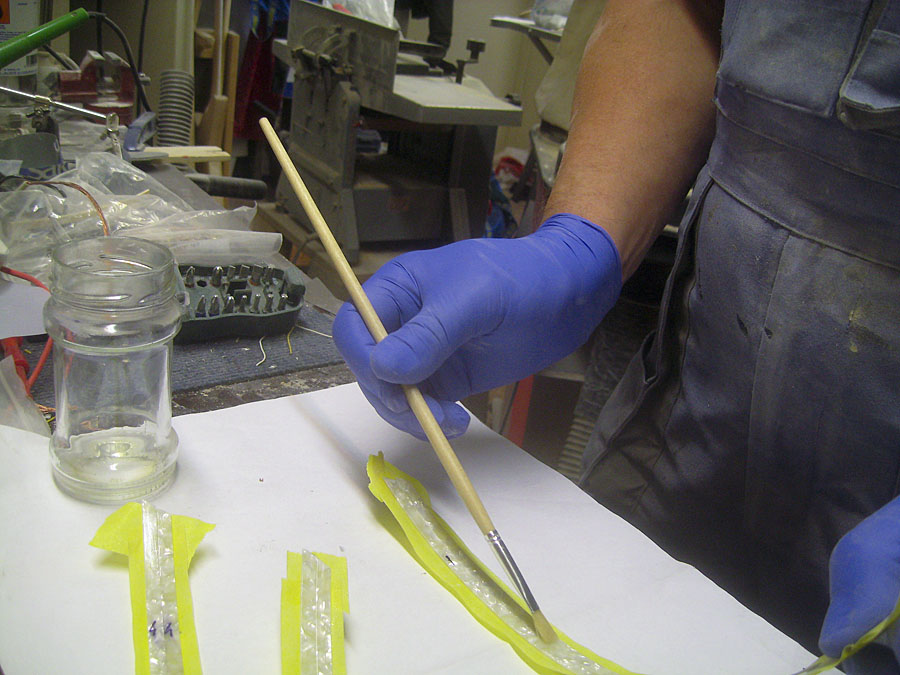

Initially I had thought of making the Saltire cross with 12x24 mm pieces of MOP, but to get an even cross I ended up using celluloid binding instead. As celluloid dissolves in acetone, it's easy to glue strips of binding together. I just taped the strips side by side and applied generous amounts of acetone to them with a narrow artist's brush. The pieces stuck together really nicely. After spraying the body with silver paint I waited for the paint to dry and glued then cross to into the channels with acetone, securing it with masking tape and clamps.
Glueing strips of celluloid binding together.
Spraying silver paint made with silver powder and 2-component clearcoat diluted in a 1:1 ratio with thinner. I use 1 tbsp of silver powder to 250 millilitres of lacquer and spray it with a 6 bar pressure, keeping the spray gun in a constant whirling motion to prevent the silver from setting at the bottom of the container.
When the silver paint was dry, I glued the celluloid cross into place and masked it with 12 mm wide masking tape before spraying another coat of silver to hide any acetone residue and uneven spots.

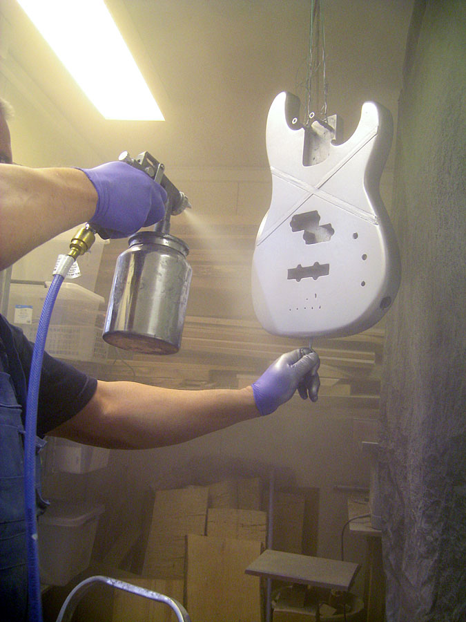

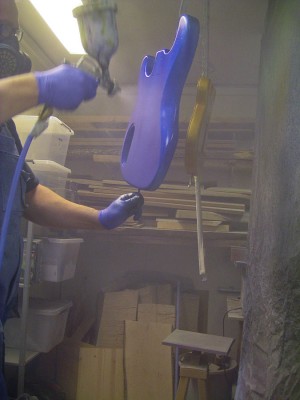

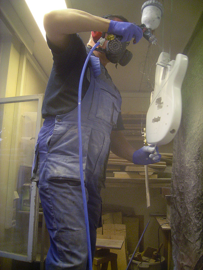

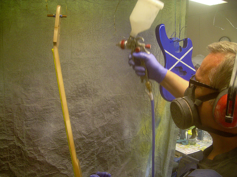

The silver paint is half thinner and it dries very quickly, so I could move on to spraying the transparent blue tint. I use the Color Tone liquid tints from StewMac. It took me long time to find good transparent tints and now I'm sticking to these ones. They dissolve almost in any solvent, give a beautifully transparent and even tone and are easy to apply directly on wood with a rag diluted with water or sprayed mixed with thinner and 20% clearcoat.
I'll make you blue.
I'll make you blue.

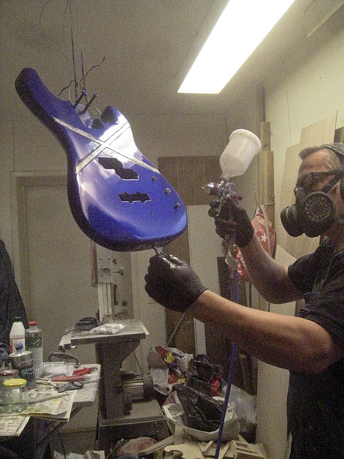

The transparent tint dries almost immediately and I can proceed to clearcoat right after spraying the tint. I use different spray guns for primer, metallics, tint and clearcoat, so the tint gets to dry before I have mixed the lacquer and set up the spray gun. Now I usually start finishing the neck as well, giving it the first layer of clearcoat.
Spraying clearcoat.
Spraying clearcoat.
After spraying a coat of clear lacquer I let it cure overnight and wet sand it with 800 & 1200 grit papers, both by hand and machine.

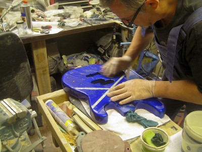

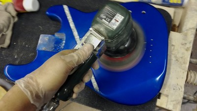

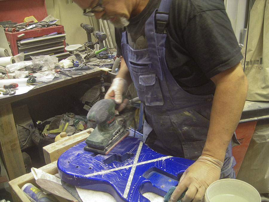

The final wet sanding was done with 800, 1200, 1500, 2000 and 2500 grit papers. The lacquer was then polished to a mirrorlike shine with a compressed air driven random orbital sander, a polishing sponge and Farécla compounds. The tricky parts were polished with a buffer wheel attached to a drill extension. First I buffed the neck an the body three times with Farécla grade 3 paste and then twice with grade 10 polish, wiping the dry residue off with a micro fibre cloth as I went on.

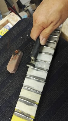

I also polished the frets with a Dremel-type grinder, a felt buffer wheel and polishing wax.
Polishing the body. Of course I had forgotten my workshop camera at home when I finished the bass, so the images here are taken with my telephone.
Polishing frets.
Polishing frets.

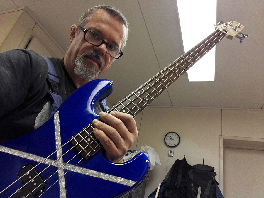

As I couldn't have a camera on a tripod and self timer and as I needed my both hands to assemble the bass I don't have any pictures of the final lap. I suppose you all know how it looks when a neck is rigged with machine heads and attached to the body with screws or how installing pickups looks like. If not, you'll just have to imagine it all. ;)
Anyway, I did finish the bass around 10.00 PM and was home before midnight. And there was still another week to the birthday party. Phew!
Finished!
Finished!
The next day at home I finally heard the tone through a 40W bass amp. Nice!
