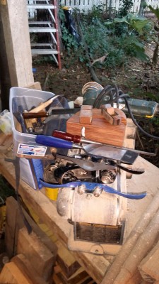

I have accumulated a lot of tools over the years and show here ones I have used this past year learning to make guitars.
Hope the picture post properly.

Your picture posted, but I can't, for the life of me. figure out what it is you want us to see in it.

I will be at a desktop soon and continue with what I learned. Pic was from cell and I can't read it well.

A couple of planes, a draw-knife, a chisel, a saw and an angle grinder. I might use all of those in a typical day in the shop... :)

So I started building guitars with a lot of tools and little space for new ones. The little straight carving knife is a real sleeper. I found endless places it could be used to finish a task or solve a problem. Years ago in a class I found carvers have several of different length and shape for different applications. Easy to keep razor sharp. Cost $10-15.
The belt sander can be made into a power carver by installing 40 grit paper. I take sides down to 1/8" on the thickness planer and then the rest of the way on it. I have no room for a drum sander. It works on sapele, walnut cherry and hard maple, but I don't know how to handle harder stuff.
I made a bunch of small wooden hand planes years ago but most are still too big to be of much use. I plan to make more soon with 1/4-1/2" blades and about 2" long or even less. I used scrapes of santos rosewood for several and planned to open the throat as needed. But the wood is so hard that is difficult.
I have 5-6 spoke shaves I have picked up over the years and find many uses for them.
The band saw(not shown here) is useful for everything. Must have.
