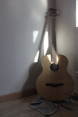

Despite being a member here for nearly 20 years, Yikes! - I've never posted my instruments,
so felt it was high time I did so. here is an Acoustic bass I made last year.
Specs are
Acoustic Bass Cocobolo/Englemann spruce

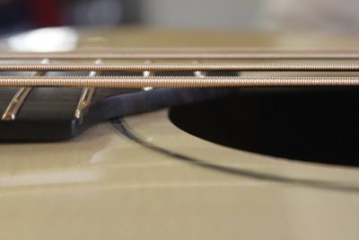

Custom designed and crafted for maximum volume and comfort - this bass features Manzer inspired wedge shaped body and a side port soundhole. The neck is made up of 2 different types of mahogany and maple for maximum stiffness and light weight.
Macassar Ebony fingerboard. Scale length is 32" . Body is based of a J200 so 18" wide.
The depth of the side where the forearm crosses over is just under 90mm wide. It was very difficult to make and caused quite a a lot of stress. The neck joint is glued in Mortise, but is designed to cantilever over the top - I used a well seasoned ebony board.
Finish is French Polish with an Oil slurry grain fill which worked quite well = Cocobolo seems to have less massive pores than other species of Rosewood.
Bracing is Adirondack spruce - quite a wide splay X, with 3 fan braces interlocked over alaminated maple and wenge bridge patch. I left the sides intentionally thin. The top came out roughly 3.4mm thick, but of course this information on its own is not that useful - I thinned the edges somewhat.
Top is 25ft radius and the back is nominally 12ft, slightly exagerrated on the treble side due to the wedge.

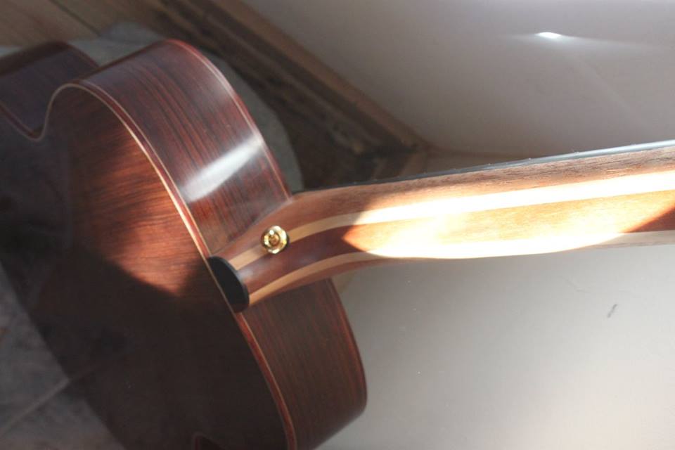

I would really love to experiement with a Rick Turner style neck joint but do not have the skills to figure his system out.
All the best everyone,
Joseph

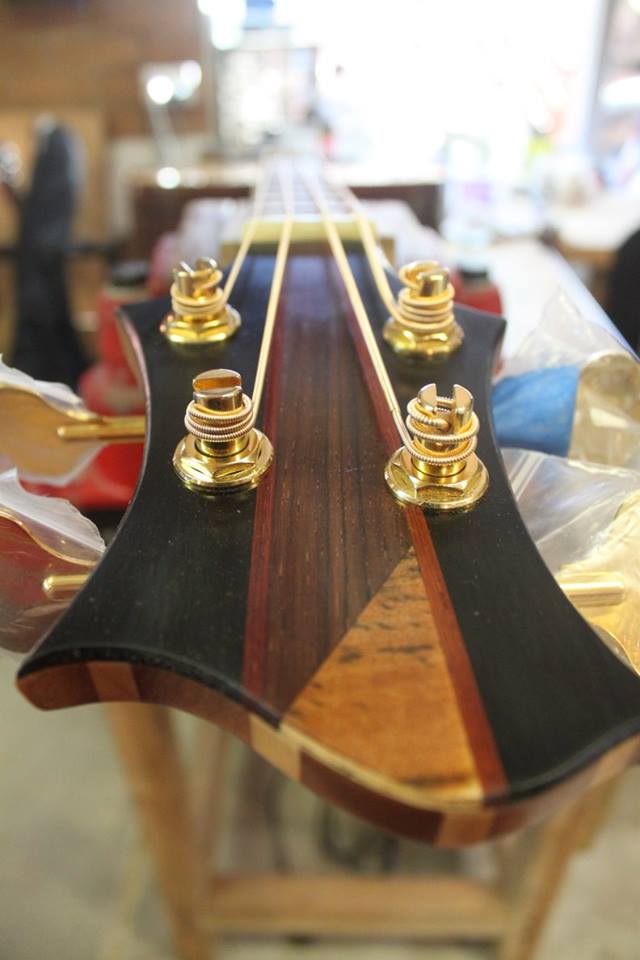

That is indeed a beauty, especially in its details. The headstock design is striking - after a few minutes spent looking at it, it occurred to me that what I first thought of as a contrasting triangle of veneer in the headstock might better be described as a wedge.... getting slow in my old age.

I love the shape of the body.

Thanks JC. The endgraft is same design as headstock and I made a heel cap and feature on the rear of the body in the same vein.
I like inlay in wood. Sorry about poor quality photos

Beautiful! I love the headstock. How does it sound?

Very nice !!! I'd really like to hear that.

Thanks Guys - well its louder acoustically than the Martin basses i have worked on - that was my goal.
The sides are doubled in the upper bout. They are also stiffened with Adirondack side braces in the lower bout.
The back I made stiff and "non-active" - I felt it was safer as it was my first time making this design.
There are no dead spots on the neck - which despite being pretty slim Depth is very stiff on its own. I was
a little wary about going full 34" scale so went 32" with a steep headstock angle - which I usually prefer on acoustic guitars.
The fingerboard was from LMII and I was extremely pleased with the quality. I kept it for over a year in my workshop and brought it down in stages to minimise post build movement. I relieved it on the underside of the board which is catilevered over the top.
I still made a full width UTB but stopped it short of the edges and didn't add feet into the sides - hopefully a little more vibration in the upper bout than normal, but again, that is just supposition. I would REALLY LIKE to try the Rick Turner Joint and we are friends - from this forum decades ago! - bu I fear asking him may be "pushing the friendship" - and I am nowhere near clever enough to make something like this myself
I have some basic phone video of it - Am I allowed to post it here?

Do any of you guys know a sure fire place to buy the hardware used in Rick Turners neck joint?
I think that would be superior to my mortise and tenon glued in joint in the long term.
