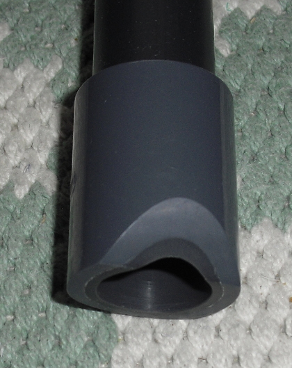

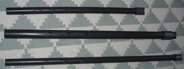

Lately I've been intrigued by making flutes, in particular the shakuhachi, due to it's simplicity on one side, but it's complexity to master it.
Furthermore being a science teacher I'm always on the lookout for cool educational projects, and (the science of) flutemaking has a lot to offer!
What I think is cool is that making a simple flute is as easy as it gets (In the Netherlands it's even a saying when something is easy to : "It's like making a flute of a cent", similar to "a piece of cake").
Just drlll some holes in a pipe, making it either a side blown flute (be drilling an extra hole as a blowhole), or endblown by cutting, carving or sanding a sharp edge on the side.
On the other hand, calculating the right spot were to drill the holes involves some hardcore sience, which even led to a PHD-research to create a mathematical model.
Last but not least studies show that the material of which a flute is made isn't really affecting the tone quality. So a well made flute from a commonly available material would yield a good sounding instrument. I've used PVC water tubing (mostly 1 inch outer diameter), because this is commonly available in Europe (but I think in most parts of the world) and used the model which was presented in the research.
I noticed that using a wood drill works the best.
Now I've got the hang of it I can easily build a flute under one hour, including wetsanding everything.
I use a coupler with a piece of pipe glued in for the mouthpiece, making it interchangeable with other flutes. It's not a new concept because there's a lot of information on the internet, but I thought it was nice to share at.
It makes a great educational project / (grant)parent-child project or an easy way to experiment with playing flute.

I have built a lot of PVC flutes, and they are a lot of fun. How do you make such a nice, clean notch on the end? That is the key to shakuhachis. Did you color the pipe, or did it come that way? Almost all plumbing pipe in the US is white with printed markings all over it.

The color is dark blue here in the Netherlands, when it is used for clean water. They use a lighter grayish blue for sewer pipe.
It has printed markings on them but I (wet) sand them of.
As for the notch: I make an approximate 30 degrees cut with a hacksaw and then sand it flat with 240 dry and 320, 500 and 800 wet.
I lay the sandpaper on my kitchen desktop and move the mouthpiece angled back and forth.
As you probably noticed, the mouthpiece is made out of a coupler with a piece of pipe glued on the side were notch is.
This gives the mouthpiece a thicker rim. Although it's slightly more comfortable with a coupler, creating a notch with only the pipe works fine also.
What kind of flutes did you make?
Hans

I've heard that traditional shakuhachi makers weren't that much bothered by exact tuning, they more less made holes at certain distances and fine tuned while playing (which is easily done with a shakuhachi mouthpiece).
After some tweaking to find the right mouthhole correction, the model presented by Nederveen seems pretty accurate, I simply mark the holes, drill them to size, sand the burr of and done... I've used it for several bore diameters and flute lengths.

No I haven't tried to make double finger accidentals. I've only made minor pentantonic, major scale (and one major pentatonic) tuned flutes.
Some notes on the shakuhachi are played with double fingerings, but always require some adjustments while blowing the tone.
From what I understand that there is always a trade-off and even the best flutes require some fine tuning adjustments from the player while playing.
If you're interested: Nederveen discusses how to use his model for double fingering, but from what I recall he uses a "accidental" hole which he only opens and closes in combination with other holes.
BTW, I've also mounted an alto saxophone mouthpiece on a piece of tube, and it sounded pretty cool. For now I discarded this track, due too lack of time, but it is cool to invest it later on.
