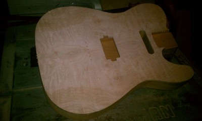

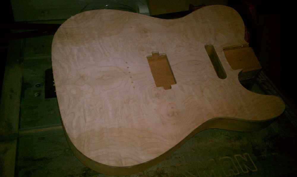

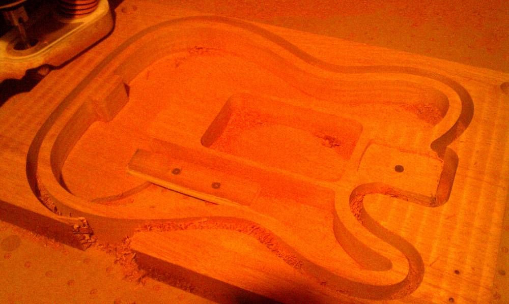

Here's the chambering pattern that I used on my last thinline style tele... note that mine has a rear routed control cavity and is not a true thin line... more of a chambered guitar.

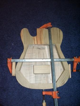

Here's what I did on a challenge a while back...
(edit)Top was about 3/32" thick and the back was about 1/4".

I might have just been the lighting, but that looks like pressure treated lumber. If it's PT, did you have any issues gluing it?Rodger Knox wrote:Here's what I did on a challenge a while back...

I don't think it was pressure treated, it was cut from an old pine 2x12 that was in the basement of the house when we moved in. Not material I would normally use, but this was the first $100Tele challenge and salvaged wood was almost a necessity. I didn't have any trouble glueing it, Titebond original and clamp as tight as possible. There's no direct interior connection between the neck block and the bridge, all the string pressure is carried by the top, back, and sides. I've built one with 1/4" thick maple tops and no block under the bridge, and it's still fine.
