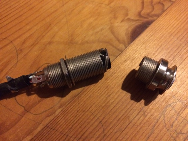

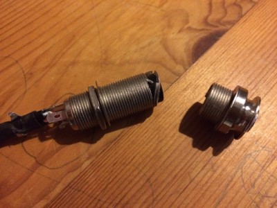

"Jack-less"? Is that a word?... In any case, I have always and reflexively used an endpin jack with my tailpieces. Until that is one failed spectacularly. The cheap mystery pot metal from China just snapped at the weak spot where the plastic sleeve inside ends and its just a tiny amount of metal holding everything together. I've decided having a jack in the back is just not a great solution anyway and moved the jack to the treble rim like most Gibson Archtops have. That left me with the question of what to put in its place to hold the tailpiece.

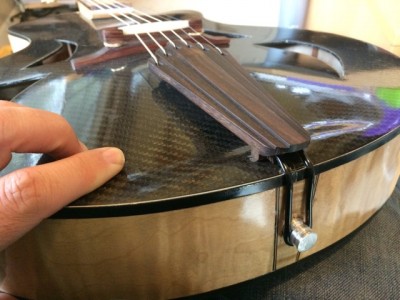

For now I just shoved a piece of 1/2" Aluminum rod to hold everything together. But of course now I'm nervous about what I should get to replace it that will be strong enough to hold up to the tailpiece pulling on it. I have seen the "No Jack" retrofits:

After having the heart stopping experience of having what sounded like an explosion in my lap when this thing broke, everything looks suspect. I need a solution for this guitar and future guitars. Can't have this happen on a guitar I sell. That normal ebony pin seems very small suddenly.

As far as I know, end pin jacks are designed for straps to support the weight of the guitar, not for anchoring tailpieces, which have a hundred times the pull. I have never had an end pin jack fail, but I also do not have any where the jack supports a tailpiece, and all my end jacks are high quality to begin with.
I suspect your problem is mostly due to using cheap, knock off parts. The end jack is a vital part of the electronics - it is just not a good place to skimp to save a couple dollars. It is supposed to last for the lifetime of the instrument. Get the best quality end jack you can find, even if you don't use it to attach the tailpiece.

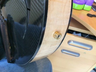

I personally buy my endpin jacks from StewMac, but perhaps you know of a better source? Regardless, I have decided that I do not want to use the endpin jack for this purpose. I do not think the current ones are being made with this use in mind and I don't want to take the risk of another one failing. As I mentioned in my OP, if I want a jack I will now place the jack on the body as a show in the second picture and not expect it to perform a double duty.

I have been using 1/4-20 hex flat head furniture bolts for neck attachment and strap buttons. With your modern looking CF top, I think a piece of industrial looking hardware would fit.
