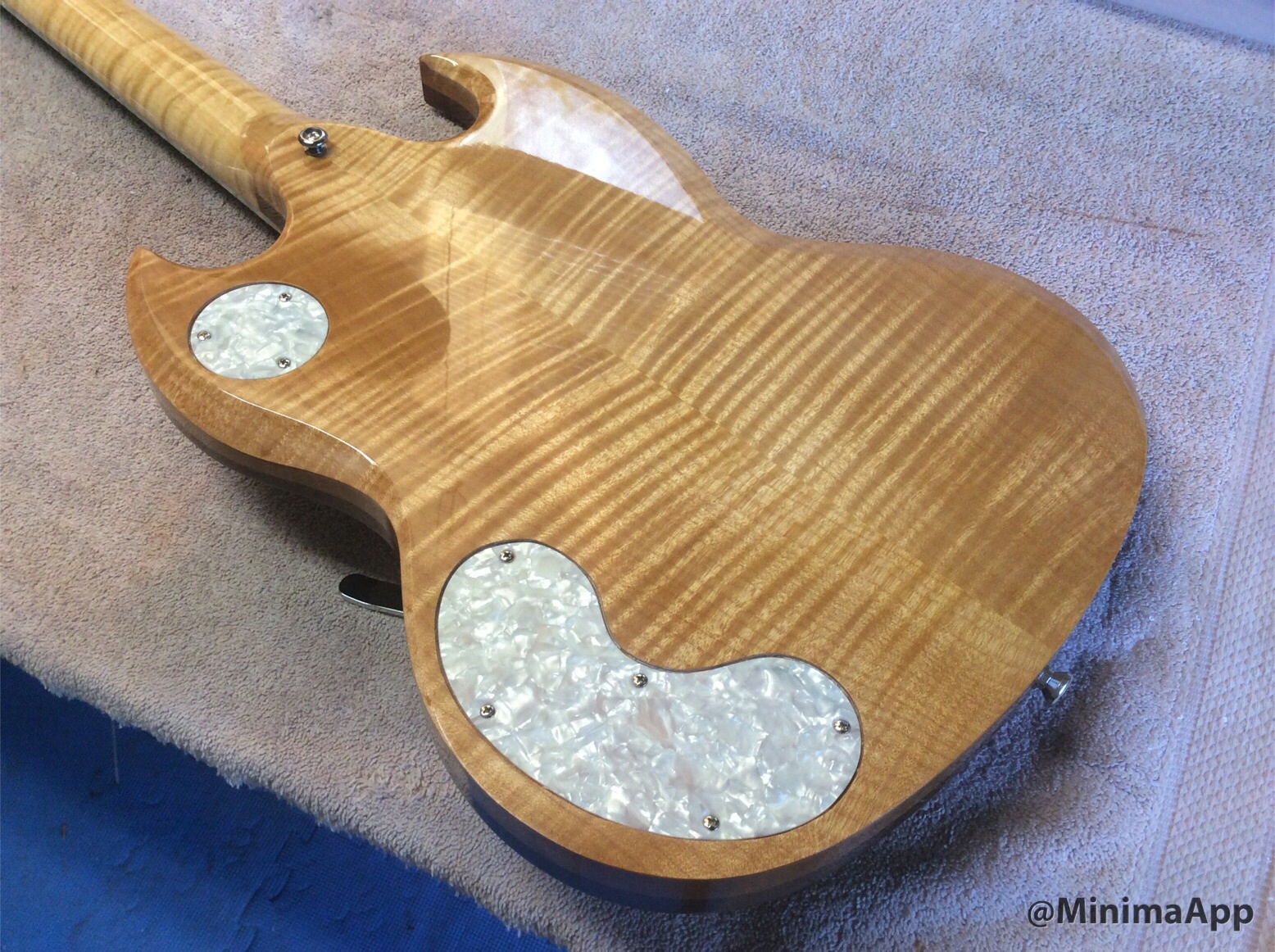

I'm just curious why you would but that beautiful veneer on the back
Re: Veneer project
It's on the top too, Pete.Pete Halliday wrote:I'm just curious why you would but that beautiful veneer on the back

I like to pimp-out the back sometimes.

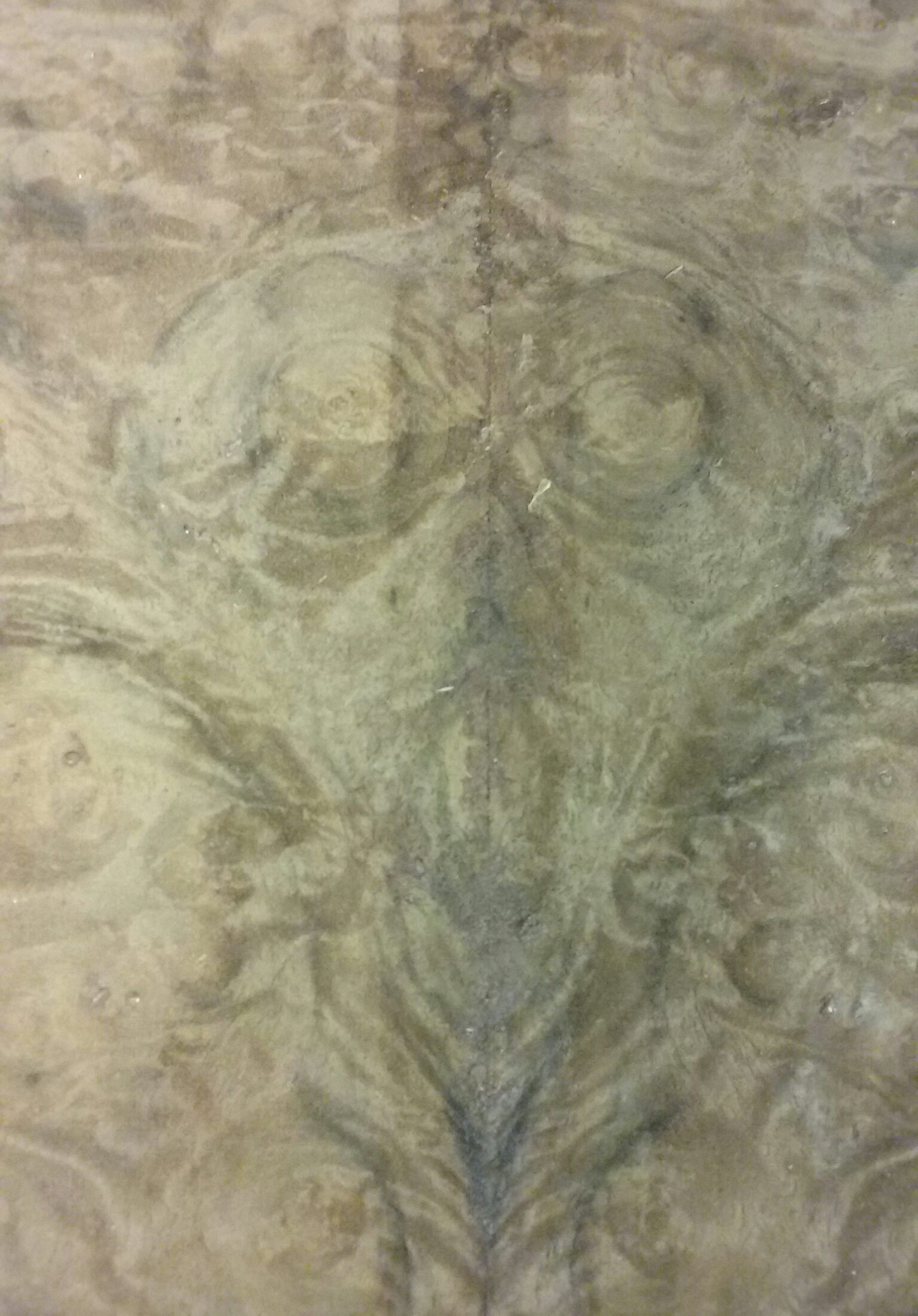

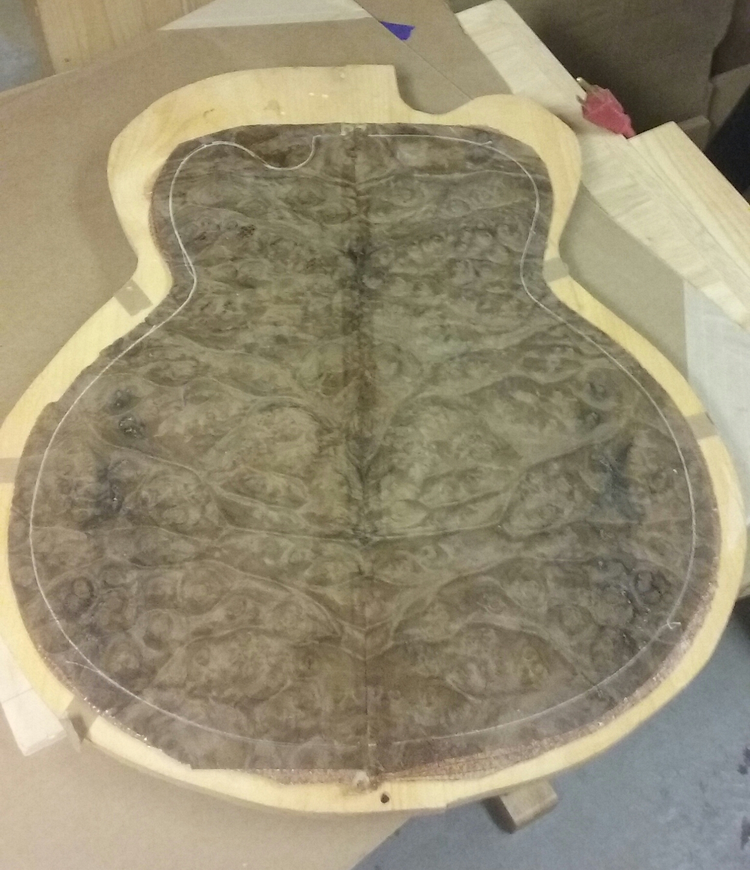

Yes...you can get some beautiful woods from Joe's place. I've been doing some laminate archtops ...three ply maple/wood backer so six ply and finally a nice outer figured whatever. This batch is all burl walnut...just for a change..something different. I built a vacuum frame press ...directions at his site...which is so much easier than fighting with the bag press. Anyway...it's just another tool to add to bag of tricks...and the archtops can be a little tricky. I've found the easiest method is to take a app 3/32 slice (relief)out of the lower bout on the inner layers...and sand the seam away from each other about 1/16th" on the lower bout on the outside wood veneer...a little tricky...but it works.
- Posts: 33
- Joined: Fri Jan 20, 2012 9:44 pm
Re: Veneer project
and ...you can find some very interesting images in the wood...just in time for Halloween...a blast from the past ...a little "ET" action

I've watched a video for veneering an arch-top solid-bodied guitar, which demonstrate the method for fitting the veneer joint as Chris describes. One thing that I'm a little unclear on is whether you use veneer tape after the two veneer sheets are fitted. In the absence of any advice to the contrary, I'd be inclined to do so just to avoid all the cussin' I'm sure I'd be doing trying to keep everything lined up as the vacuum bag settles onto the top!

I have posted my methods here before which is similar to Chris's. I cut a 1/2" wide wedge out of the bottom of the veneer and use veneer tape to pull it together before placing in my vacuum bag. The veneer tape is the only way to ensure that the joint is properly closed.

half inch wedge Barry? Wow...that's adventurous! I take anywhere up to 1/8"...and I suppose you have to take into account...how much relief you need from the veneer crimping and wrinkling etc. based on your mold. I leave the lower bout seam taped (not across...and only with the seam tape) loose fitted...and if it does overlap a tad...well...it's faux seamed itself!
Yes Steve I use both the seam tape the entire length of the veneer ...and the blue tape across the veneer as instructed from online vids...but I leave the last 4-5 inches or so between the bridge and tailblock just the seam tape to allow the face veneer to do its thing.

Right, the amount of the wedge should be customized to your mold. Mine had about a half inch of rise and the half inch wedge seemed to be about right. I like using the traditional paper veneer tape along the seam, which holds the joint very tightly.

I did tape on the inside and outside. It was the seam tape with holes in it so that the glue gets in there. That worked well. I followed the fitting method of that fellow on ebay who was putting an ebony veneer onto an arch top piece of spruce I believe.

I try to keep the tape out of the inside so that it doesn't telegraph through the final plate. Veneer tape on the outside can be easily scraped off after curing.
