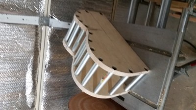

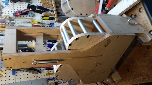

got the bending form made and pics of it in my fox bender. Will work on the slats and springs.
