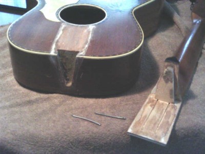

I need to reset the neck on an old Stromber-Voisinet that has a faux pearl fretboard. Someone has driven two nails into the heel in an attempt to fix the action. :roll:
Usually when releasing the extension I will place a couple of cabinet scrapers along side the extension to protect the top and one on top of the extension. Then I place a clothes iron on the extension to heat it up.
I'm concerned that this might heat up the faux pearl and release it causing a mess I'd rather not deal with.
Has anyone done one of these fretboards? Any suggestions on how I might proceed?

I just wanted to thank everyone for the tips. Especially Michael since the hot knives technique really worked great. I have a couple of artists pallette knives that are very thin and great for that procedure. The extension came off very clean with no damage at all to the top or fretboard.
The toughest part was removing the nails and I cursed the stupidity of using nails on a guitar neck. See the pic and look for the nails.
thanks

Hi All ... I've removed many of these catalog guitar necks over the years. With a birch body and dry hide glue, I find I can just work a smooth, rounded spatula under the extension w/o heat or any liquid. Works on spruce tops too, but you'll need to be a bit more careful.
Often the neck will come out dry, too, with a bit of wiggling. Did you use steam on this? Looks like it may have come out dry.
I once had a string of 8 necks in a row that popped out dry, including a 20s Martin! I always check that first, before I go to steam, especially on the old factory guitars.
Tom
Yes Tom it came out dry. I've done a couple like this too. The glue is dry and brittle. A little bit of wiggle and it pops right out.
I like it when I don't have to use steam.

Hey Tom you are right about the poplar neck and dyed bridge (the fretboard is faux pearl) but Chris is right that the body is all solid mahogany. I know that many of these were birch as you said but this one is not.
I just love the sound of an all mahogany guitar which is why I bought this one.
FYI the neck reset went well (3/32) and it plays and sounds nice. I only wish it had a rosewood fretboard. the fake pearl just seems cheap to me.

Thanks, Michael, I see the mahogany now in your first picture. Tom
