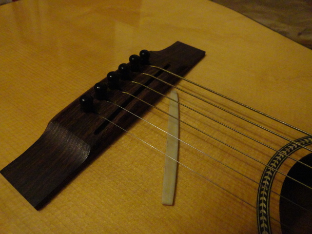

that can be done. but first can you give us your measurements and explain to us exactly how you arrived at those numbers? You may have measured accurately, but were using the wrong numbers. there's a pretty common error that many first time builders make concerning the scale and placing the bridge, which I kind of suspect may be the problem here.
are you saying that you took the saddle out and with the string just between the nut and the pin it's still off about 10 cents? is it still sharp? or is it now flat?
I'd like to see a picture of your bridge if you can get one up.

OK, here's formula I used to position the bridge.
Measure distance from nut to 12th fret = a
Compensation amount = .10"
2a + c = length from nut to saddle at high E string.
2(12.67) + .10 = 25.46"
When I take saddle out, it's less out-of-tune, but all strings are about 10cents sharp, when any corresponding fret is depressed.
My action is high, so that indeed may be part of the cause.

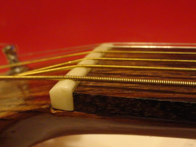

If your measurement from the bridge side of the nut to the middle of the 12th fret is 12.67", that would give a scale length of 25.34". Is that how you laid out the fret board? You can check out distances to other frets using a calculator such as this one: https://www.stewmac.com/FretCalculator
It looks like your strings might not be coming off the nut where it joins the fret board, but somewhere toward the middle of the nut, which could be causing the problem, in essence placing all the frets too close to the saddle. You need to ramp the nut slots down toward the tuners so the strings contact the nut where the fret board starts.
- Posts: 3251
Re: Newly Built: fretted notes are all sharp...........nut adjustment?
Yep, your nut is the problem. Also, you strings look a bit old. Also, what's up with the E string? There is no break angle. Are you wrapping the string windings up? They should go down.
- Posts: 1309
What Peter said: in essence you've compensated the nut, only backwards. Even with it in the 'right' place you could well find note that were sharp at the first fret by as much as a five cents or more. They tend to go sharper above that. Nut compensation involves moving the nut forward; shortening the distance from the nut to the frets. This causes them to all play a bit flatter than they would have by the same amount in terms of cents, at least in theory. This gets the first fret note right. Then you shift the saddle back to get the 12th fret note right, and, again in theory, all the notes will be pretty close to in tune. "In theory there is no difference between theory and practice, but in practice there is". Still it helps.
Okay, yes the nut is compensated backwards. But let's not forget that he has the same problem when playing with a capo. The nut is not involved in the equation at that point anymore. So it's both. I think the saddle is the bigger problem here since the nut can be replaced or filled and reslotted.

I'd make a new nut, and get the action down at the nut and saddle. Then recheck intonation before moving the saddle.

Super feedback. I suspected my nut shape was incorrect.....now it's confirmed.
Will re-shape and lower nut, lower saddle, then check intonation. I'm hoping to avoid moving saddle - that could be awkward! But will if I have to

I don't agree with setting bridge position by simply measuring - unless you have experience with your exact setup, string gauge and action height so you are basically exactly duplicating a proven installation. I would do this, in this order - first capo at first fret and set the intonation at the 13th fret correctly using a temporary saddle on the first and sixth strings, using corrected action height. In other words, get the thing in tune on those two strings with bits of wood resting on top of the existing bridge. This will tell you two things - first, it will give you an idea where the new saddle needs to be, and you will be able to judge if a new bridge needs to be made, if you can fill and rout a new saddle slot, make some offset saddle, etc. Also, it will tell you if the fret board is right. If it plays in tune at the capo'd 13th fret, it should play in tune all up and down the fretboard if the frets are in the right place. Second, I would make a new nut and start the setup process - set nut action height perfectly, establish and install the new saddle, set action height to 1/16" high E and 3/32" low E as a starting point, and see what you have. In other words, prove what you have "can" work, then make it work.
