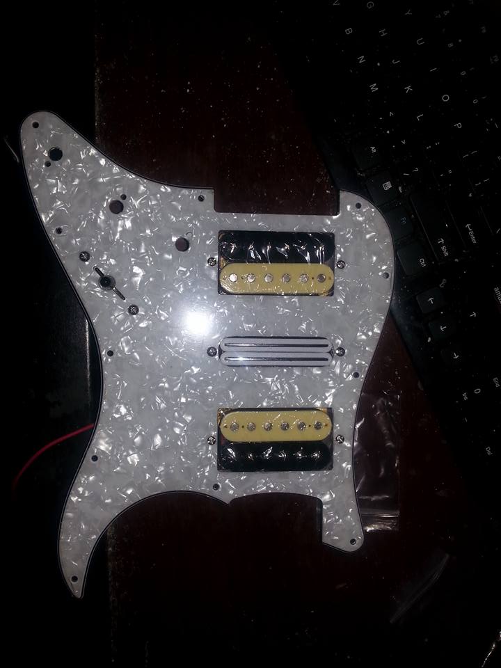

Any suggestions or links to something for how to wire this layout would be greatly appreciated. I have attached images of the pick guard with the pickups in it for visual. I have not put the pots in yet.

Here's one option: http://d2pzqzfqz0w13y.cloudfront.net/wp ... _1V_2T.jpg
The diagram shows colors for Duncan pickups, which are different than yours. Connect the hot leads from your bridge and neck pups to the 1st and 3rd lugs of the switch as shown; connect the white lead of the middle pup to the 2nd lug, and tape off the red and green leads (soldered together). Connect the bare and black/shield leads to ground.
It's basically the same as single coil wiring - you just have to choose the correct leads for the middle pup.
I assume you know you may need to re-route the pickup cavities in the guitar, unless it has a swimming pool route (for all humbuckers) already.

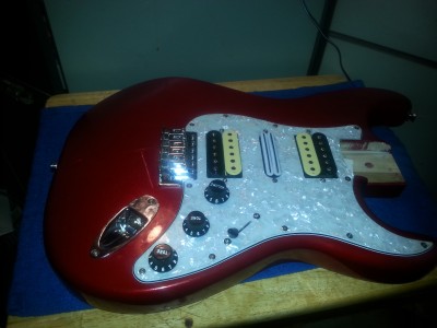

I have it put together and the pickups are appear to be working correctly. Testing it with a screwdriver across the poles the pickups all see to be working, however, the Middle pickup which is the dual rails humbucker seems to be audible in all 5 posistions, but more so in the 3 center that use it. When in the 2 and 4 position if I touch it with my finger I hear a small buzz.. If I put it in the center position that is just that pickup and touch it with my finger, I get a louder buzz.. I am curious if I need to rewire that pickup or do/ check something else to it before I put the strings on the guitar. I don't want to have to waste the strings.

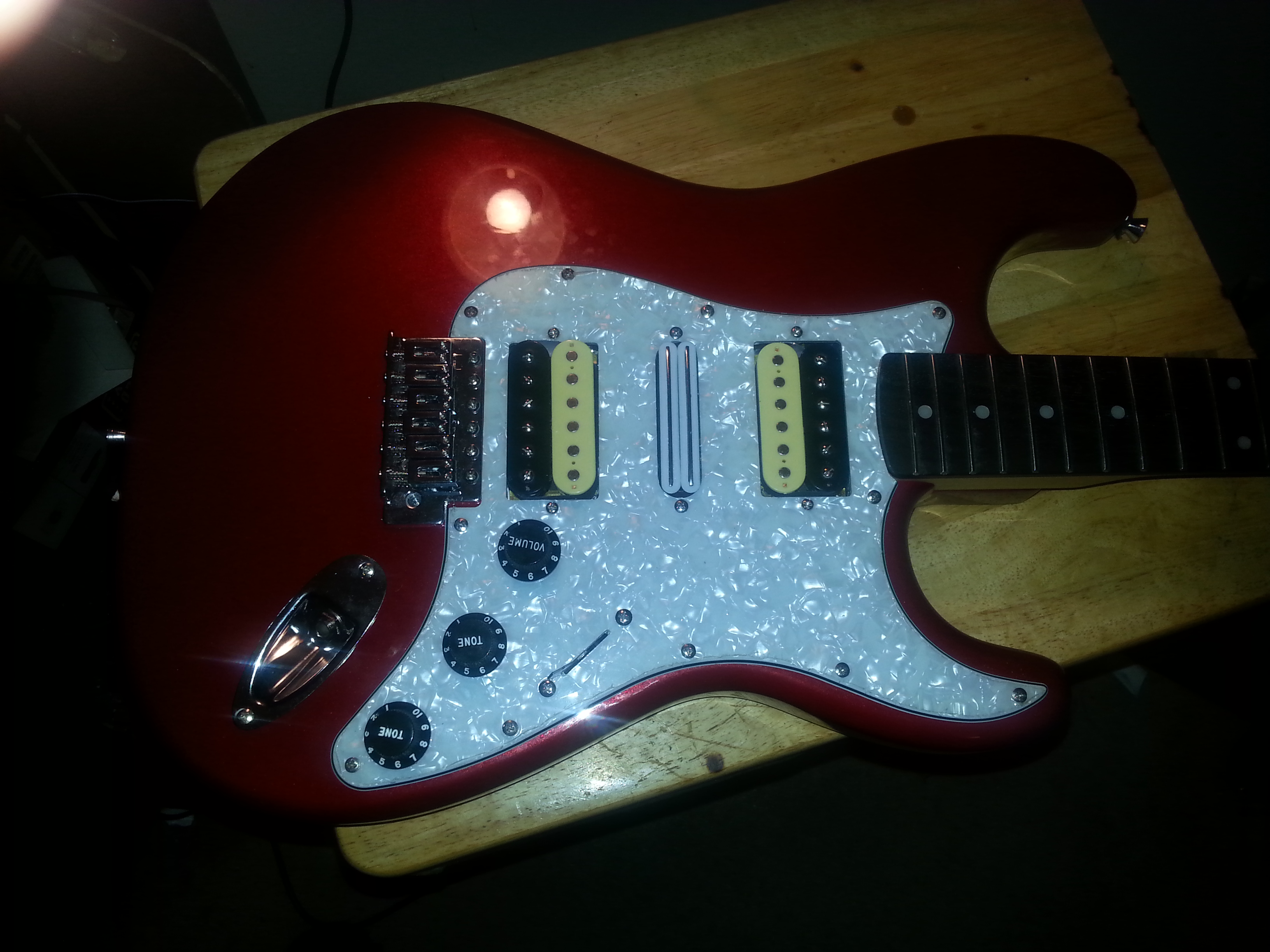

Here are some picks of the build progress.

I wouldn't worry about the buzz at this point, as your body is acting as an antenna for any EM energy nearby. You won't be touching the pickups when you play, and the strings should be grounded. You should shield the control and pickup cavities with foil if not already done.
You might as well string it up. You should be able to get the pickguard and attached electronics off of the guitar if you have to make changes, by slacking the strings, or in the worst case by removing them from the tuners. The hard part about putting used strings back on a strat is getting the curly-Q tuner ends back through the bridge.
