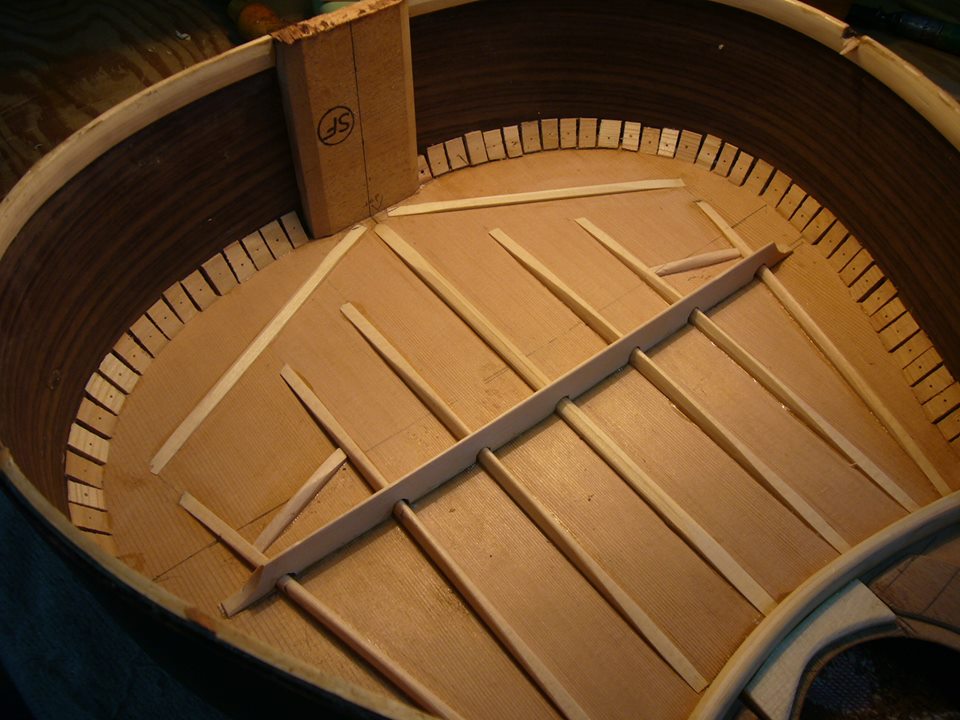

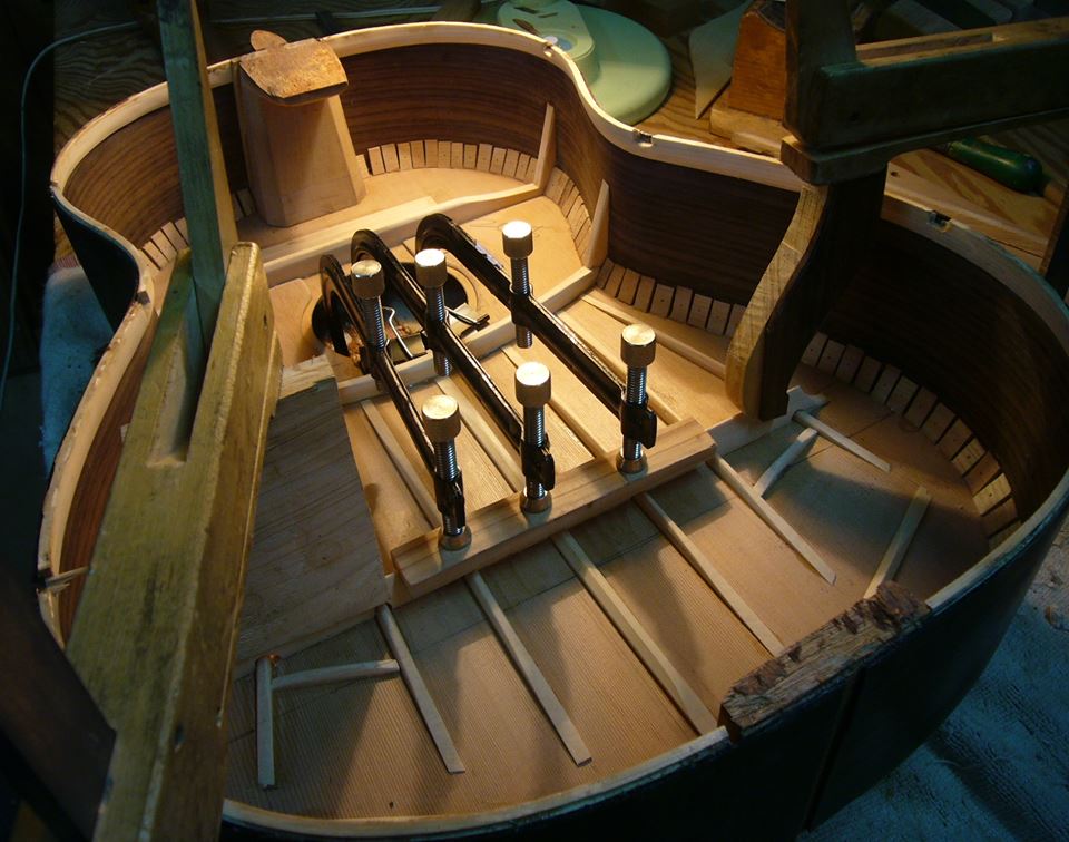

One of the reasons I got interested in Bouchet is that I have a guitar I made 6 or 8 weeks ago that did not have the cross grain stiffness I anticipated. The guitar sounds wonderful, but has a slack feeling ....I think it can give more.
I began to think about doing a Bouchet bar in it for kicks to see what would happen, I had time to take the back off a fit a Bouchet bar. The guitar is a rosewood flamenco guitar with a cedar top. A deep-ish body for a flamenco and the scale os 660. It has nice qualities, good clear trebles ad nice feel under the head, but a more cross grain floppiness than I care for. That makes a flamenco guitar lose something.
It may no longer be flamenco sounding of feeling after tighening the cross grain so much, but I'm not stuck on this for this one. the bar did not add much weight, it dials in at 10 grams, well that is a lot, but it gave a lot of stiffness.
I decided to try it on this guitar and If I sense it might be a way to go I'll build a Bouchet copy with the five fans and cross bar. It seems like an old esoteric idea today but I've noticed some interest in Bouchet's ideas lately by other makers. I'm just looking at it as a learning experience, I've never worked with that idea.

Here it is! In all its extemporaneous glory. This guitar was built for myself to play, so rebuilding it until I get a lesson out of it makes sense.

Good stuff. We haven't seen this kind of thing around here for a bit.
So, were there any other incremental through-the-soundhole mods you did before yanking the back? Like, were those wee cutoffs between 1-2 and 6-7 added after the box was closed?
In the bigger scheme of adding cross-grain stiffness, what's the big difference between the single, tall Bouchet bar and a flat patch under the bridge? I bet you could even make them the same weight. Now 5 fans plus the Bouchet, on the other hand, would be lighter, for sure.
