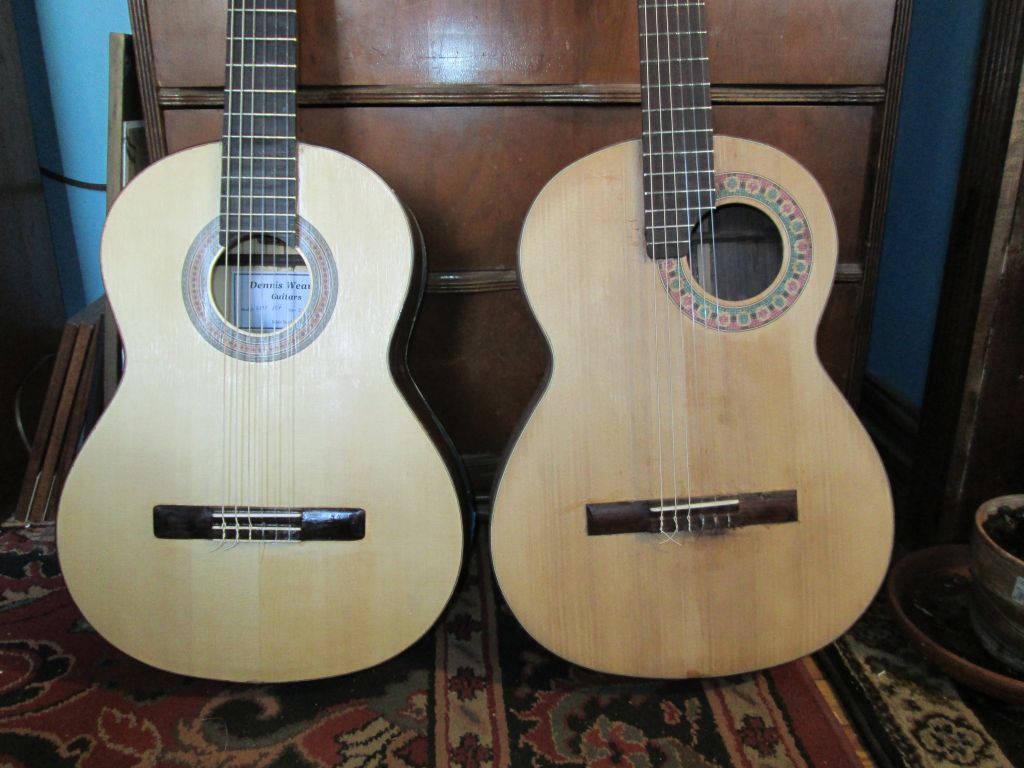

It has been a winter of heat gunning off, necks, fingerboards, bridges, tops, and backs.
Built two guitars, Guitar Six in Fall and Guitar 7 with reverse fan bracing and Kasha placed soundhole.
Guitar Seven first- It's fit for firewood or more experiments. Over braced with a stiff top. and bridge needs to be moved outward as 20 cents sharp all over (and at 12th fret)
Guitar Six- DEAD ON spot on in tune all over every fret no buzzing clear sounding guitar but not too loud or bassy. So.... I cut the back off it and sanded a lot off the fan braces and put a Alaskan Yellow Cedar back on it vs. Indian Rosewood, (wanted to try that for resonance plus a price thing as well.)
I put a board clamped to fingerboard and bridge to hold that straight while gluing on new back. Anyhow still in tune and the action is the best action on a classical I ever played. plays like an electric guitar!
Here is for the scientists out there. covered strings with hand and bang the top the note of the top is B plus 20 cents. Bang on the back the note is the same B plus 20 cents.
OK Now put my body up against the back to stop it from vibrating and banged the top- different notes you can get. Same results to the back when you hold your body against the top and bang the back.
But B when bang either with guitar free.
Other things I read Jeffrey Elliot article in GAL big Red Book 5 and he is probably right about harmonic bars and sound hole placement.
To move the sound hole upward to increase "vibrating wood near bridge" didn't do anything for me but bad. (Oh the 6th guitar has the sound hole at the 17th fret instead of the 19th) The side sound "port" seemed to be a great improvement. It is mostly for the player. But 99% of the time it is me in my chair playing for myself anyway!
The 6th guitar has been fooled with because I accidentally domed the top at the bridge 1/8" higher, So... I epoxy heightened the fingerboard to get that corrected. (In Fall)
The reason I just tore off the back and put a new back on 6 was I am doing all this to wind up with a fairly good/ great guitar not a "OK" one. I could buy an "OK" one from the store.
Well I need to lighten up on braces. Although not ultra light because I am a chord (jazz) player. I will put the sound hole back at the 19th fret on my future guitars. I will master knowing what I am doing with fingerboard/ neck angle bridge height / string action.
I am in a learning period of mixed lucks and mistakes.
OH, what do any experts think about that "B" note resonance?

Assuming that picture is of #6 and #7, which is which?

Alan Carruth wrote:Assuming that picture is of #6 and #7, which is which?
#7 on the right, I guess.Dennis Weaver wrote:Guitar 7 with reverse fan bracing and Kasha placed soundhole.

Thanks for pointing out the soundhole thing, Trevor: I should have figured that out. Schneider used to put the hole up in the bass side corner, and maybe that's what threw me off. The hole on #6 is placed pretty high as well. If you look at William Allen's article on air modes in American Lutherie #1, or the first 'Big Red Book' from the GAL, you'll see that that would tend to drop the air mode pitch. It won't be as much as moving it up into the corner would do, of course, but I've found it to be more effective than you might think.
As for the top and back having nearly the same tap tone when coupled, and different when one is damped: this is related to Trevor's answer about intonation. When the two plates are 'free' they couple strongly, and can shift each other's pitches. Damping one allows the other to vibrate more or less at it's own pitch, except, of course, for all the other things it's coupled with that alter it. It's a bit unusual for them to end up on nearly the same pitch when they're coupled, and that suggests to me that there's something else in that range as well. This can get tricky to track down, as nothing will 'hold still' when you change something else. And all of that assumes that what you're hearing as the top and back tap tones are really that: usually the 'main air' mode masks those pretty effectively, and you can't hear the 'wood' tones without blocking the sound hole (which, of course, alters the way they couple...).
