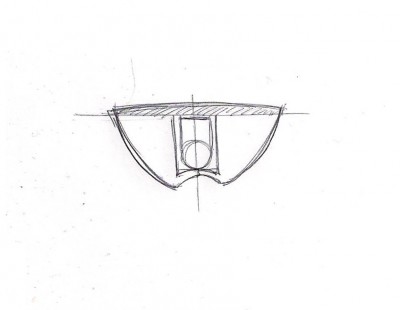

well, this is the case, I was refretting my "velvet" guitar as a customer purchased it but wanted bigger frets, it also need to be re-laquered.
my saw is a bit off I suspect, it's the frets slots are too thin for the fret to go in easily and it gives a bit of fight before getting hammered in, I need a better hammer too, I'm using some sort of steel hammer like the next picture.
and of course my technique might be a bit off.
now, cutting to the chase, I wanted to press the frets in...
so I decided to use an oak radius block and clamp it hard to the neck.... (there was a wood block between the neck and the clamps)

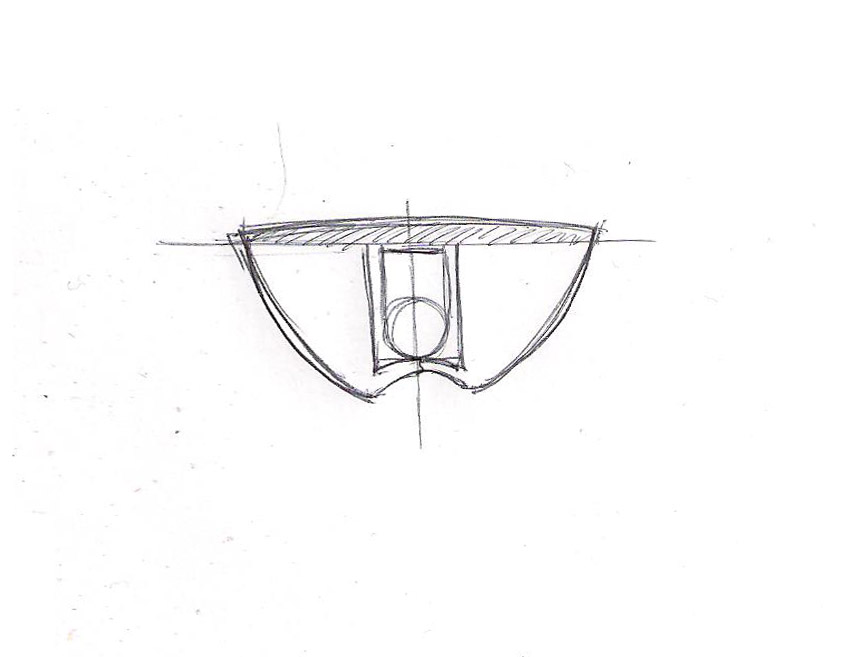

and I sorta, uhm, compressed the wood around the 3rd fret, leaving a little groove in the neck..., you know, the weak area just below the truss rod channel
- first attachement is an explanatory drawing, possible can't be seen at bare eye, but it certainly can be feeled with touch, the drawing its a bit exaggerated, it's more like a "flat" area.

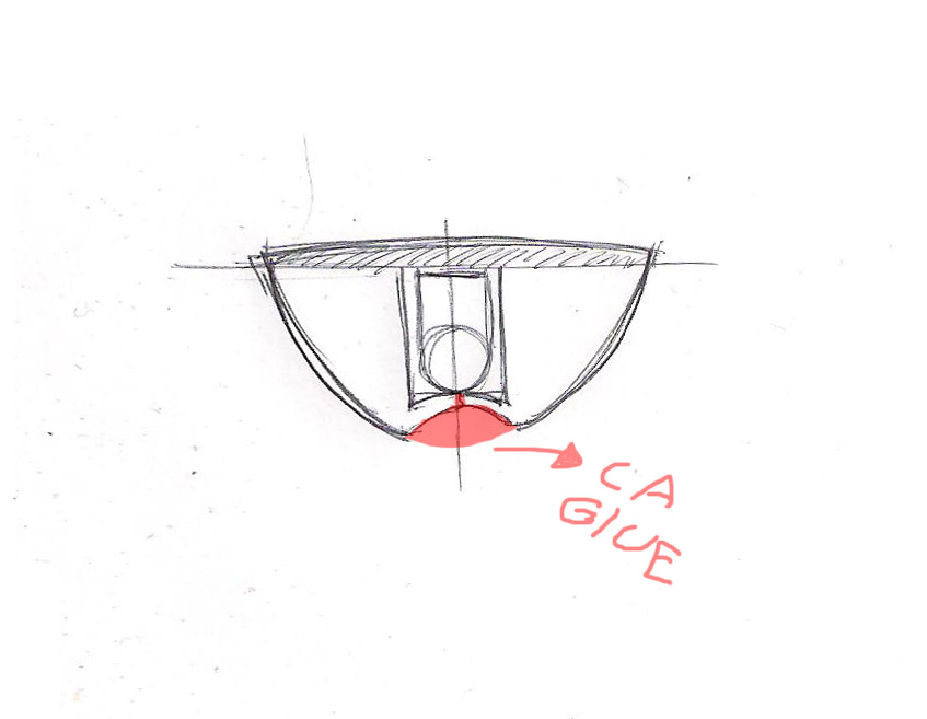

by CA parchment I mean just a drop of CA glue, then wait it to cure and start building up the layers of CA glue until the small groove is filled, I've seen this technique for filling laquer divots (if that's the right word for it.) the point is to get a great amout of CA layers until it overboard the groove and the sand to level everything.
I think I could use wood sealer for this, but CA glue dry more quickly.

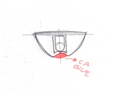

I'm currently getting the CA glue on the small grove (it's 0.5mm in depth and 1cm in length, quite shallow) teh CA needs a lot of curing time but so far I think I can get the outcome I wanted, tomorrow I'll check how the CA is building up.

Hi guys, back now with some pictures this time!
I had to use some time making the CA glue to build up in order to be sanded down evenly with the neck surface, I think I did a fine job making this technique work, with the sealer on the surface the feel is almost perfect, I can baaarely feel the difference, will see if with the laquer it gets even less noticeable by the fretting hand.
now, the client probably won't notice the difference at all, its the sort of fixes that only you know it's there.
oh, and visually you can barely see a darker patch, which is the CA, but I will need to see if the laquer will hide the patch even further. (the patch was a little more extense than I thought, but still it isn't that deep)
it's hard to see in the picture, but it's a bit more evident in real life.
