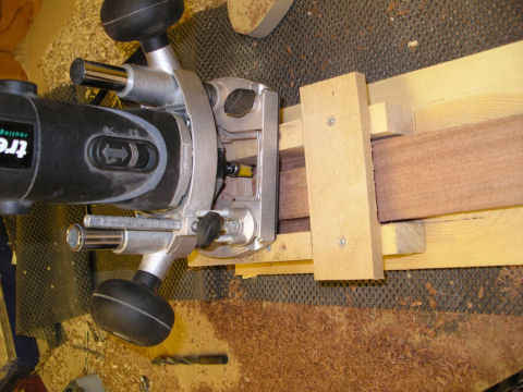

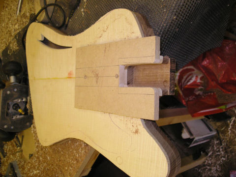

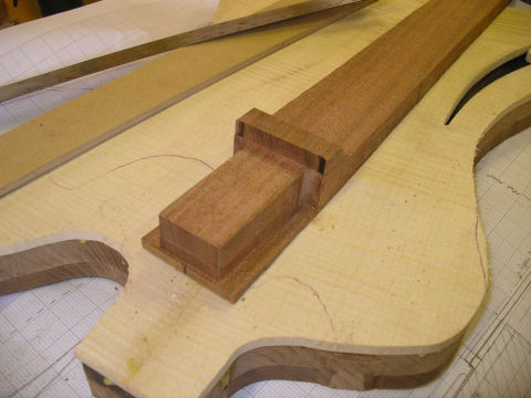

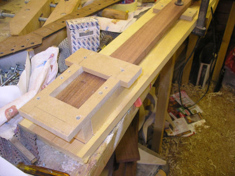

Don't cut the joint the depth of the neck blank, I make a box around the neck blank and then wedge the neck to the correct angle and route the joint as in the picture. Otherwise if you cut the joint the full depth of the neck blank you'll have to put a kind of "horse shoe" wedge in place, I'd doubt whether you'd notice it but it's kinda a "get around to doing it properly.

what I have understand, the body surface that "joints" the neck to the body is actually angled just as the neck pocket, so when you glue, you shouldn't have any extra space need for filling.
so in a way, it isn't an exactly flat top body.
other option is to make what´s done in some acoustic guitars I have seen, to have a little wedge glued that fills that space.

Sorry to be a couple of days in replying...... I made a crude jig a kind of box around the end of the neck blank at one end of a flat piece of wood...I set the neck angle by placing a scrap piece of wood under the headstock end of the neck and clamp the neck, the top of the box I run a bearing guided router around the box, pressing the cutter to the sides of the box, and cut the tenon. I stop the cut before reaching the full neck depth and hence leave a square wedge shaped horse shoe around the top of the neck... I certainly don't think that it's the best way if anyone has any better ideas for jigs please post!
