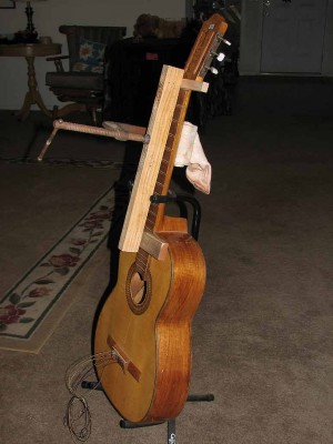

If you have too much relief/forward bow in the neck, I've corrected this (in a classical/no truss rod guitar) by clamping the neck in slight back bow and heating the neck and fretboard for about a half hour with a hair dryer, then letting it cool while clamped overnight. Two years later the neck is still straight.
But might not work for higher tension steel strings.
